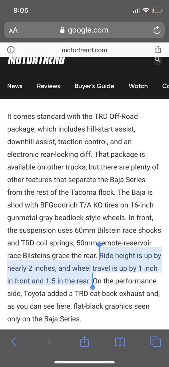

    Your highlighted portion is in regards to articulation. It allows for more suspension travel. The Baja has 1.75” of extra height up front and nothing extra in the rear. The rear has the 3 leaf + overload.

    So it would be 2.75” total in the front and stock off road would be 1” in the front?

    What are you asking about in particular, ride height or travel? That article is explaining that the Baja has an additional 1” of travel for the front and an additional 1.5” of travel for the rear. If you’re asking about ride height, the Baja is 1.75” higher in the front over the off-road, sport and SR5 models

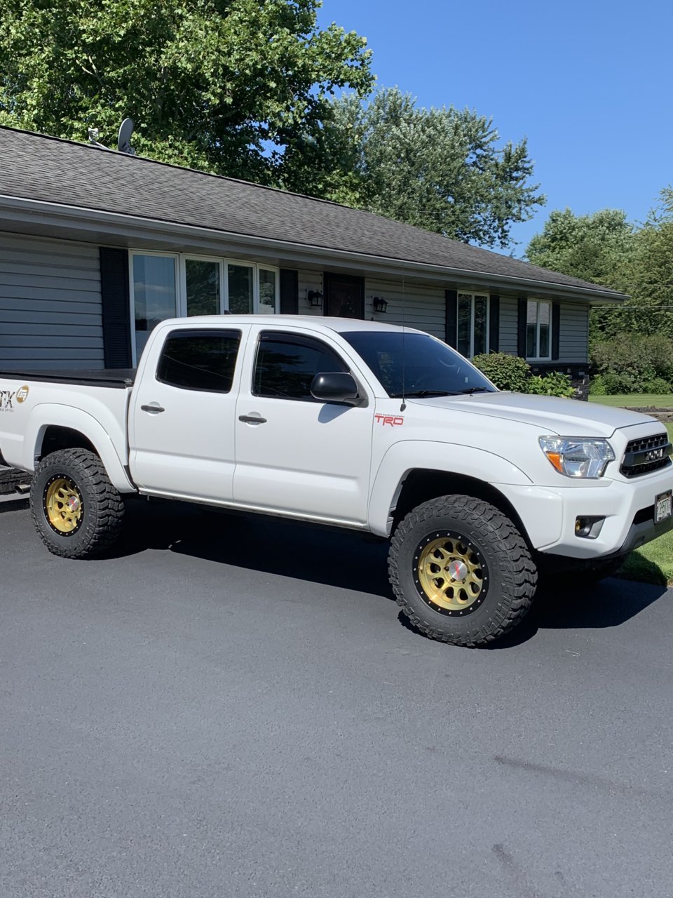

    Here is what I’d do......I ran this set up for quite some time and loved it, as well as others on here.
    For the rear, buy an “progressive add a leaf” from wheelers or icon. That will get you 1.5” added to the rear. It’s like a small leaf pack that gets added to the existing spring pack....
    For the front, you can either add a 1/4” top plate spacer to your coil overs (this will raise you an additional 1/2”. So you’ll be at 2.25” total and your truck will have a very slight rake.
    Or....you can do a 1/2” top plate spacer (this will require extended hardware for the top of the coil overs (no biggy). This will give you just under a inch so you’ll be at 2.5”ish in front and no rake ......providing you did the progressive add a leaf in back.

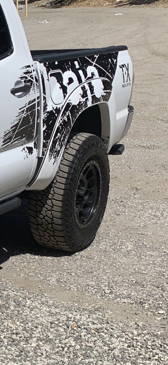

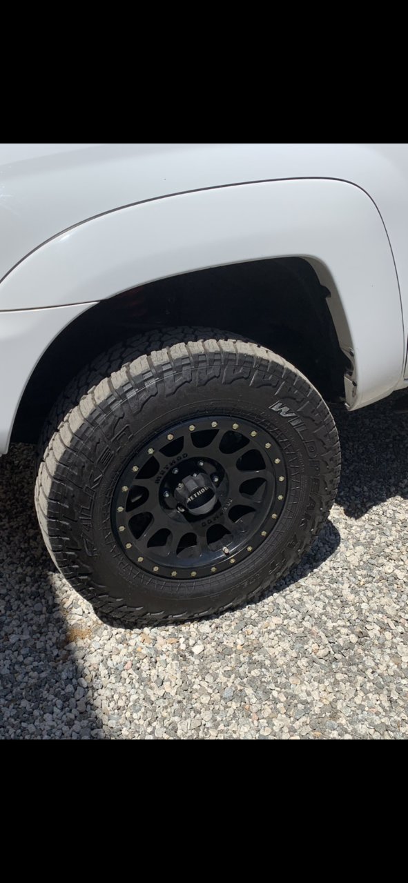

    @Dansly56 ost a pic of your rims......I’ll try and look up the offset and backspace.

    I’ll take more tomorrow

    Just looking at the pic, they look like they poke out past the fender a little.......if the do, I’m sure 285’s will fit.

    Oh, I never noticed that! They sure do stick out some.

    I’m pretty confident you will be able to get your 285’s on. You may have to do some very minor trimming to the black plastic in the front of the wheel well.....it’s minor, very minor. With 285’s, I’d definitely would lift it a little so it looks better with the bigger tire. I’ll send you the links
