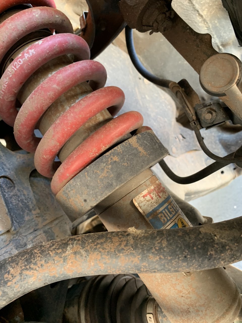

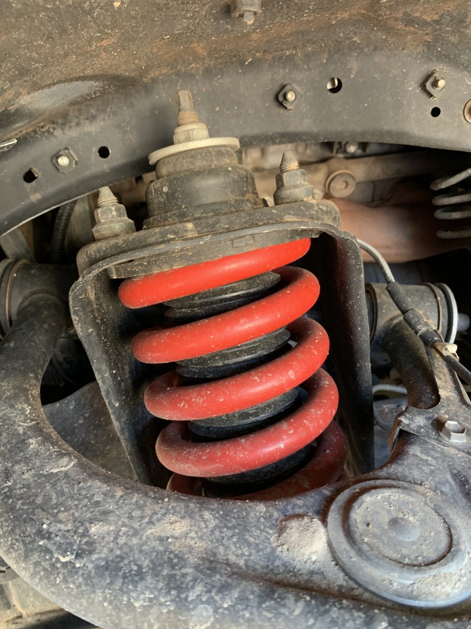

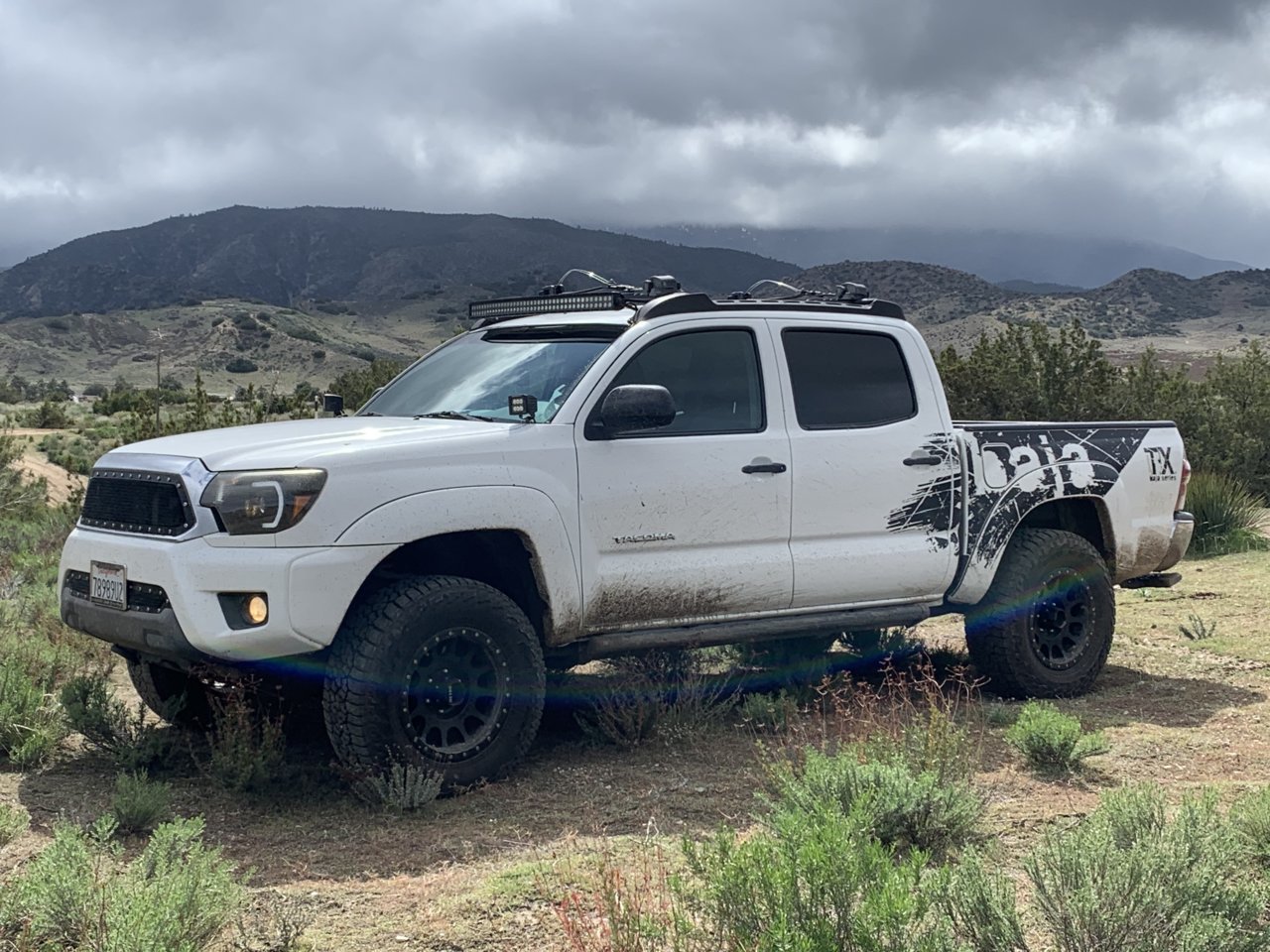

    Come to find out my truck does already have 1in toytec spacer in the front and now I just have to add the progressive leaf
    hack4875, RyanL and Island Cruiser like this.
  12. May 3, 2020 at 1:19 AM
    #7472
    Island Cruiser
    Island Cruiser TVita
    May 20, 2012
    #79166
    3,937
    Kauai
    Baja
    Post some pics man!

    Why is the spacer on the bottom and not the top? Aren’t some spacers on the top?

    I used a regular top plate spacer that will work on any coil over. It is installed on the top. Toytec makes a Baja/Pro specific spring seat spacer that is swapped out with the oem spring seat. This is installed at the bottom and provides 1” of lift.

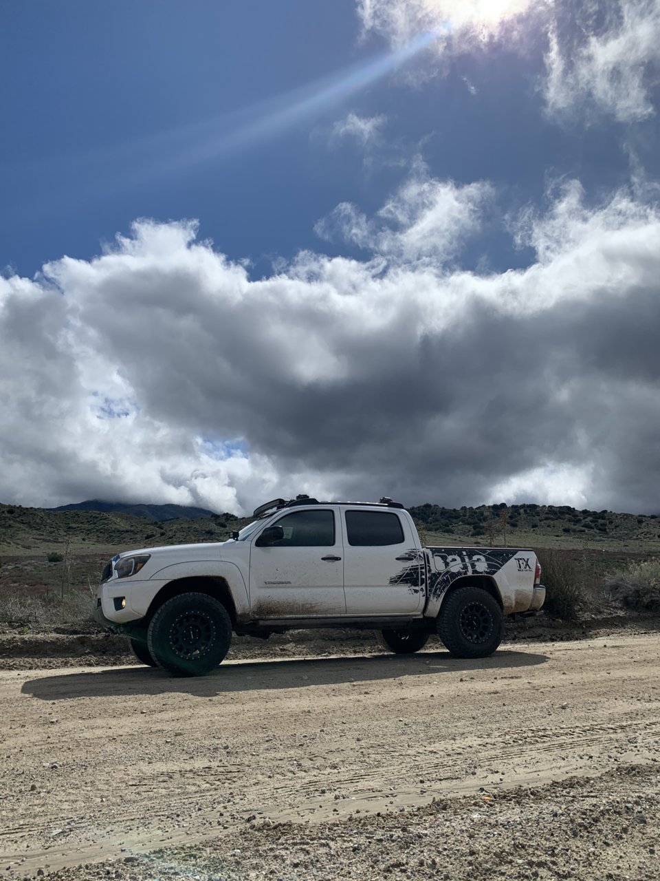

    Does it look like they added a smaller spacer on the top as well as the bottom?
  18. May 3, 2020 at 12:00 PM
    #7478
    Island Cruiser
    May 20, 2012
    #79166
    3,937
    Kauai
    Baja
    Nice, man. I actually meant pics of your truck though haha
    Dansly56[QUOTED] likes this.
  19. May 3, 2020 at 12:01 PM
    #7479
    Island Cruiser
    May 20, 2012
    #79166
    3,937
    Kauai
    Baja
    It doesn’t look like there are spacers on the top
