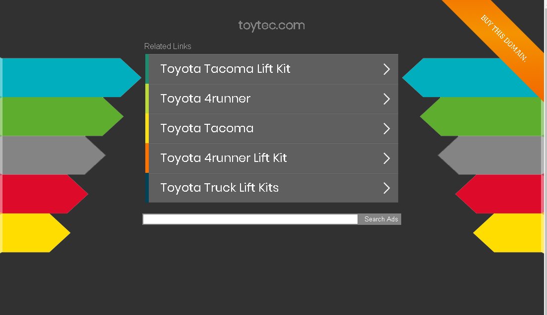

    Go to toytec.com they have everything you’ll need.

    Is this web site? It doesn't look correct.

    Whoops.....

    Perfect, looking at it now.

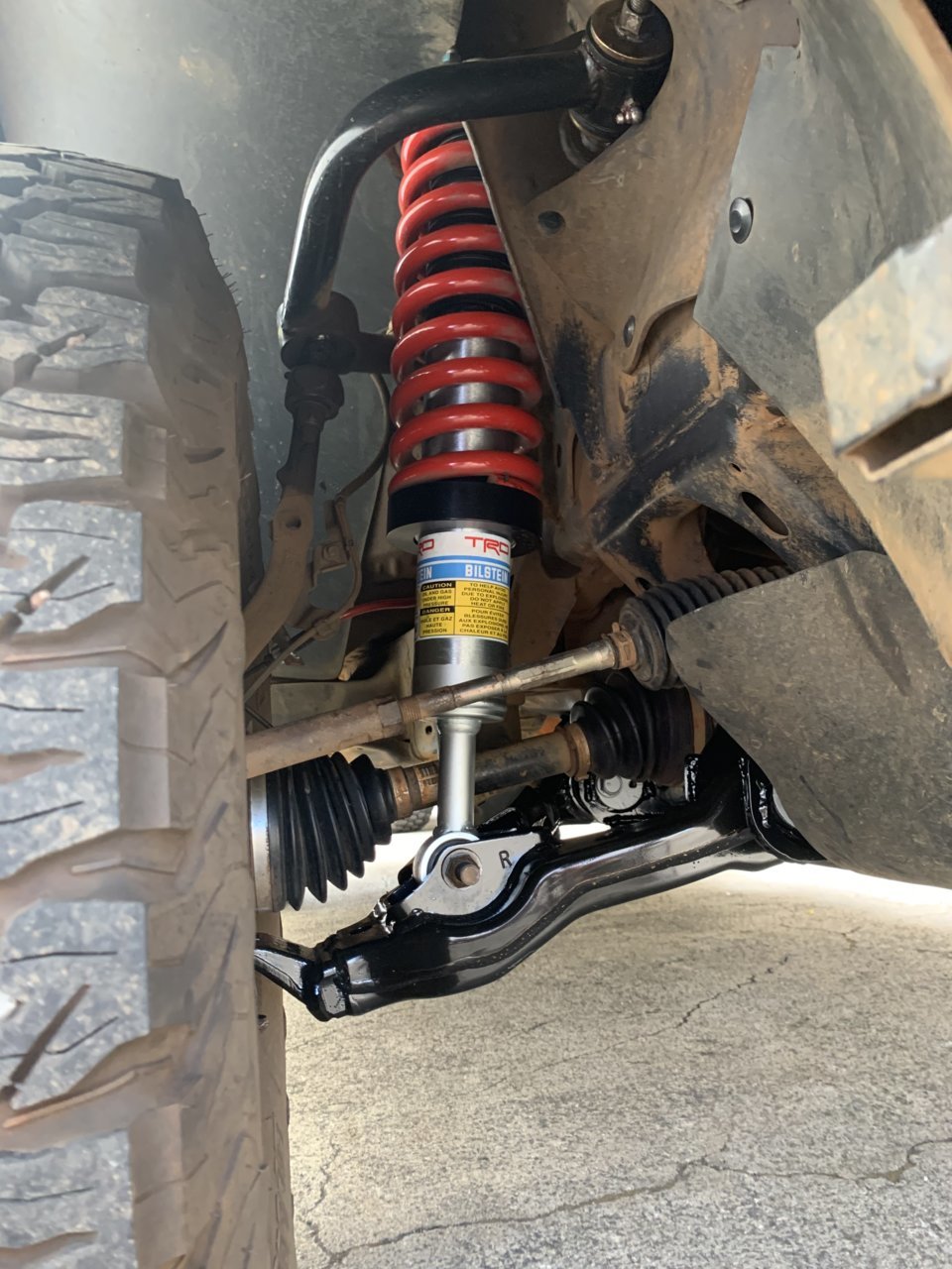

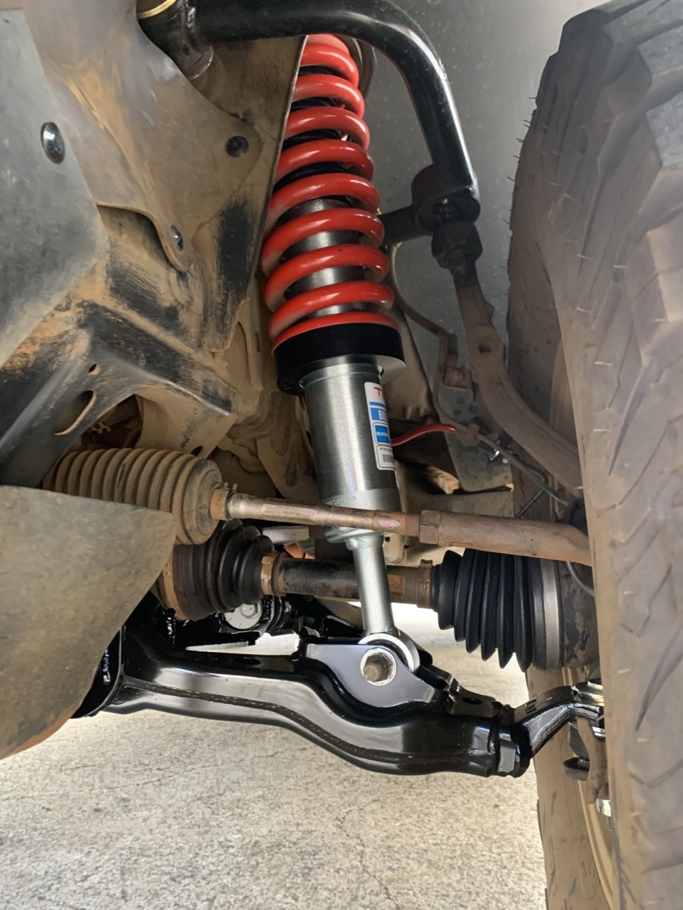

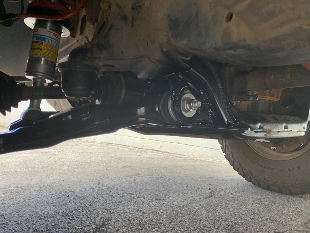

    Had the 1” Toytec Spring Seat Spacer put on, new OEM LCA’s with cam bolts, Marlin Crawler LCA braces welded, Wheeler’s brake lines up front, brake fluid and power steering flushed, bearings/hubs replaced. Then the rain poured non-stop on the drive home so these are the only pics from when I picked it up from the shop:

    Nice. Why new oem lca’s? What did you have before
  16. May 26, 2020 at 7:52 PM
    #7556
    Island Cruiser
    Island Cruiser TVita
    May 20, 2012
    #79166
    3,937
    Kauai
    Baja
    OEM. My passenger cam bolts were seized which didn’t hold alignment, then the genius that I am still went playing on dirt and kinda muddy fields which bent my cam tabs. The mechanic that does my alignments noticed my LCA bushing was starting to go too, and I think the wobbly movement wore out that bearing quicker so I just had both sides replaced. My ignorance for the past few months made one thing leading to another lol
