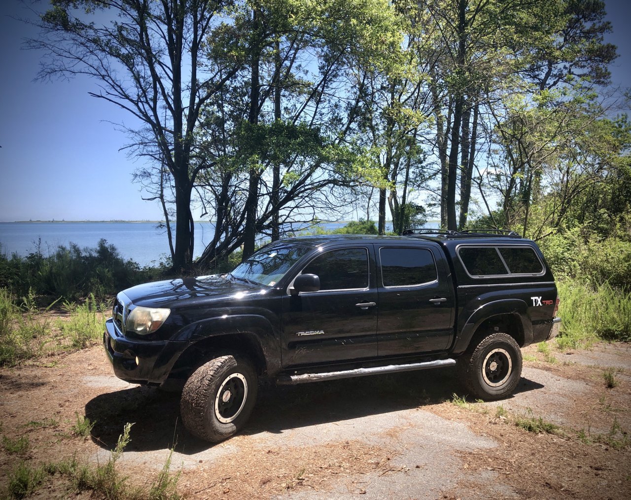

    Nice looking truck! Welcome to the thread! :thumbsup:

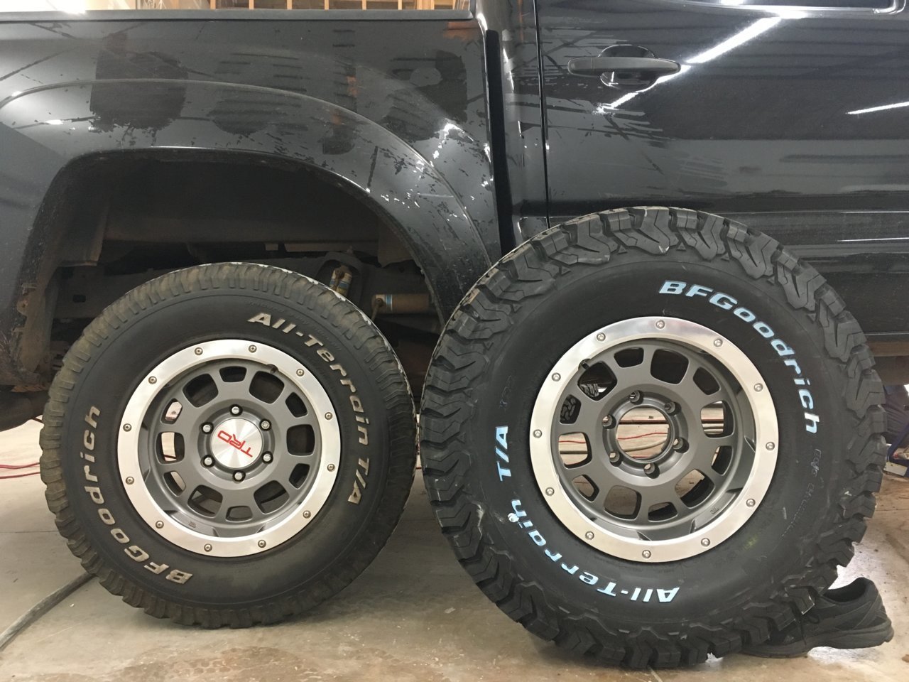

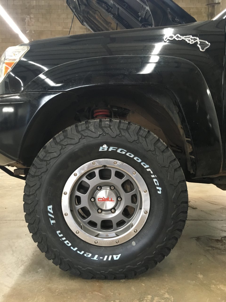

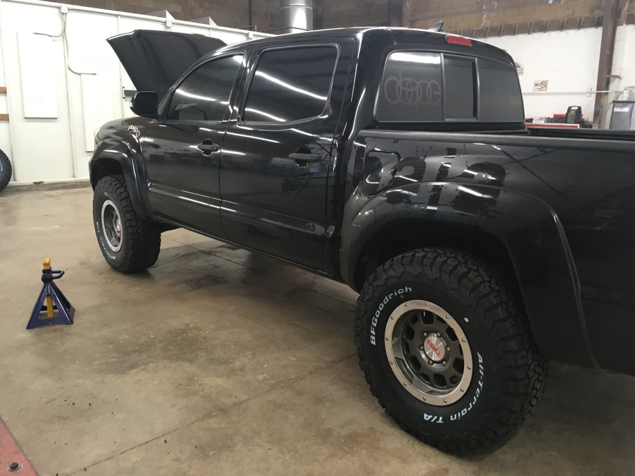

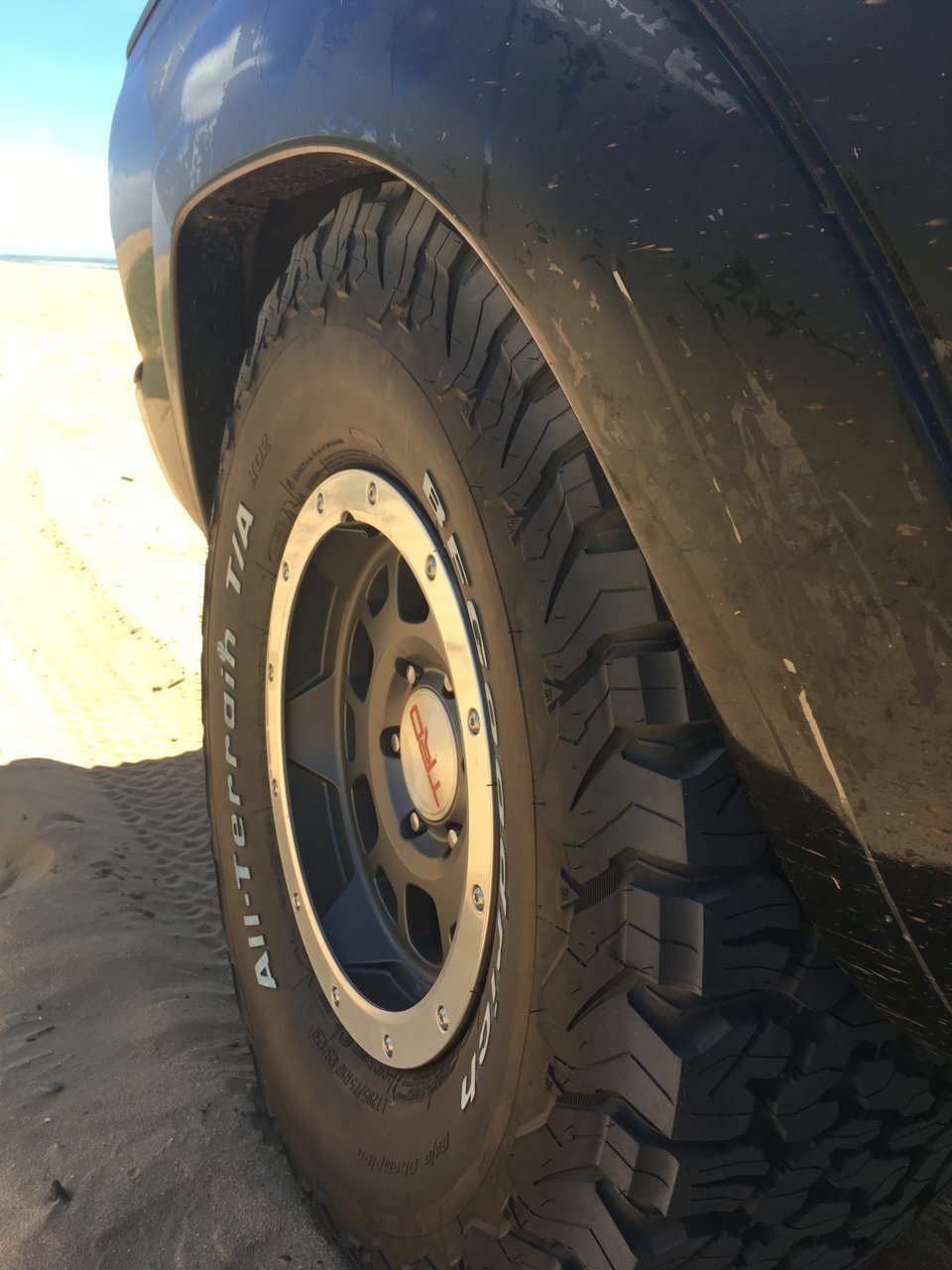

    Yup! Ran 295’s when I had the stock Baja suspension and wheels

    You managed to run these without rubbing, on stock suspension/wheels? no CMC or spacers or anything?

    Sorry I missed that part. Had the CMC, pinch weld flattened and trimmed the bottom corners of the flares. Sliiightly grazed the UCA when reversing at full lock on dips. No spacers at all, I was hella stoked!

    ah okay that makes more sense. not bad though...might have to look into this soon after my new suspension gets thrown on

    The thing is I didn’t even feel the grazing on the UCA. I only noticed it when I went to wash the truck, just a dark spot as it rubs the dirt off lol.
    The rears could stuff under compression lol

    That looks so good. Throw on those 295s @GrubesBaja!
