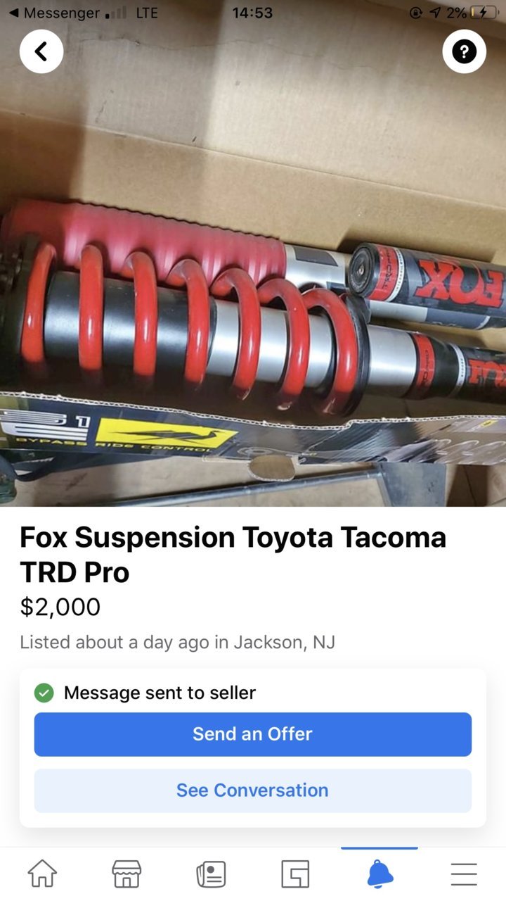

    I’m not sure how to tag everyone but I appreciate the input. There’s a guy near me selling a 2020 PRO suspension set up brand new. He just put old man set up on. It comes with front and back plus leaf springs. Thing is it’s 2,000$ for all of it. 1. Will it put me at the same height I am now? And 2. For 2,000$ is it worth it?

    So a bunch of people have bought The Pro and then turned around and sold the suspension off it. I’ve seen people sell the whole set up for upwards around 2400-2500, minus the leafs. So for 2k comparing it to that, it’s worth it. However, for just a little more you can buy something new and adjustable. For me it was plenty worth it. I did not pay that amount for my 3rd gen pro setup, I paid much less. I just got very lucky I guess. I also did not care about the adjustability. I do love how it rides and handles And I’m very happy with it.
    I put 1/2” top plates on top of my front coilovers with extended hardware. This lifted my front end about an inch. For the rear, I had a progressive Icon AAL Along with my oem leafs and that lifted my back end about 1&1/2”. I’ve since replaced my whole spring set up with an Icon RXT spring pack set at option 1 and that’s given me the same lift. Next for me will be the archive garage hammer hangers shackle kit.
    Seeing that he’s accepting offers.......I’d throw him an offer of 1600 and see what happens.
    Like @doorsidedown stated, you just got to be honest with yourself in what you want. If all you want is a simple lifted suspension, that can be accomplished without spending a ton of cash.
