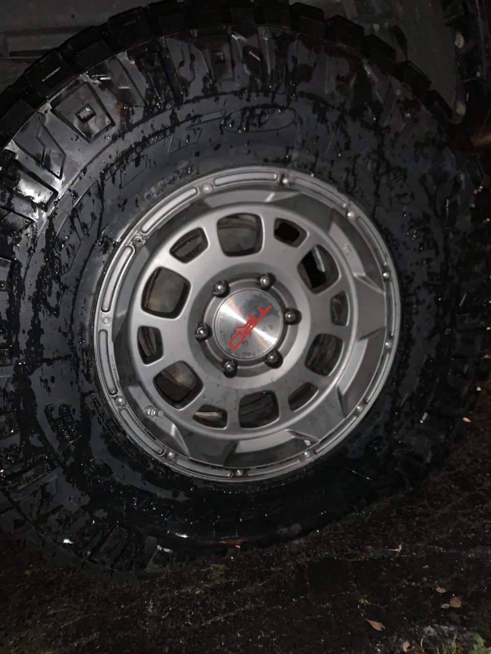

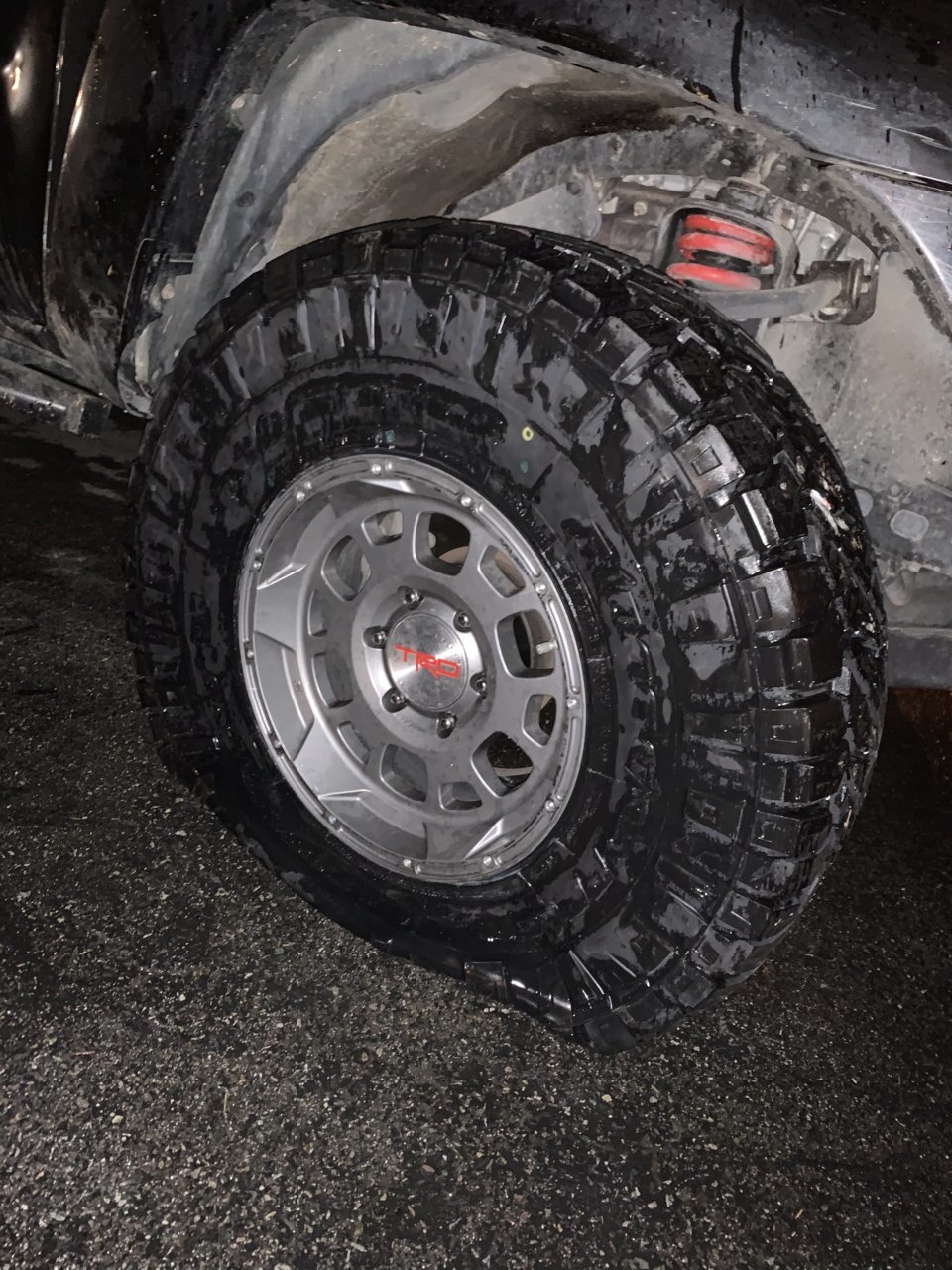

    usually caused by not fully torquing the TPMS sensor when replacing service pack
    driving on very low psi supposedly compromises sidewall integrity

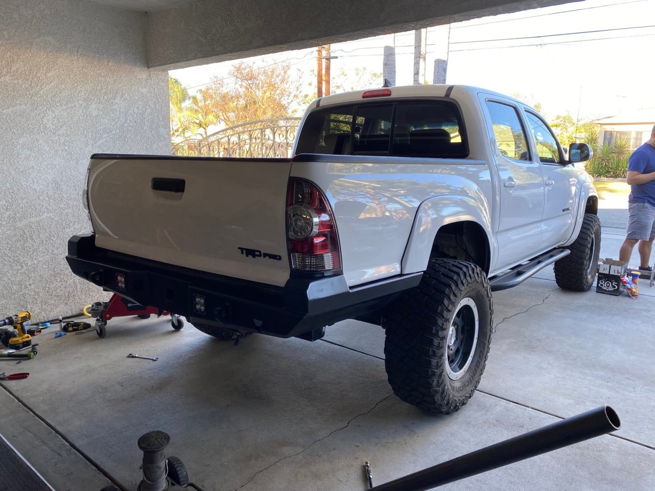

    Time to get the switch pro wired up

    shesh that looks clean. I'd like to get rid of my ugly chrome rear bumper but... :spending:

    Thank you! My buddy has a white tacoma with chrome rear, and came to pickup the bumper quick! lol

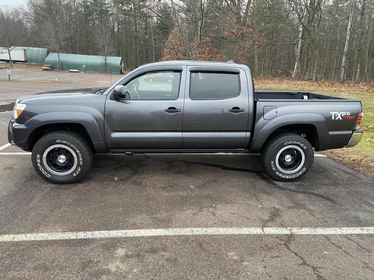

    Congrats on the upgrade! Nice TX.

    Nice. I’d love to get rid of my current 4xinnovations plate bumper and do a high clearance one just like this. I totally don’t need it, I just love the look.

    yea it definitely made me stop what I was doing!
    Thanks I’m enjoying it so far.
    Pretty hi tech compared to what I had.

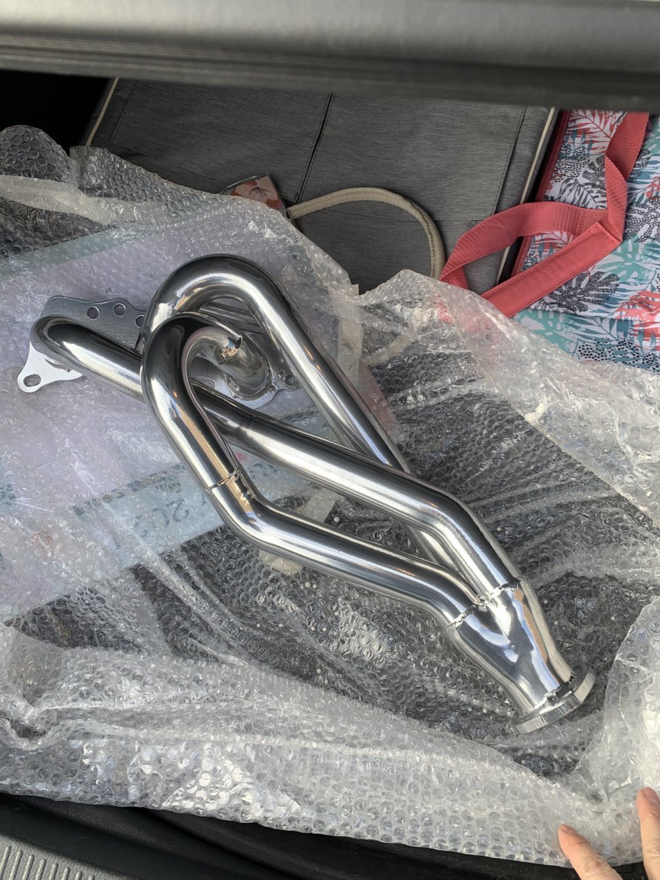

    So stoked !!!! And this makes me want to put them on sooner. :cool: Just pick up back from the coater. I had the coat they came with stripped. Then I had them receramic coated in silver.

    Wow that’s some gorgeous craftsmanship right there. You’re gonna have a totally different truck when you get all your stuff on!
