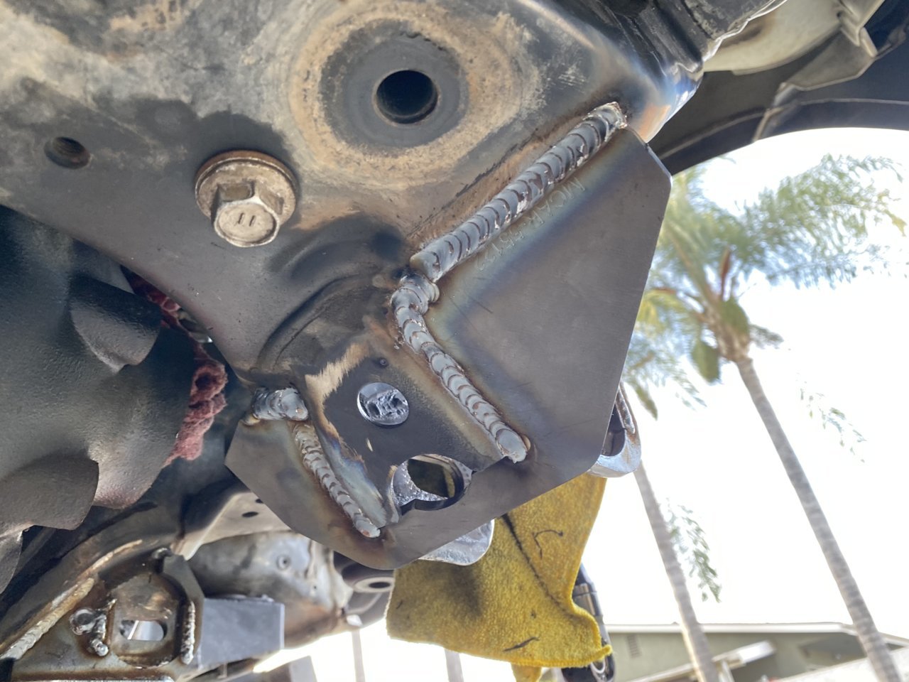

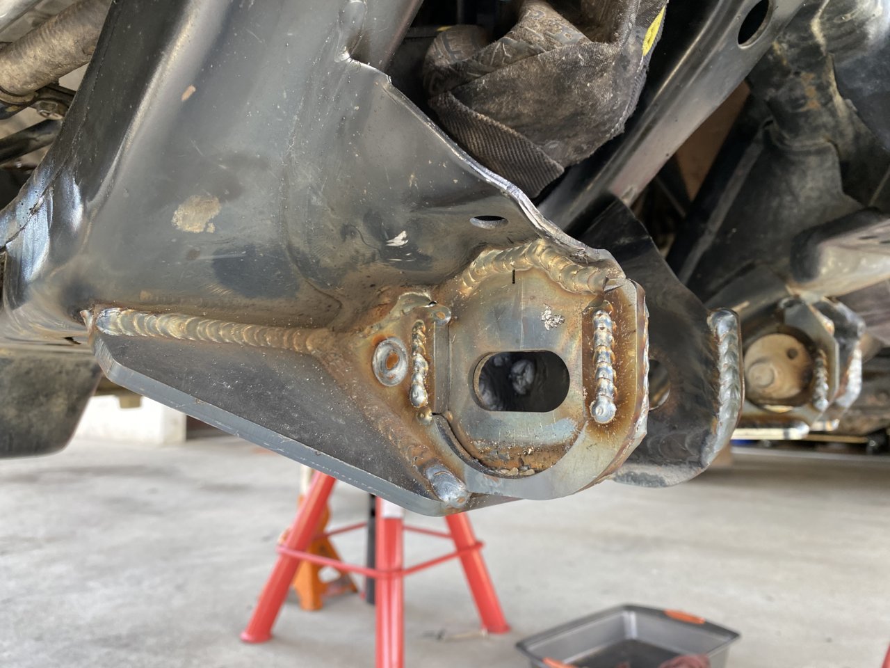

    Maintenance time! Anything rubber will be new and adding lca, cam tab, spindle gussets.

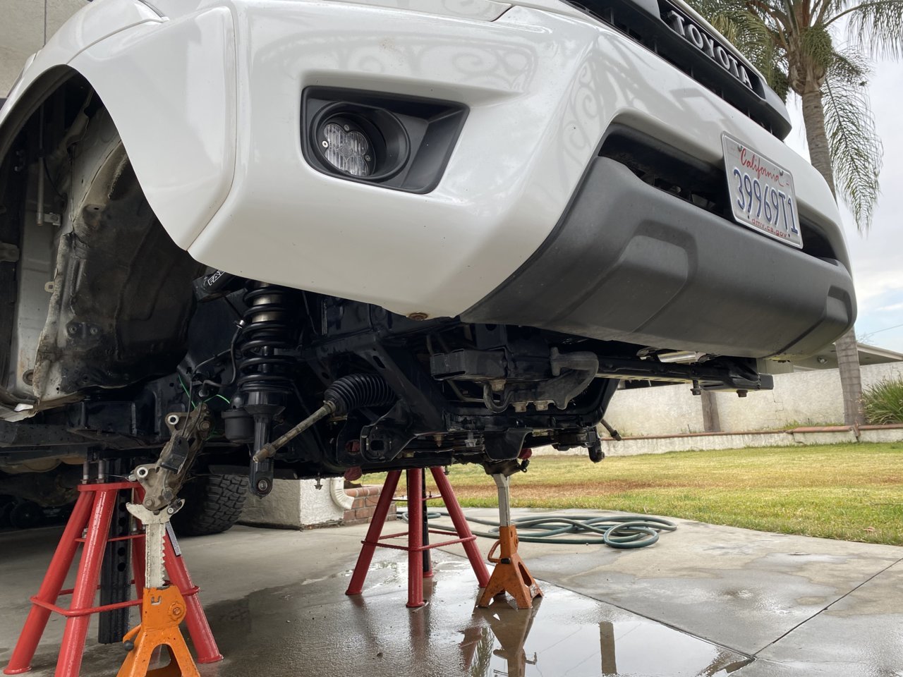

    How many miles you got on? Also those are some beefy looking 'jack stands' holding the truck up haha. You make those?

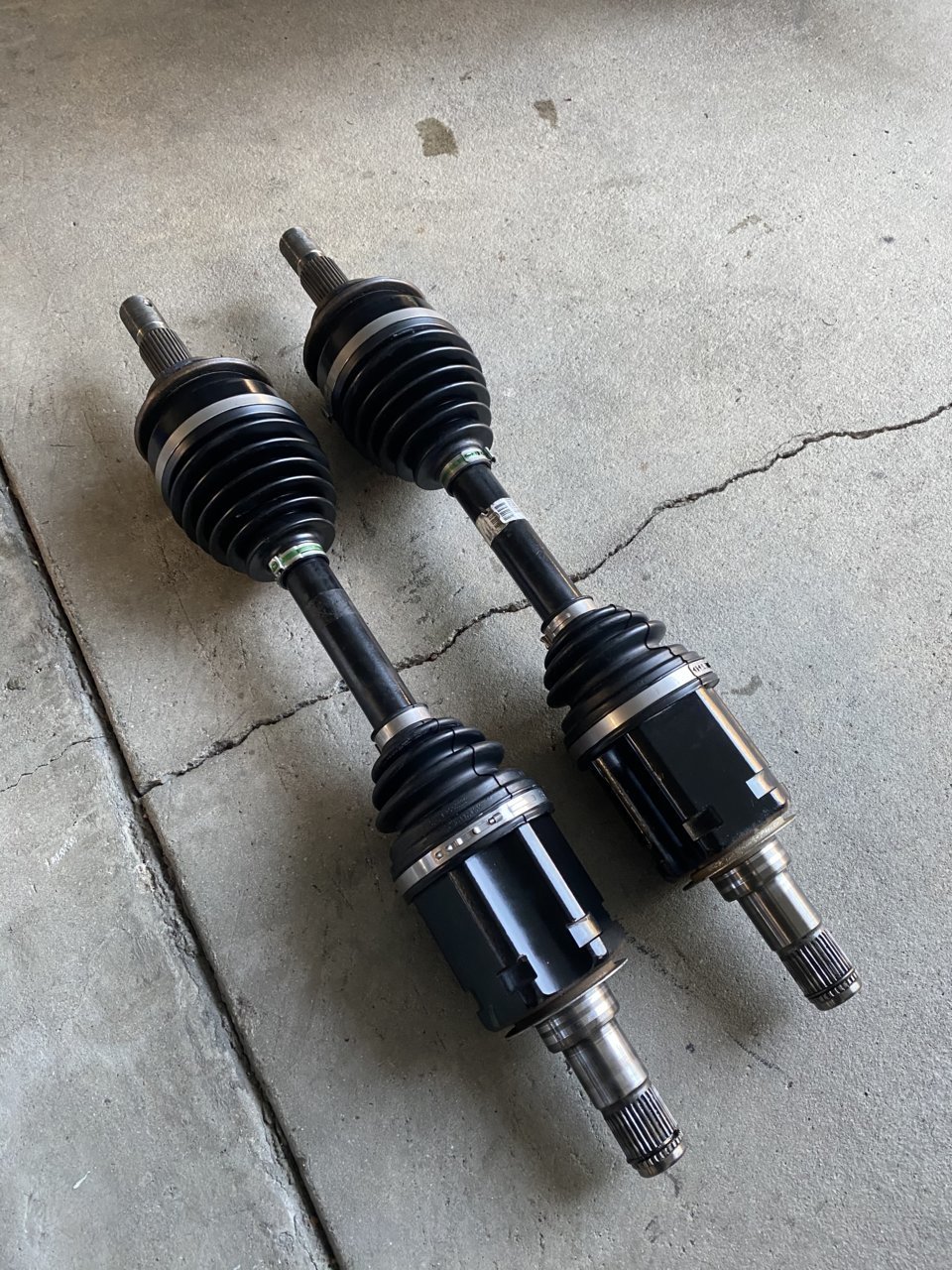

    She's got a hefty 100K on the odometer. I'm trying to get all the wearable components replaced at once, while it is torn apart for the gussets. I rebuilt the axles yesterday and pressed out the lca bushings from the arms. Whiteline lca and steering rack bushings will be installed along with new oem inner/outer tie rods. The jackstands were actually purchased off Amazon lol, and they are set at the lowest setting in the picture.
    Here's the link: https://www.amazon.com/dp/B0093NBQNA/ref=twister_B07TM7B789?_encoding=UTF8&psc=1
    Axles rebuilt with oem boot kits

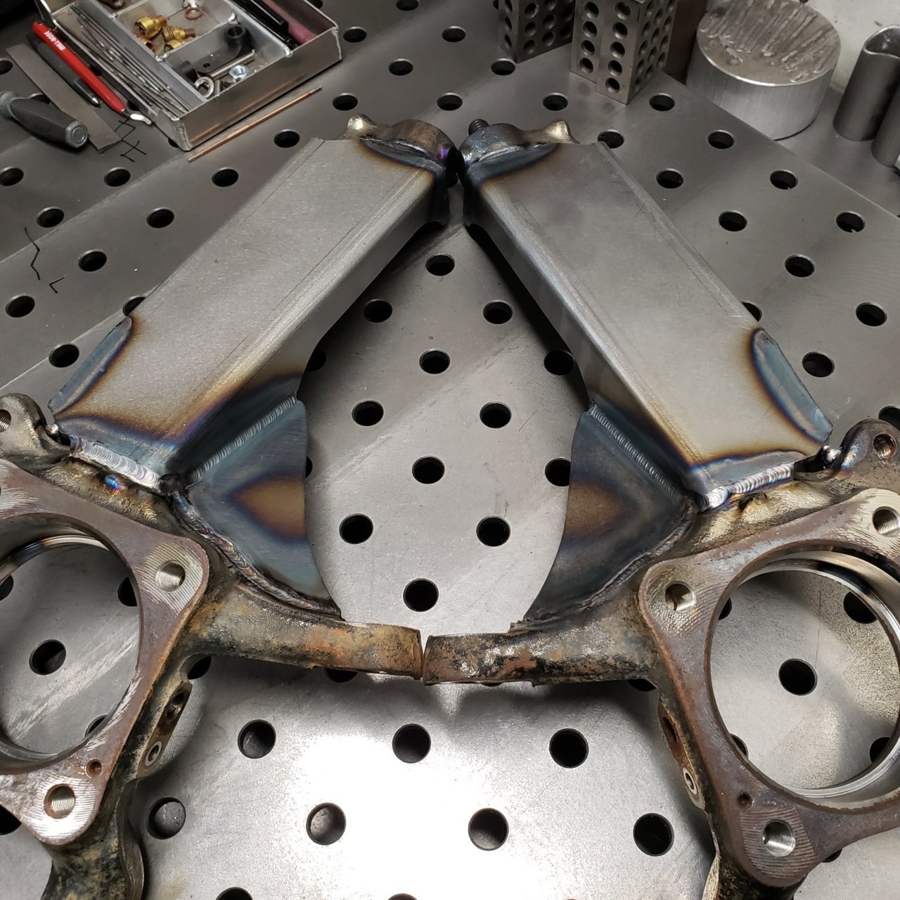

    TIG’d spindle gussets and lca bushing reinforcements
