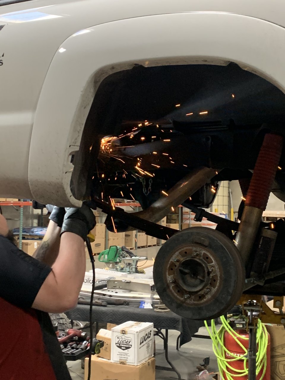

    Sweet. I’ve had their hammer hangers sitting in my shed for like 9 months lol. Been dying to get them on but still throwing suspension shit around my head and don’t want to pull any triggers yet until I’m done being on furlough for good.

    You’ll like em. Make sure you use their bits. They are quality bits and are a life saver. After grinding off each head, use the small bit to drill the center out a bit then switch to the bigger bit to drill out the bolt.

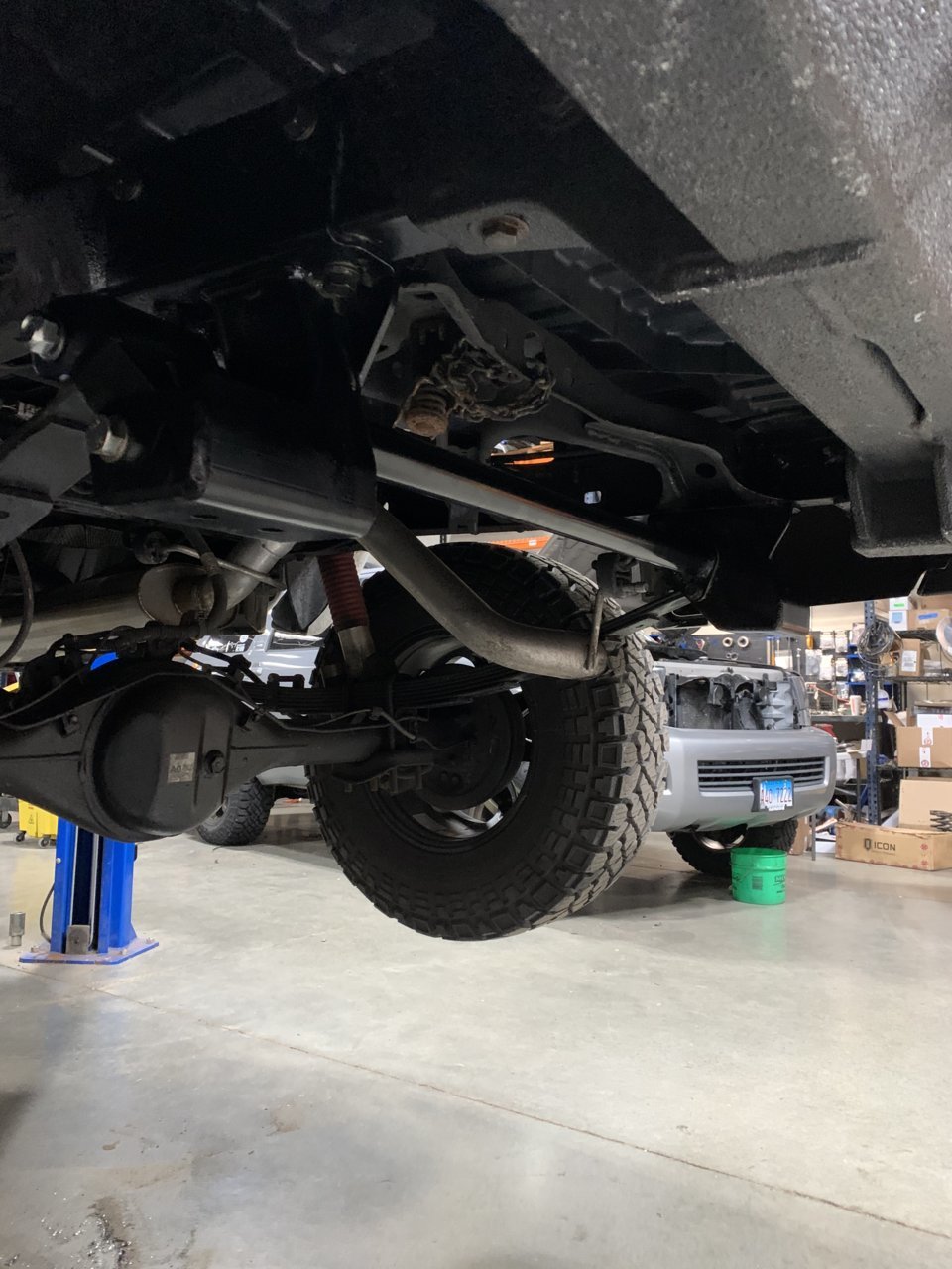

    Can you break down the benefits of the crosstube for me?
    I have the BAMF hangers, and saw they offer a crosstube plate to bolt on so you can weld in a crosstube. but not sure whether that would be beneficial.

    It adds rigidity to the rear end by tying the frame rails together in an additional spot - from what Ive read.

    Yup, what he said. In the 2 times I’ve now driven my truck since install, I do see a difference. Drives much smoother and feels like the rear is tightened up

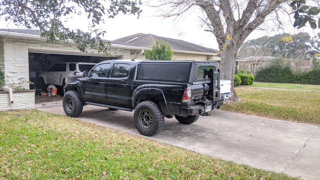

    Installed new shoes and wheels on the Baja today. Now it's time to break out the :sawzall:

    Looks great, but that stance would make me lose sleep about my wheel bearings.

    He’s LT I believe, at least in the front

    Yuppers as Island Cruiser stated it's a TC-2" kit up front rear is a spacer. Also have a set of McNeal 2" fenders for the front to hopefully keep my side windows clean the rear fenders will just be cut for clearance...
