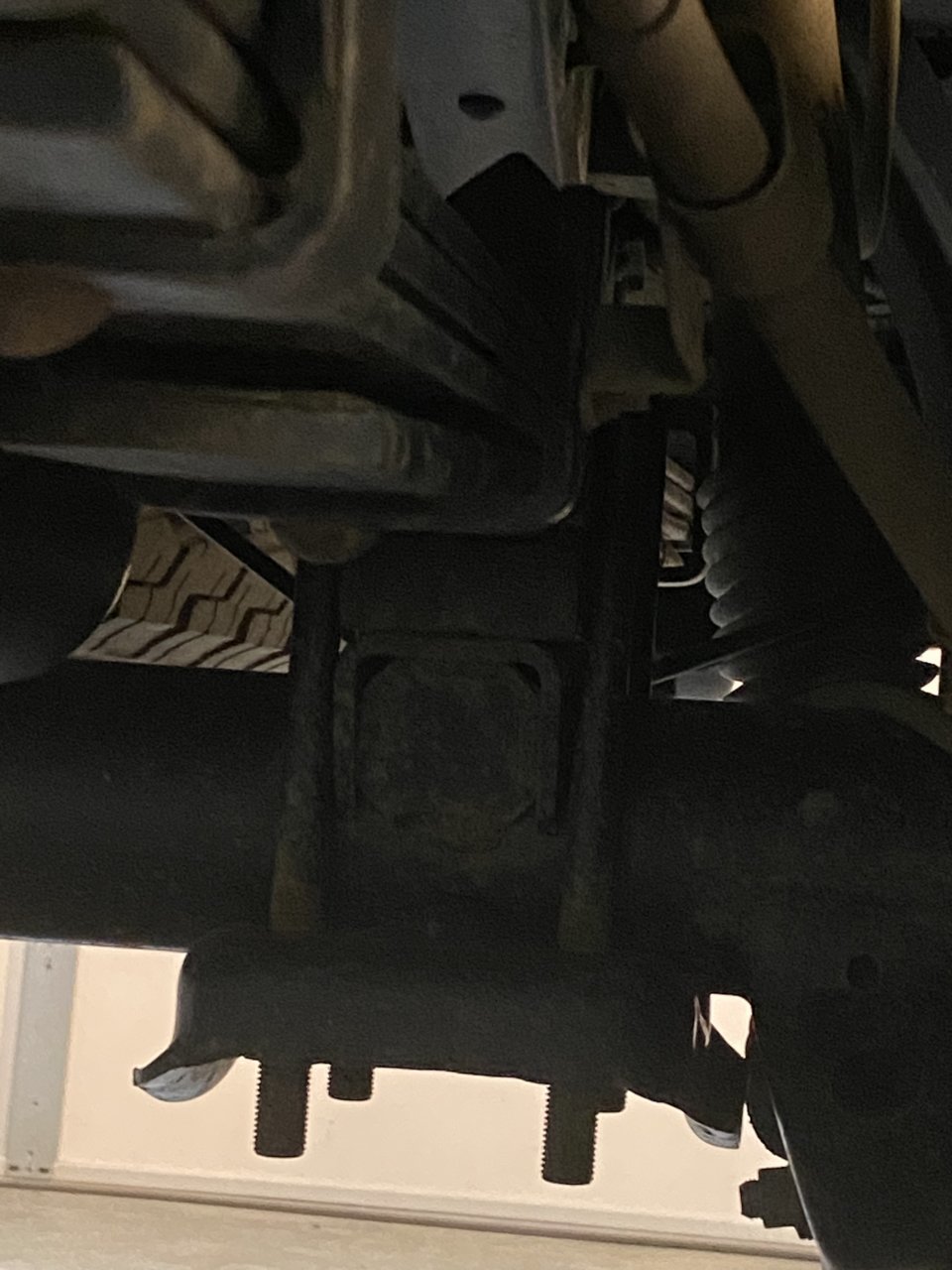

    Do these trucks have a stock block in the rear?

    That was added most likely.

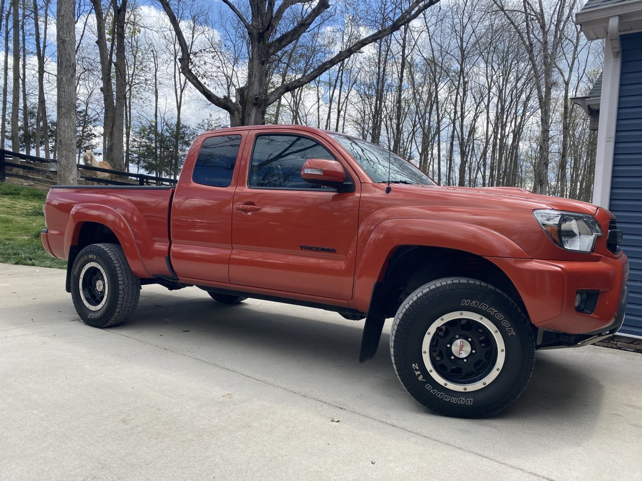

    Kinda of what I thought? It looked higher, even by Pro standards. There’s only about 3/4” difference between front and rear.

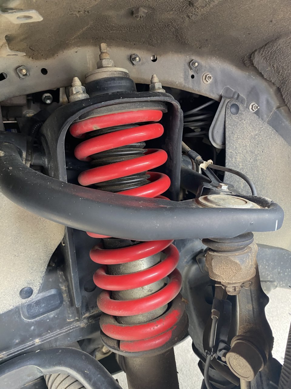

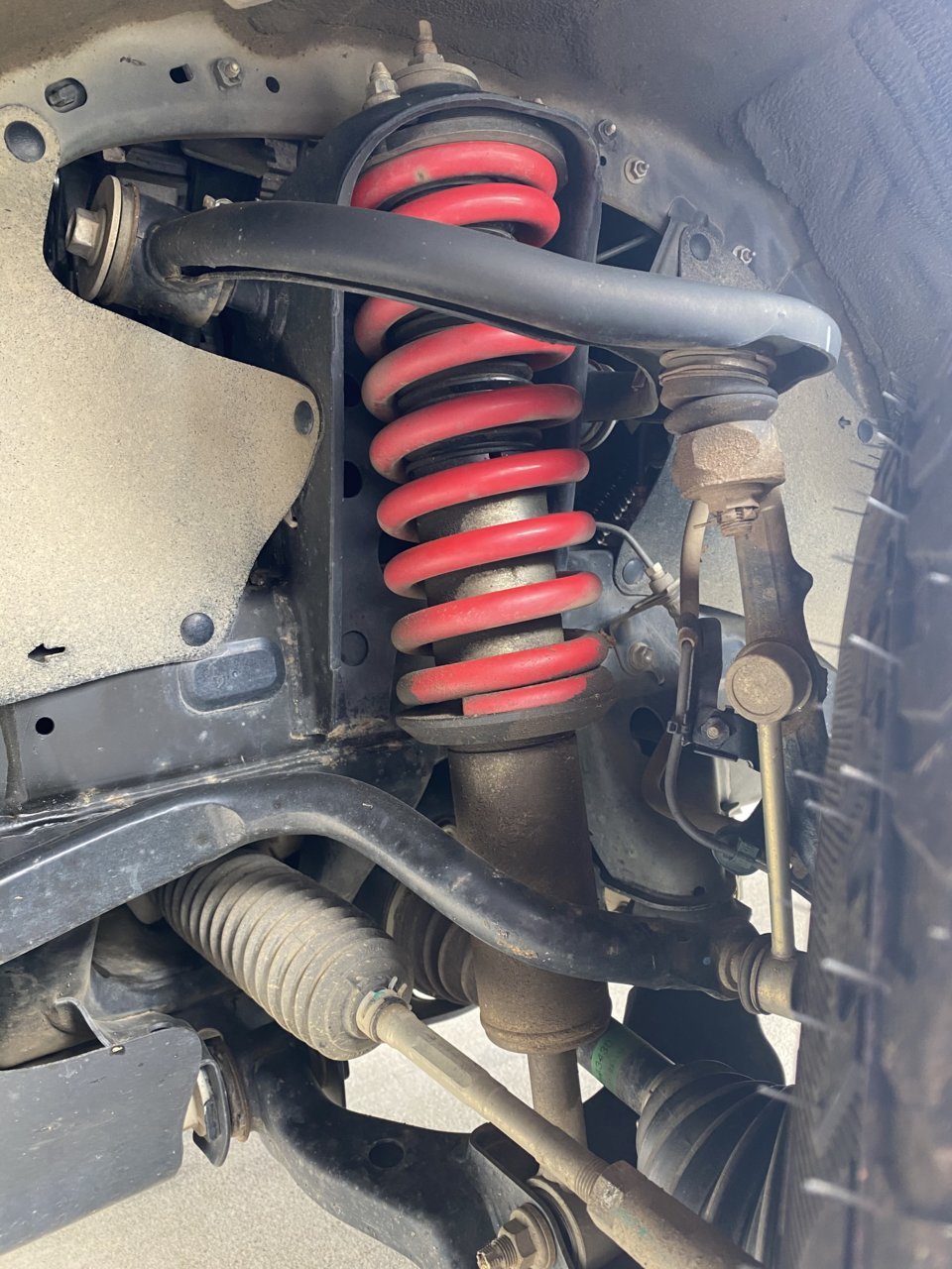

    Maybe the rear leafs began to sag so the original owner added that small block? Got a picture of the front suspension?

    Stock that suspension adds 1.75” in front and no lift in back.

    Maybe he did it to add a little rake.

    Front looks stock, right?

    If you want a little lift. You can add a 1/4” or a 1/2” Toytec top plate spacer to the top of the coilovers. Or, you can do the toytec 1” specific spring seat spacer. All are safe. They add 1/2” , 3/4”-1.0”, and 1” respectively.

    Yes

    Probably. If you want it 1” higher in front......I’d do a 1/2” top plate or the toytec specific spring seat spacer or a wescott kit. For the rear, I’d do a wheelers or icon progressive aal kit. If you want a rake, I’d leave in the overload spring. If you don’t, I’d take out the overload spring.

    Yeah there’s a little rake to it
