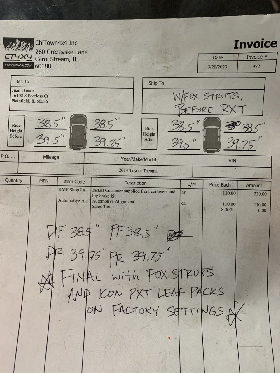

    I have this exact setup, With the wescott designs front lift. I initially took off the Baja suspension with a 1/2” top plate and addded the top plate to the fox pro coil overs. I then deleted the 1/2” top plate and did the wescott kit.
    In the back I have an icon rxt leaf pack. I had it at option 1 then changed to to option 2 when I did the wescott in front.
    Back when I initially did the fox pro kit with the above mentioned 1/2” top plate, I ended up exactly at the same height I was at with the Baja suspension and the same top plate. With switching to the wescott kit, I went up to approximately 2 & 3/4” up front. From 2 & 1/4”. Since I went up with the wescott kit is why I went to option2 on the rxt kit which put me at 1 & 3/4” to 2” in back

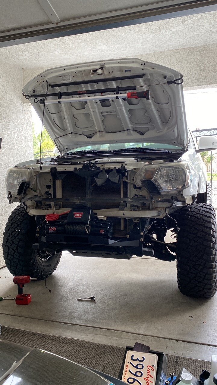

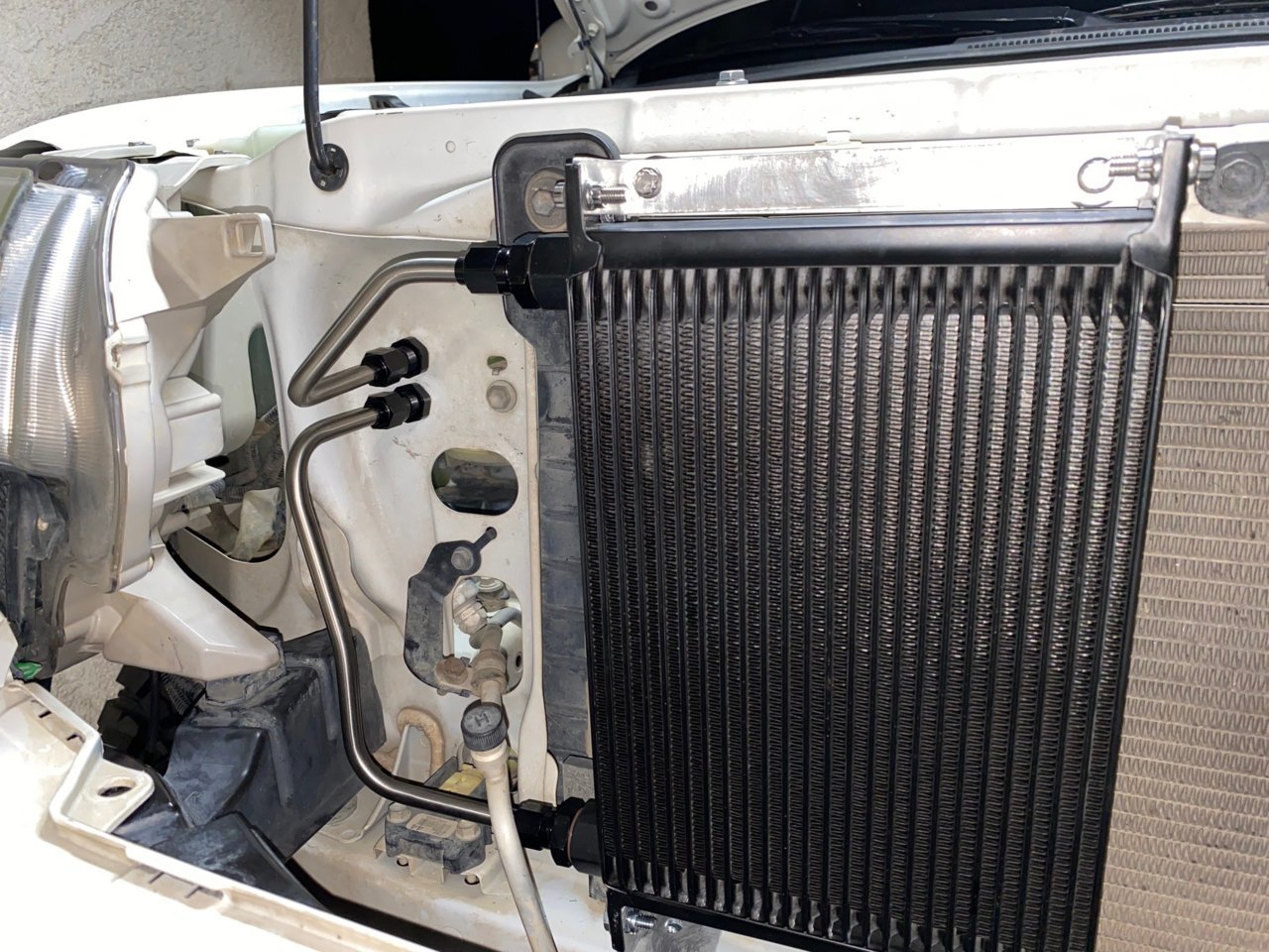

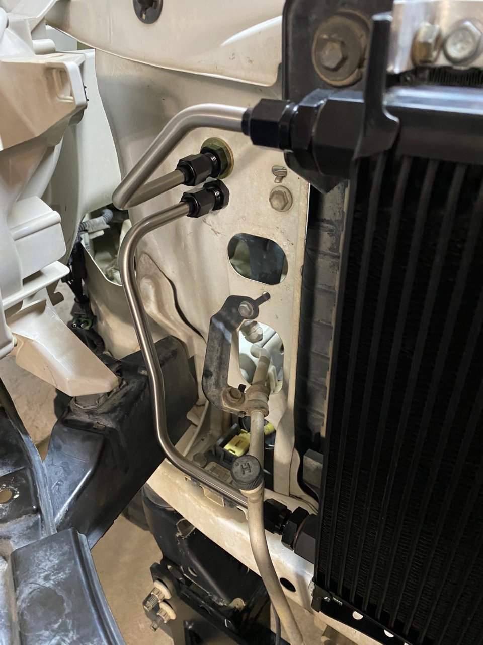

    Started installing the pelfreybilt hidden mount this weekend. I figured while I was at it I should install the derale trans cooler that has been sitting in the garage for 2 years lol. I still need to make a bulkhead spacer out of aluminum so ignore the washer for now :bananadead:

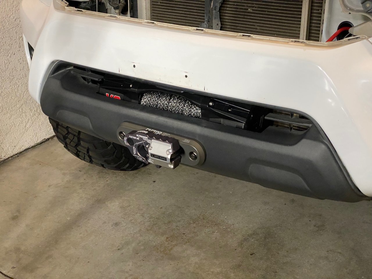

    Nice and simple. Still unsure if I should throw the license plate back on or not?

    Looks good Gio. You forgot your grille. :p
    I don't run front plates on my nice cars, but since you already have the holes, I figure you might as well. One less chance to get pulled over?

    Thank you! Very true, it's one less reason to get pulled over lol. I don't have one on my s2000 but I don't drive that as much. The grill is off waiting for the trans cooler setup to get installed today. I painted them black last night, but here was the final fitment.

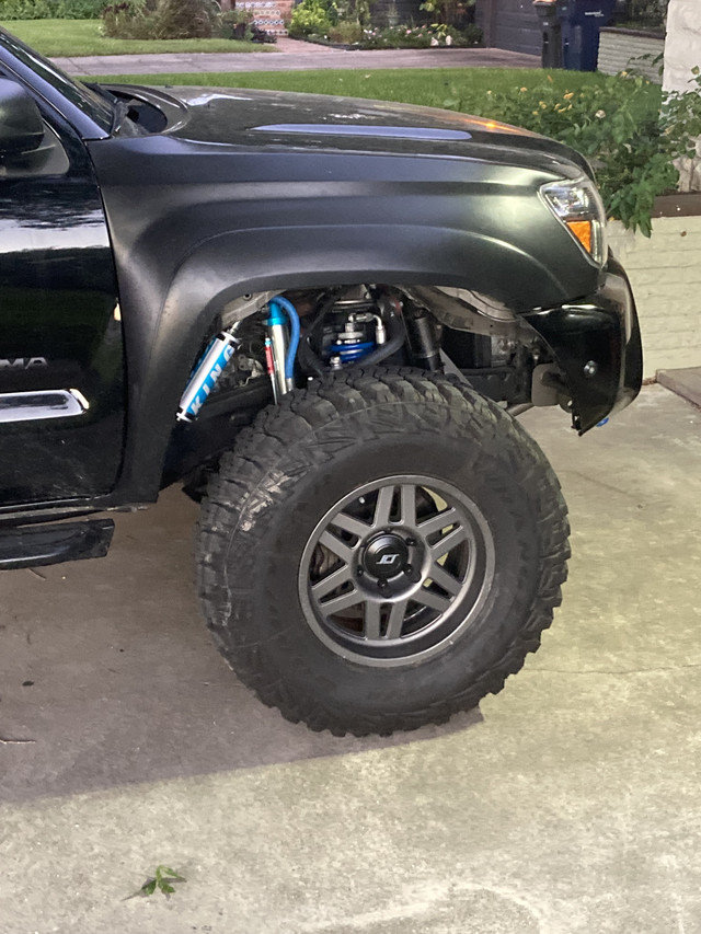

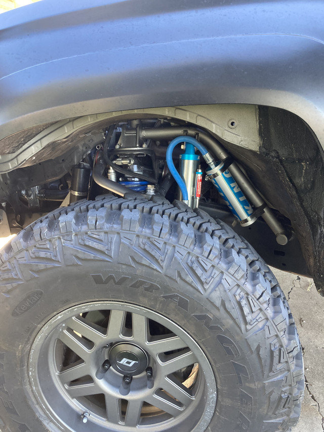

    Installed some extra bounce control...

    Dayymmmm!!!!!
