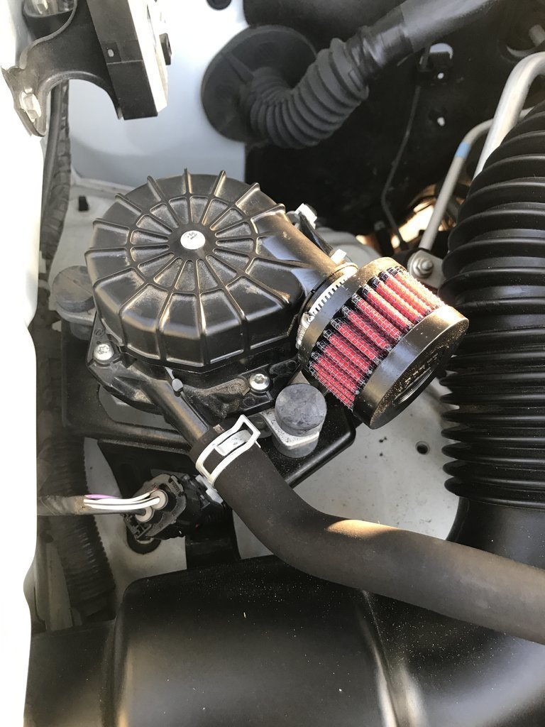

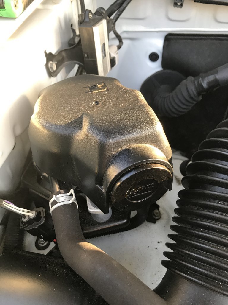

    Crash installed one on his old truck/now mine. No downside unless you try to go into Toyota for warranty, so just keep the old parts in case anything ever happens and you need to exercise the TSB to save $1200+ for the SAIS failing.
    Bonus, is that the plastic cover still fits on top of the UNI filter if you want the OEM look.

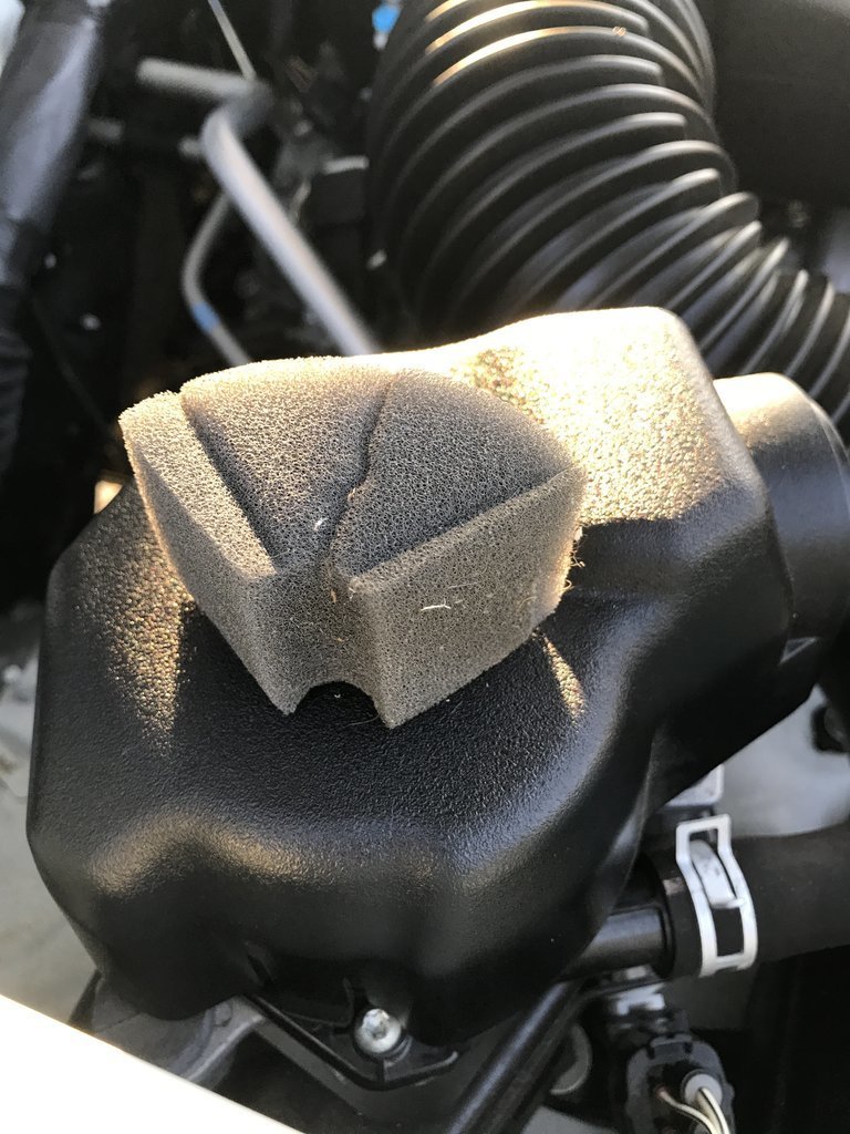

    Absolutely no issue. You want to do this no matter the year. What happens is the little piece of foam filter breaks down. Once it does, those pieces makes their way through the system and into the valves causing significant bigger issues. This eliminates the foam from being there but still filters the air.

    Dug up the old pics from my build thread
