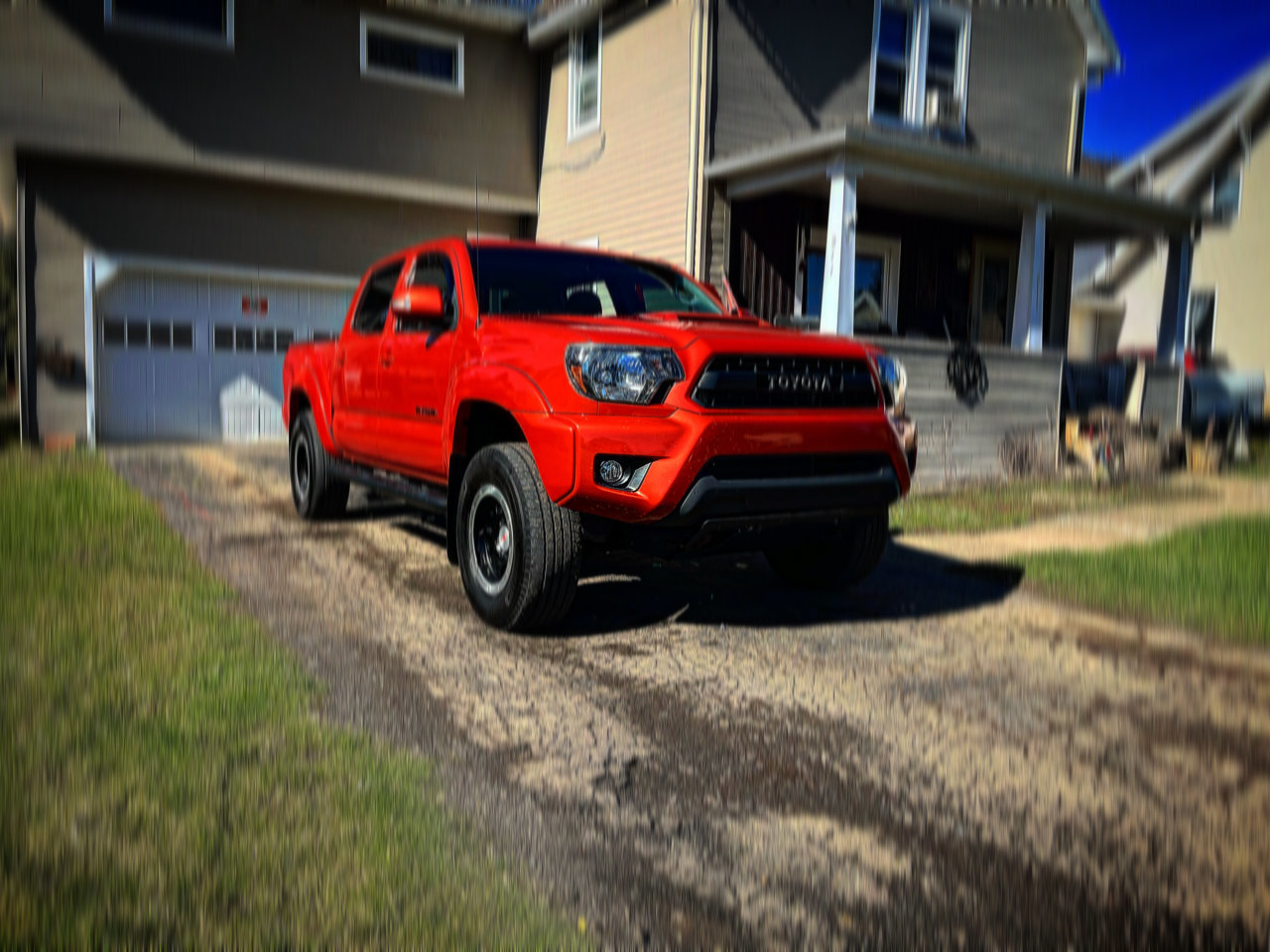

    Feel lucky to finally own one!

    That color never gets old. Congrats!!

    Congrats

    Congrats Travis! Welcome to our thread!
