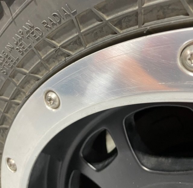

    No gouges really just looks like some of the polish has alot of etching around the small bolts that hold the rings. would a quality clearcoat work after doing all the prep work mentioned above to get it back or close to original? I have all said tools and have plenty experience doing shade tree body work but never attempted anything with a chrome like finish.

    The aluminum rings aren’t polished, they’re more a scratch-brush finish. Should make it easier to do, and no need for a clear coat … right?

    EXACTLY!
    They are lightly clear coated aluminum which makes them easy to work with compared to steel. If you’ve done body work then you’ll be able to knock this out easy.
    Same concept as body work. Use whatever the least aggressive tool/grit needed to remove any flaws. Then work down to progressively less aggressive grits. Then when it’s ready hit it with a polishing wheel on your bench grinder if you’re comfortable with that (now that I think about it it’s kinda sketchy). Any sort of polisher you’re comfortable with should work. I just used Mother’s mag and aluminum polish. I’m sure there are all sorts of other polish products you could use as well.
    If you don’t want them polished you could do a brushed look. After a light polish use some extra fine steel wool, aggressive polish or fine sanding sponge. Something to just knock the sheen down and give it a uniform texture.
