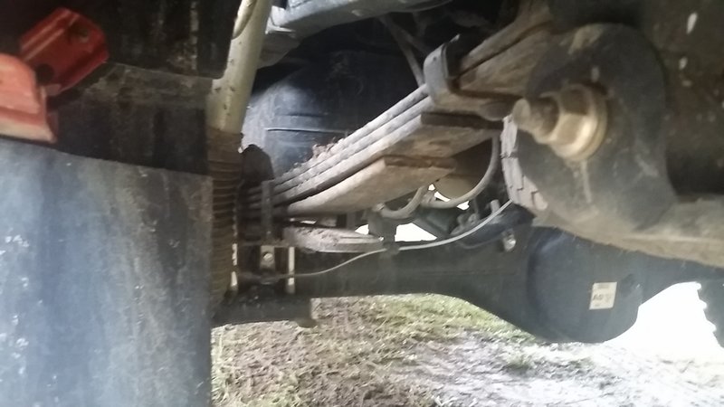

    Here's a picture with factory overload. If you go this route, you'll need to cut the forward brackets off the overload as shown.

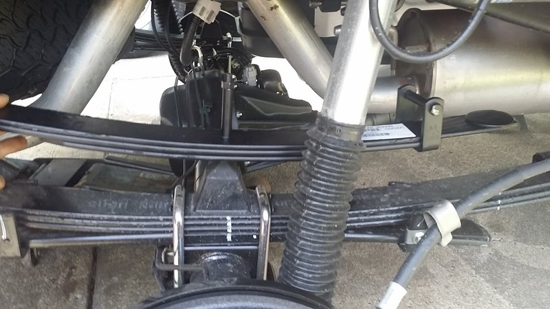

    I didn't use my factory overload, I have the icon progressive AAL, I had to cut off the rear brackets.

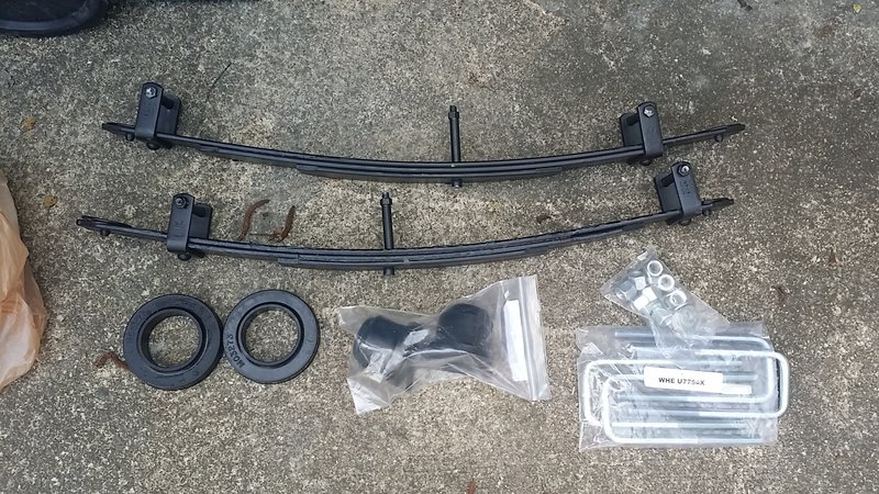

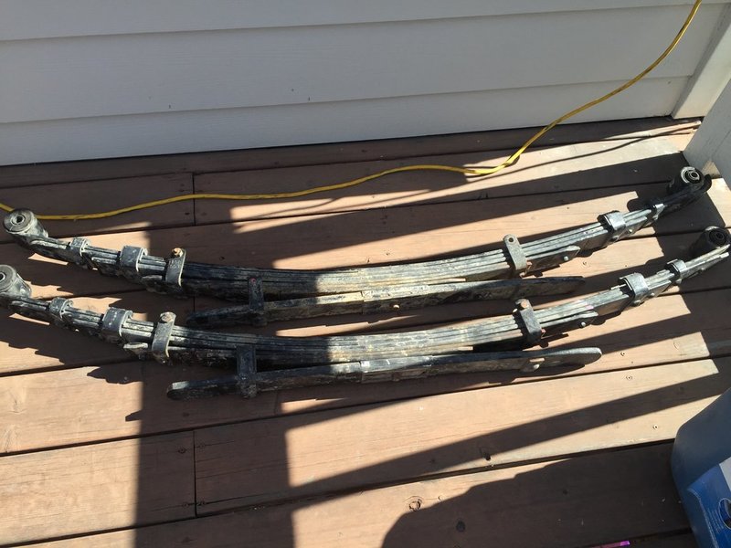

    I can't find any pics installed, and can't take them since I didn't like the setup but here are some pics for reference of the 3 leaf progressive.
    Mine came from wheelers with the worst coating I have ever seen on something I bought, and they were made in Canada.
    For what its worth wheelers was excellent to deal with, just the one particular product was lame as hell.20150514_163124.jpg20150514_165024.jpg

    I If you look closely at those two pictures, those springs came that way, directly out of the package.
    Needless to say, but I can post pictures if you like they rusted and flaked instantly after installation. I only ran them for a few weeks.
    They were soft, with the overload removed to save the clamp they were virtually no lift at all. They did seem to help a little with spring wrap, however it would still hop the rear wheel if floored.
