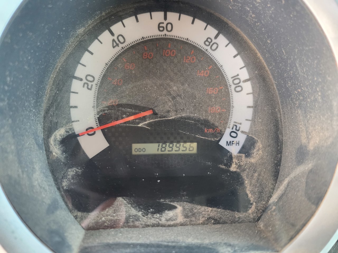

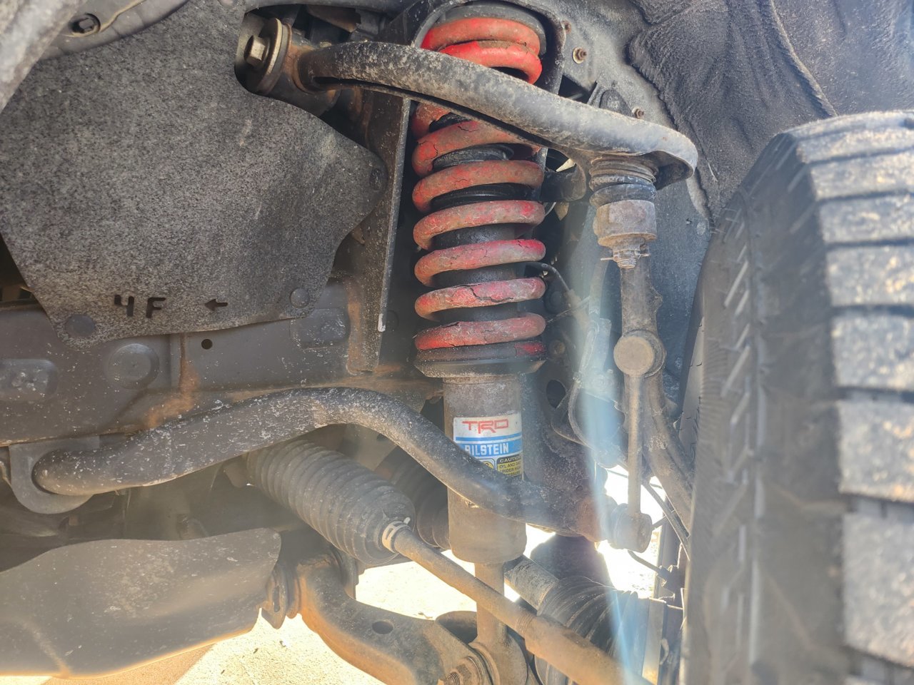

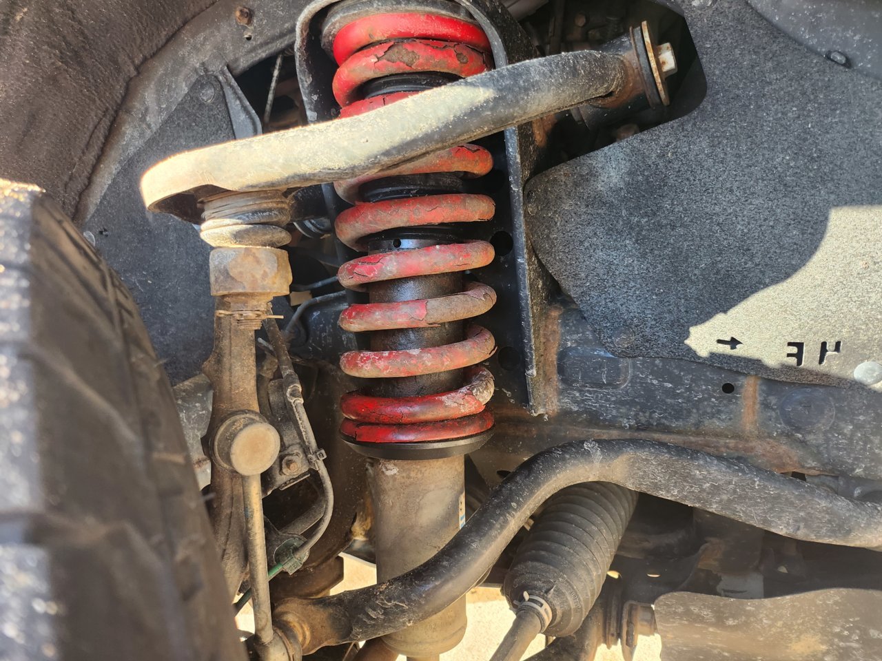

    I'm the 2nd owner. Dealership had it before me as a parts runner. I have no idea how long these parts have been on it. Just noticed the red on the coils is started to split/peel off. Figured it's time to replace. Started looking and holy crap! You guys spend a ton on this and I don't want to get it wrong lol.

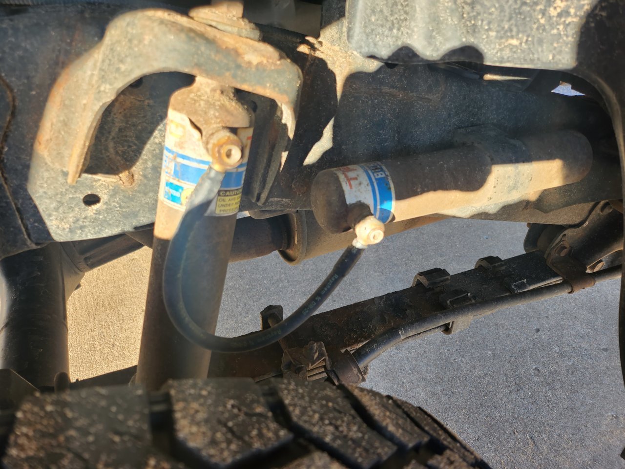

    Impressive! Post up some pics, let's see what these 190k shocks look like.

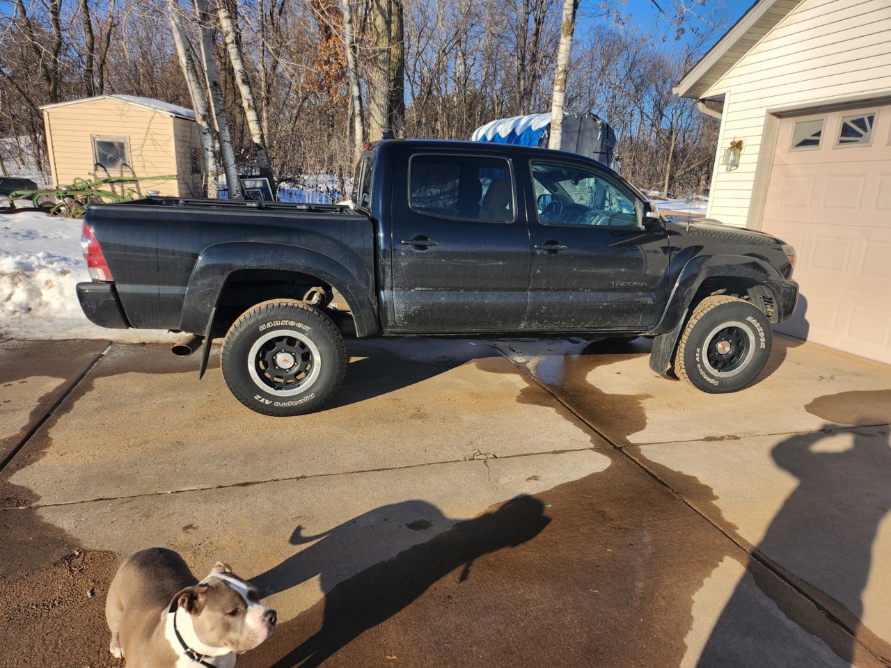

    20230208_153752.jpg 20230208_153728.jpg 20230208_153752.jpg 20230208_153728.jpg 20230208_153713.jpg 20230208_153823.jpg 20230208_153842.jpg

    :bowdown: Impressive amount of miles on those indeed!

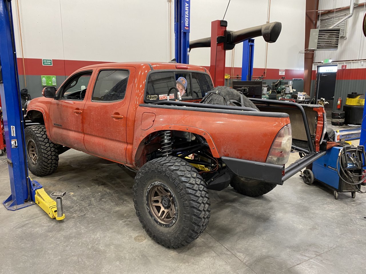

    It's was built by Dezert Toy Fab https://deztoyfab.com/ He builds some truly awesome stuff!

    Yeah those are smoked, I would go with 6112s if you like the maintenance interval.
