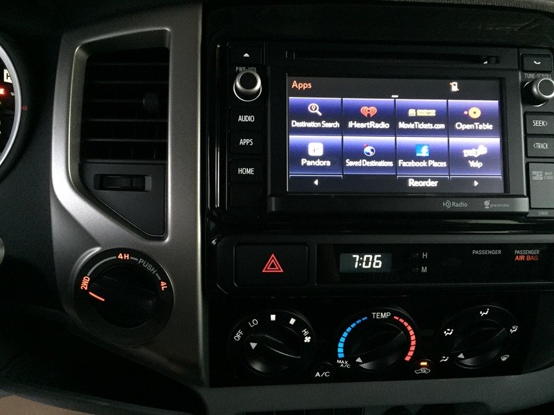

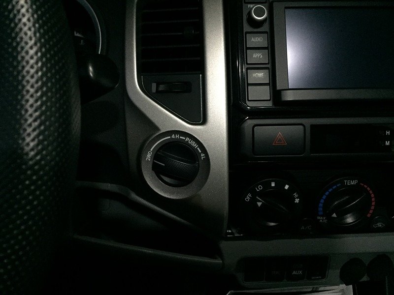

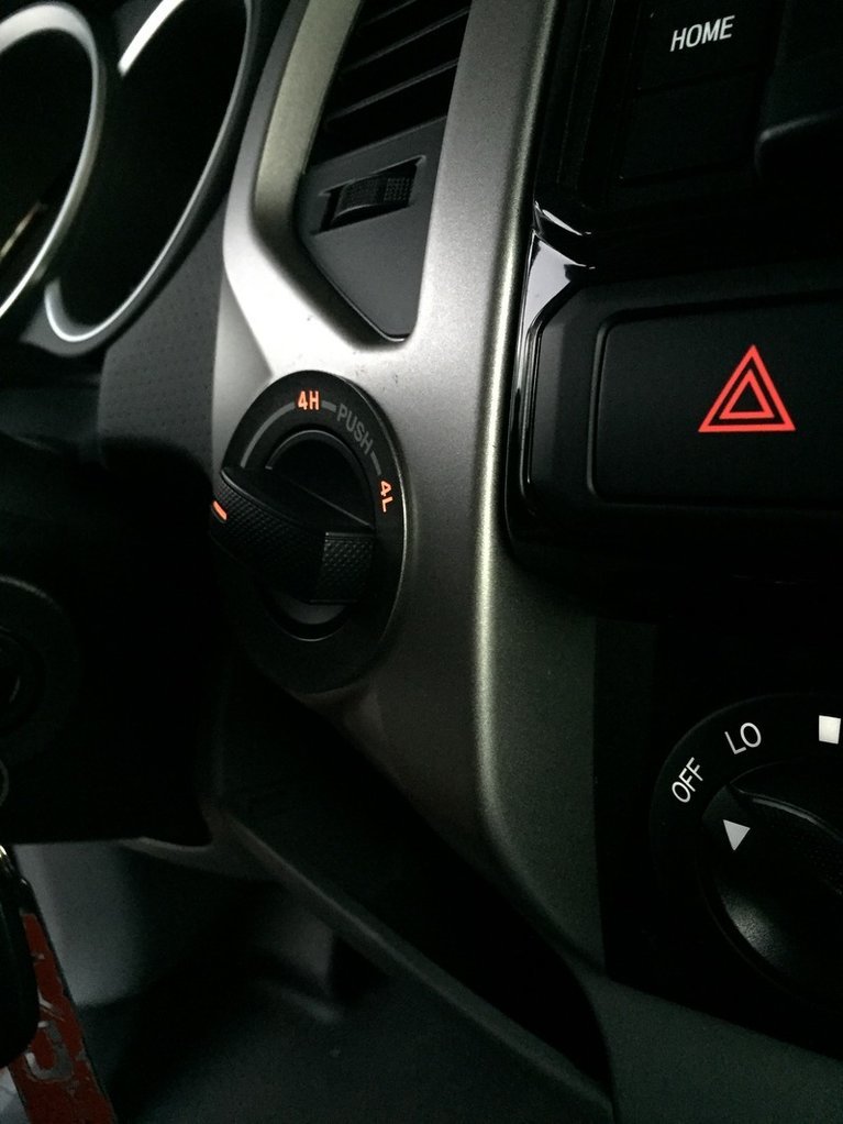

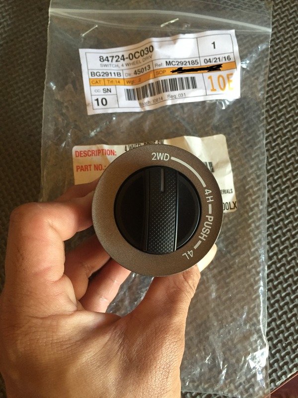

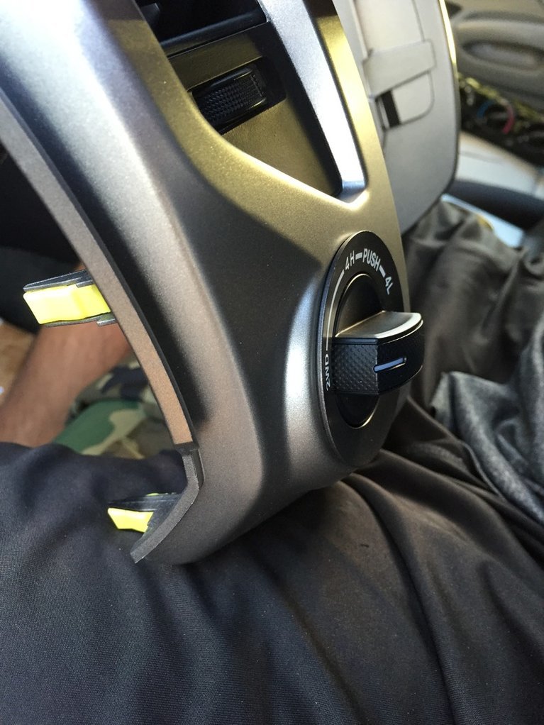

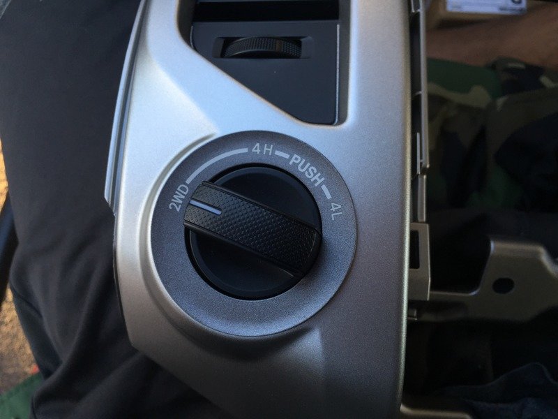

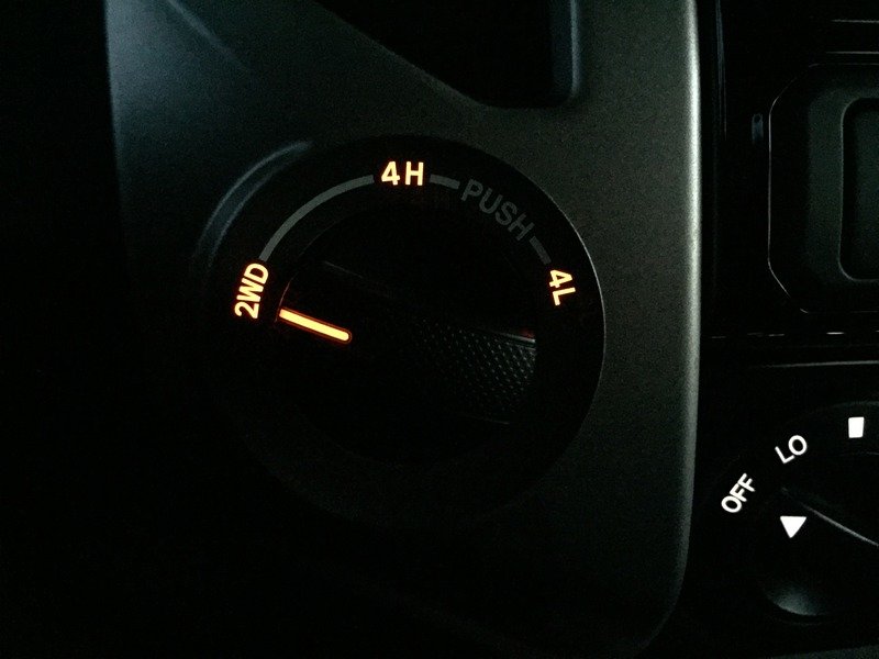

    Upgraded the 4X4 switch to a Tundra switch that illuminates. With a little modification I got it to sit flush. The amber color ain't that bad.
    5CF789FE-BC94-422C-A292-C7015E40B42E_zps_643c3661b74175bb819e502e36aafe3e6bc57ba5.jpg
    3B8BA3C3-C082-4294-AFE5-FC5088ACA310_zps_72d3782d55b9cce2446a9bb6f3ec2cf1aa9fb538.jpg
    1E12C060-340B-4C64-AEE6-D149BF91C12A_zps_5b4660ac6d7d871ff6b8f43f74452ffb9fe6311f.jpg
    8CC235DE-E33F-4114-81D6-1E4514D61A79_zps_b8d3b1773b79ef60e668894df22e56789e41aba8.jpg
    047B1445-9E6C-4B1E-B3F1-966AED5DC138_zps_536bf2f4bcc2f2d2a0cbea8c56413938cd51a9fd.jpg
    B383F8C8-2AFD-4B7A-9356-817C9E1E6545_zps_ea6008468dcf7b722c8f74126f4ac8059e2d1fff.jpg

    Nice work! How hard was it to make work? Have a part number? What do you think the odds are of switching it to green or white illumination?

    All I added was 2 terminal wires to the existing connector that plugs to the switch. Tapped into the HVAC for illuminations.
    Hardest part was removing the stock switch. Not as easy as the earlier 2nd gen. For you to get access to the stock switch, have to remove the HVAC, headunit, and the surrounding trim. It was a PITA to do.
    There's 3 pretty small led's. If you got some soldering skills I'm pretty sure you can switch it out.

    I may give this a go. What year tundra did it come from? I still want to switch my blank "Tacoma" panel out for one from a 12-14 with a clock too.

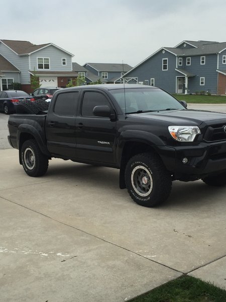

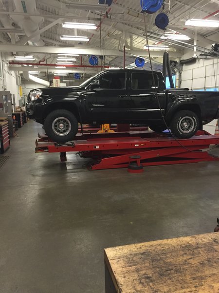

    Vinyl wrapped rear bumper gloss black.... It was a PITA!!
    image.jpg :yes:On my way to mount 265 75 16 at3w's!!
    So cited!!!

    NICE. I put 265 75s on my '01 and loved the difference. Not too much, just enough. Did you consider 285s, and if so why'd you opt against them?
    It goes without saying, but let's see the pics when it's done!

    I took the truck over to the base Auto Hobby Shop...after two hours the only person working there put one tire on and was in the process of finishing the second...smh. I will pick it up tomorrow. Will post pics once I get it back.
