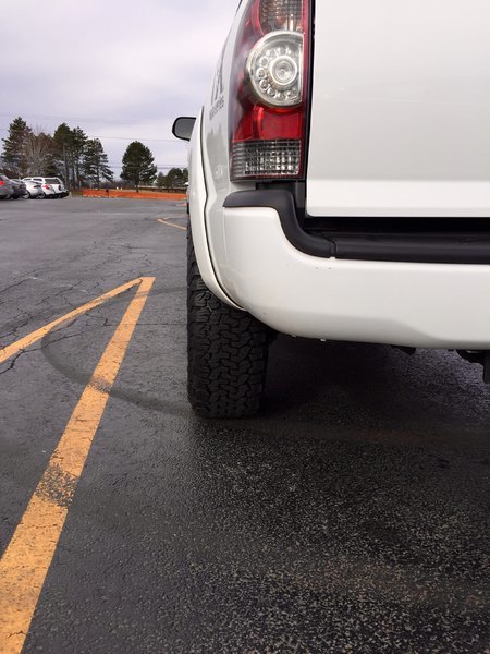

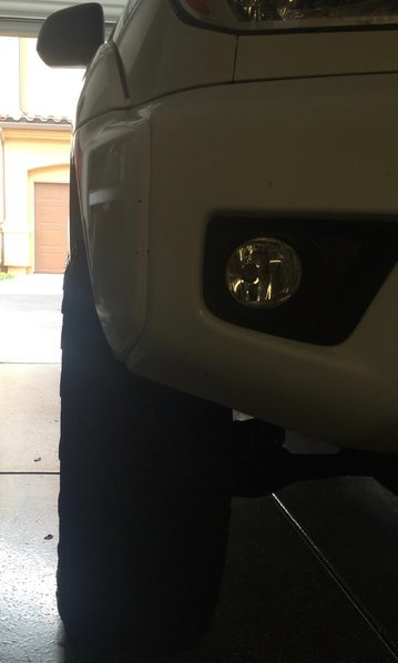

    Either @pruchai or @ellzy_21, do the 285's stick out past the fenders? Could I bug one of you guys to take a picture along the side? Also I'm assuming you guys arent running wheel spacers?

    No wheel spacers here....and they seem to be almost perfectly flush with the fenders.

    I got no wheel spacers and mine stick out maybe 1/4", if that.

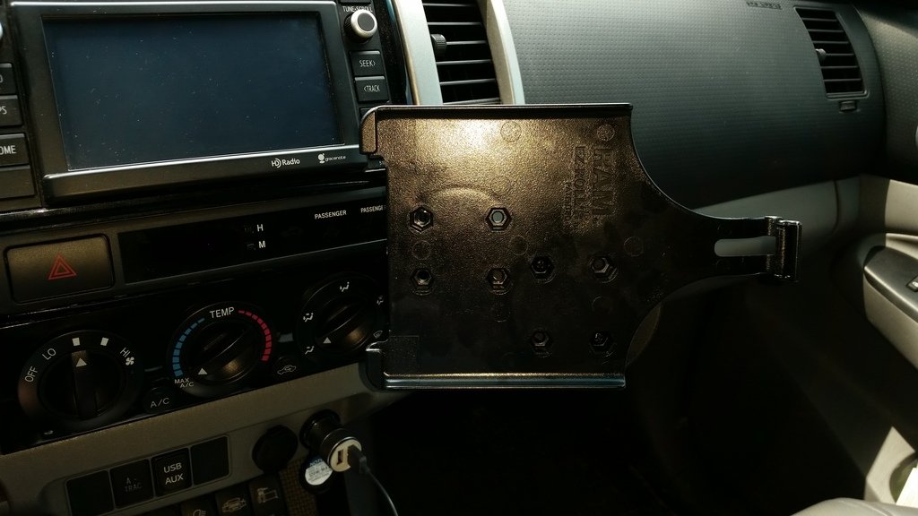

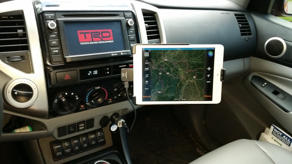

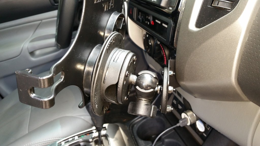

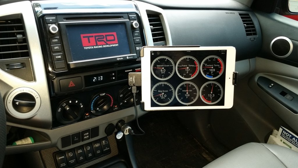

    So the wife had an iPad mini that she never used which means it recently got acquired for truck duty. I am going to use it for monitoring some engine parameters and using it for offroad GPS. I used a Panavise dash mount for the Tacoma, with two RAM 1" ball 2.5" bases and a short arm. Then there is a RAM roto mount and RAM iPad mini holder. It's a WiFi only iPad mini, so I have the Bad Elf lightning connector for GPS signal. I'm typically seeing less than 12ft for accuracy. I'm using Gaia and MotionX for offroad mapping, and OBD Fusion for engine monitoring with an ELM327 adapter plugged into the OBD2 port. I still need to hardwire a charge cable for it, but this should do for now. I'm heading out this weekend to give it a good test.
