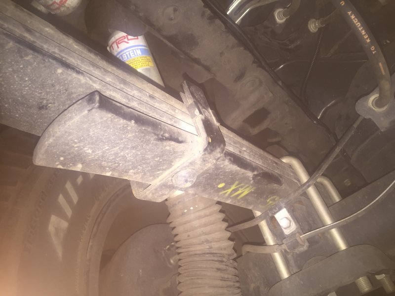

    I am contemplating the switch to 285/75/16 for my truck. Thinking about getting the Toytech spacers up front, and the Icon AAL for the rear. Question is about the overload leaf. Pretty sure I have one, but I'm not a pro with this suspension stuff so I thought I'd ask the pros here. Is the overload the spring on the bottom in this pic? If so, what is the consensus here from people that have done this exact mod. Leave the overload and add the AAL, or add the AAL and remove the overload? Really looking forward to this upgrade, hoping the tires don't rub. Thanks for the info.

    I did the Wheeler's Progressive 3 leaf AAL and took the overload out. It rides great, flexes out awesome, and holds plenty of weight. Also, yes that is the overload on the bottom of the pack.

    Like Dave said, yes, that's your overload. I went with the ICON Progressive 3 leaf AAL. Honestly for no real reason at all. My ride has been awesome, no sqeeks, and absolutely zero problems. I have yet to add the Toytec spacers up front and because of that, I removed the overload leaf when I added the AAL. I did that to not have too high of a rake in the rear. Once I install the Toytec spacers I will then reinstall the overload leaf back into the rear spring. Hope this helps.....
