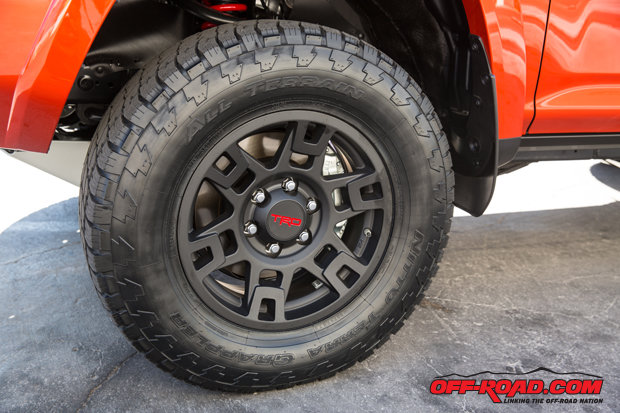

    Yep. And they are not on the market yet:
    Compare the design to the 17" 4Runner TRD Pro wheels, which have been on sale for a while:

    Should have used the 17s they look nicer

    ^That's debatable. Functionally 16" wheels are better for off-road (less wheel and more tire). Arctic Trucks uses 15" wheels with massive negative offset (to clear the calipers):
