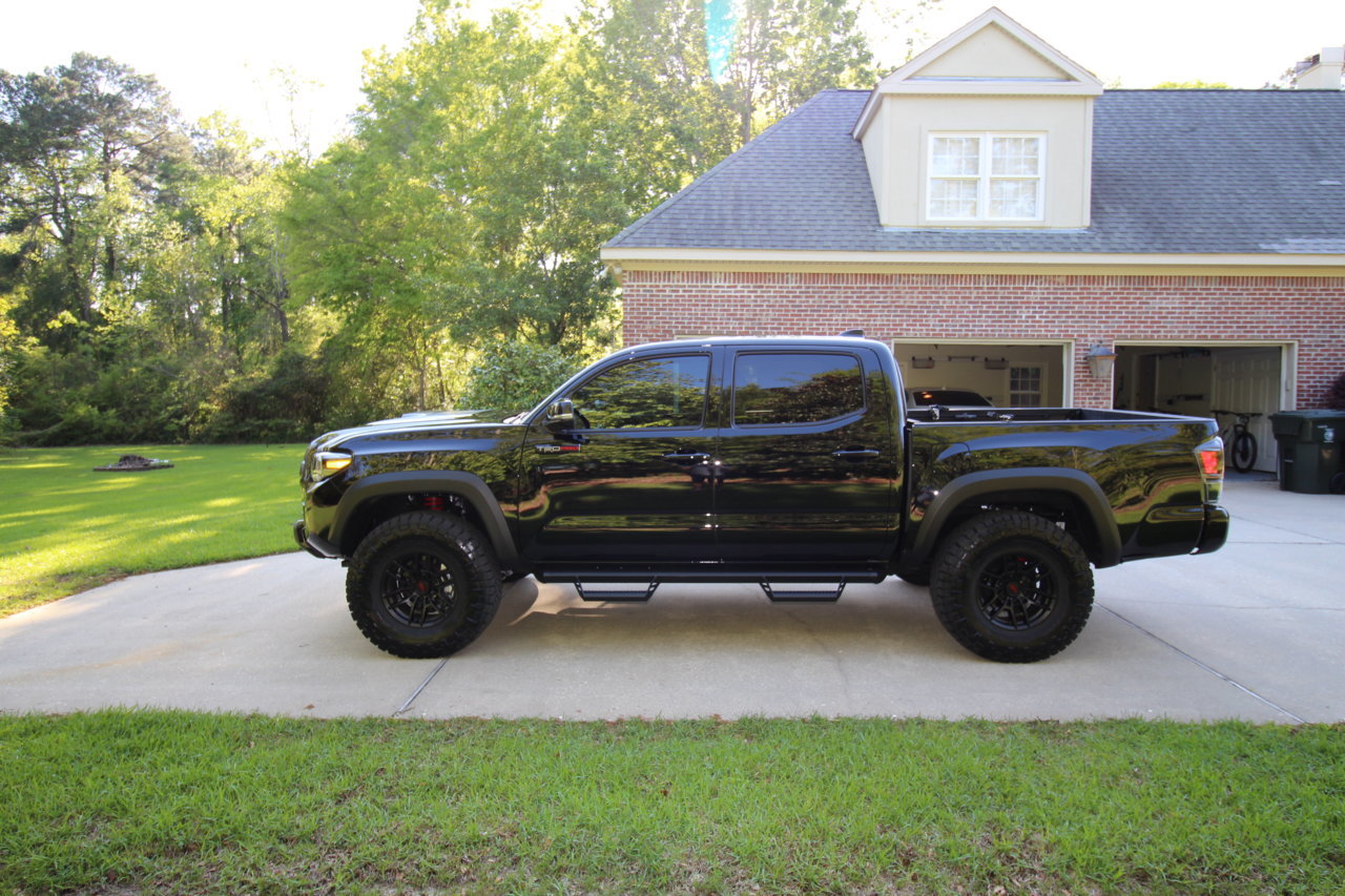

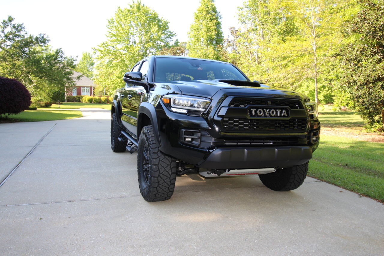

    I lifted by 2021 TRD Pro with a Westcott Design lift. 1.5” lift front and rear from original TRD Pro stock height. I’m running 285s with no issues. I’d like to add 1.25” spidertraxx wheel spacers to improve stance. I have not done CMC.
    Anyone running this setup? Any thoughts on me going this route from your experience?

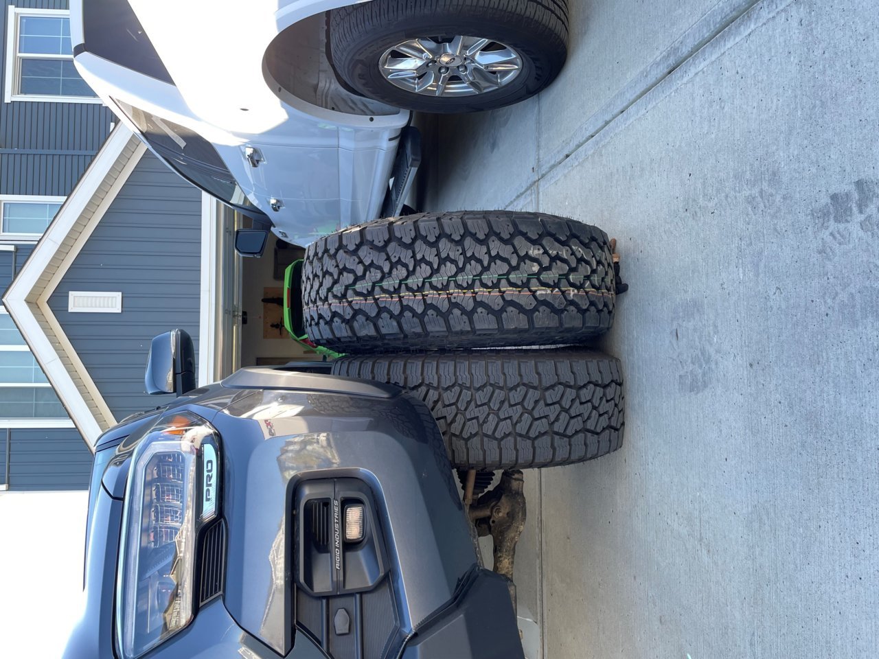

    I ended up going with 1 inch bora spacers up front with a 16x8 et 0 and 285/75/16. Running the Westcott 1.5 up front & Icon AAL in rear. Had to remove my mud flaps and only get slight rub on the cab mount and fender liner when cranked in reverse (not terrible)
    I mounted a 315/75/16 general grabber atx on my spare wheel so I can test fit and see if I can get away with running a 35. Have cab mount chop plates ready to go. Will probably get around to chopping and welding sometime this winter
