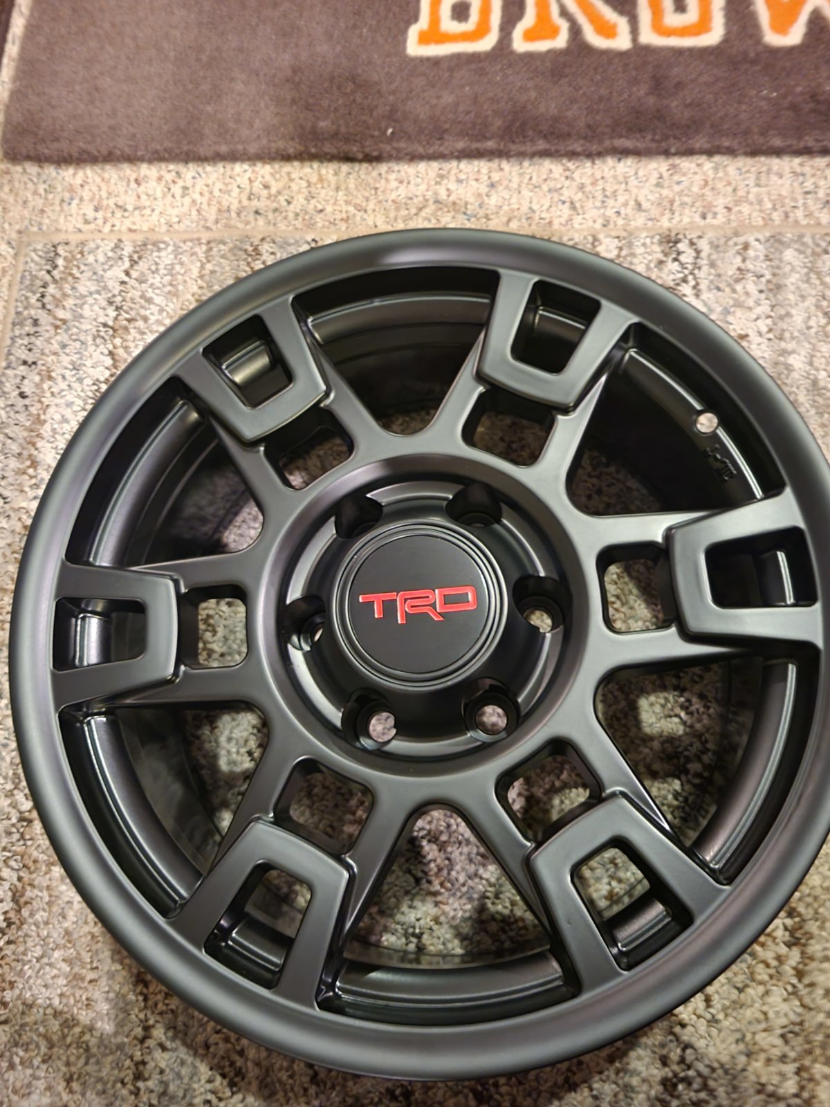

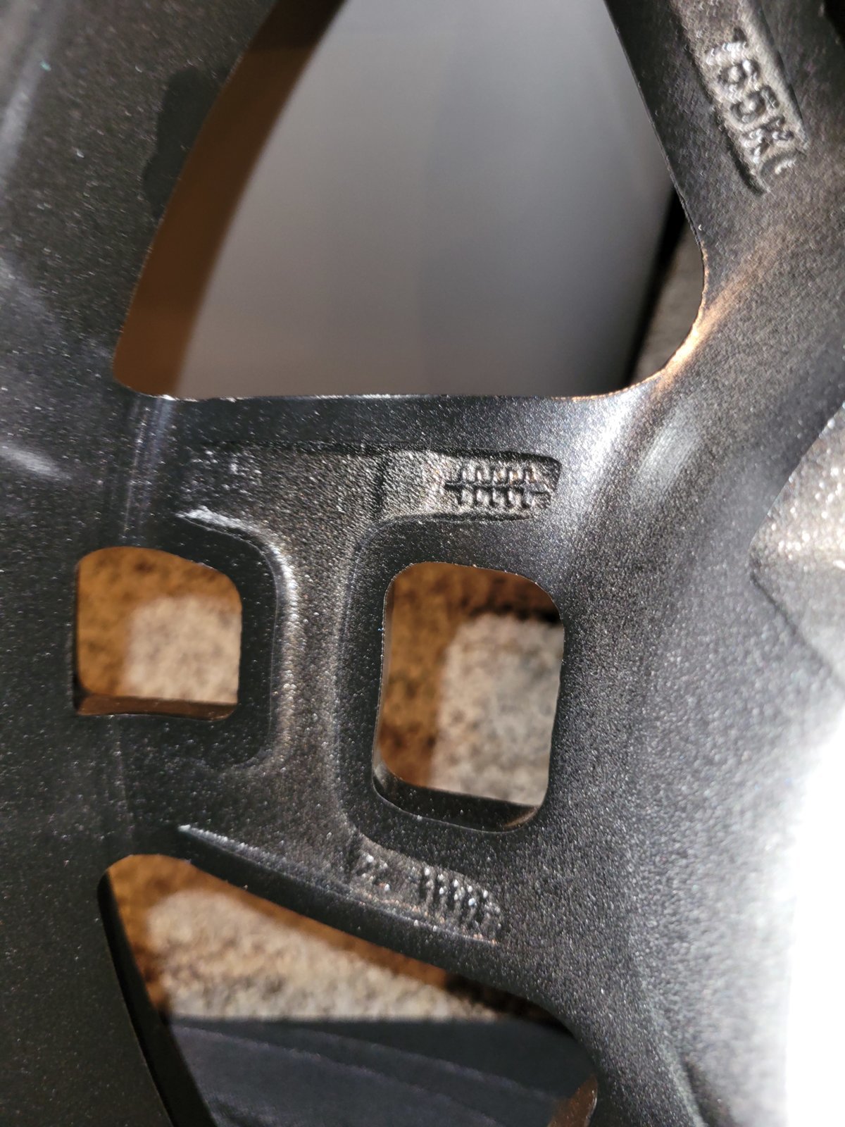

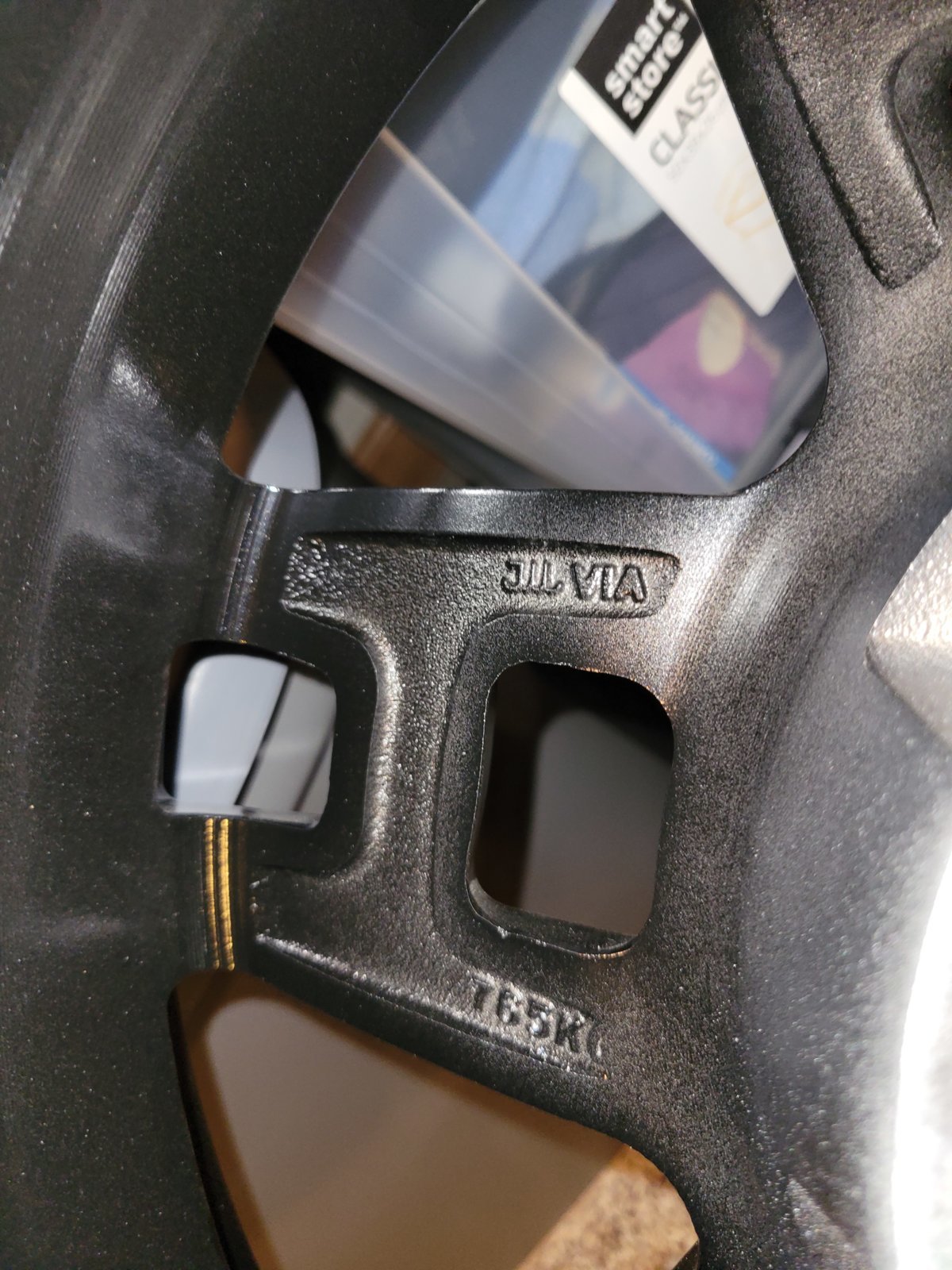

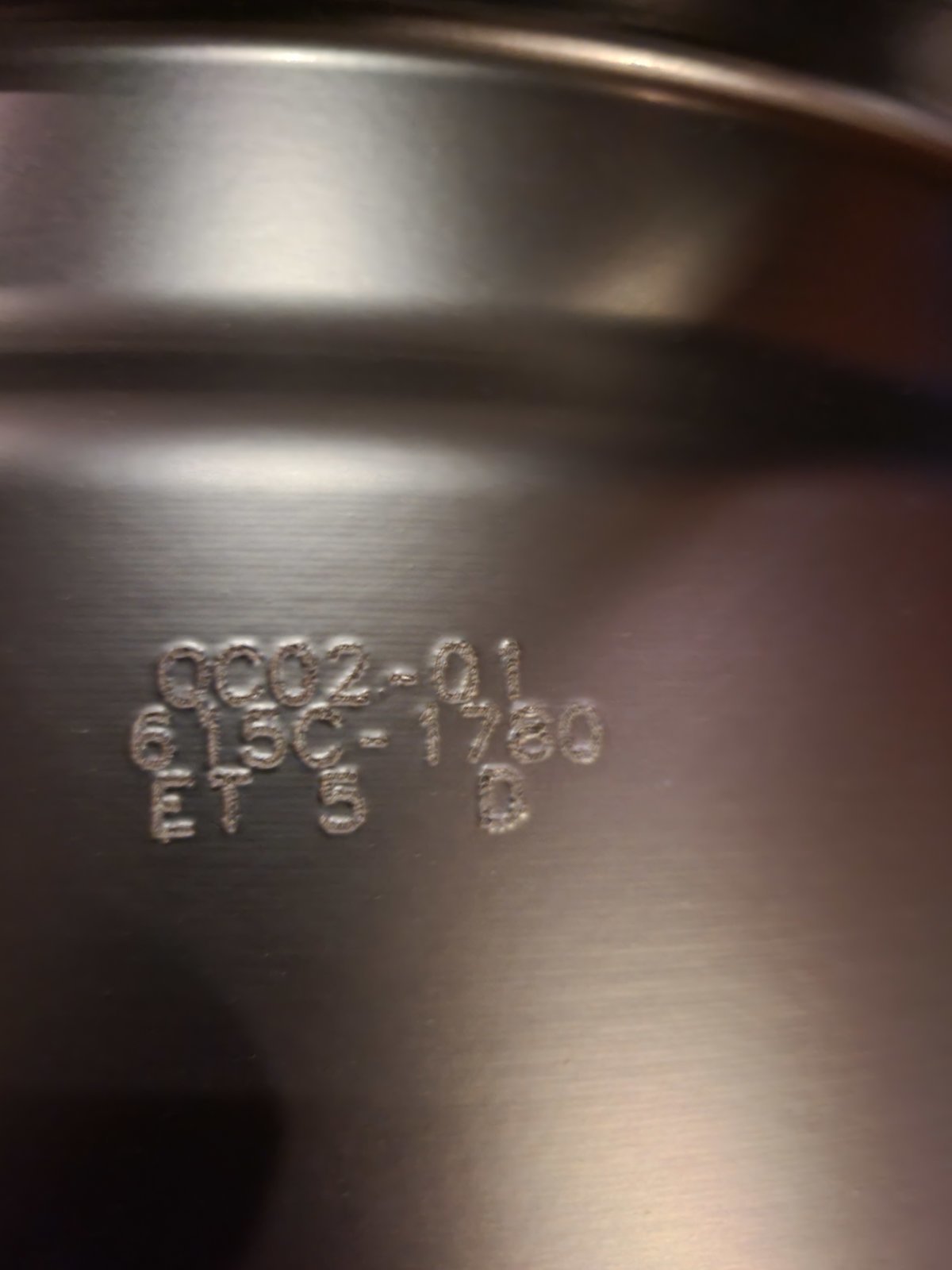

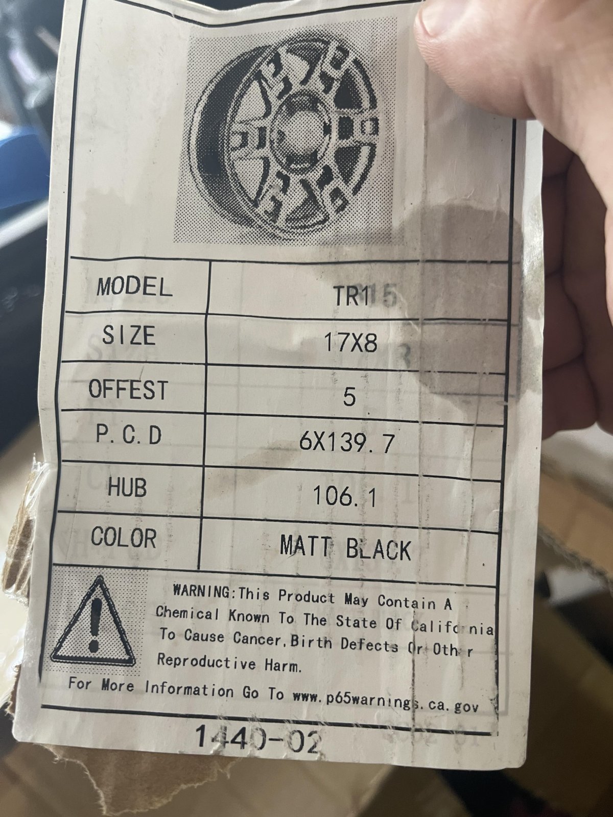

    First off, sorry if this has been answered before. I have been searching and searching and can't find anything.
    I bought three new TRD Pro style wheels off someone, the previous owner said they were OEM. When I picked them up the boxes they were in had some markings that didn't make sense.
    I just want to make sure when I buy a 4th wheel that it matches. Any and all help is appreciated. received_656495226464285.jpg 20231018_184705.jpg 20231018_184405.jpg 20231018_184516.jpg 20231018_184524.jpg received_656495226464285.jpg

    not oem.
    oem is 17x7.

    Definitely not factory wheels. Factory TRD Pro's come with 16" wheels.
    The ones you are showing appear to be these
    https://alphasone.com/products/copy...ss-black-wheels-fits-tacoma-4-runner-fj-6x5-5

    Not OEM.
    A few items to note:
    OEM are 17"x7".
    OEM are matte black (those are satin black).
    OEM have the part number stamped into the back of the spokes.
    OEM center caps look different (minor difference).

    One more question if mine really are 17x8 and a +5 offset, how much difference would there really be in 17x7 and a +4 offset? Is there anyway I could find the difference?
    I only ask because the wheels on Amazon via Bam wholesale look to be exactly like what I have too.
    I don't want to buy one or the other and it not actually match or create a problem with truck.

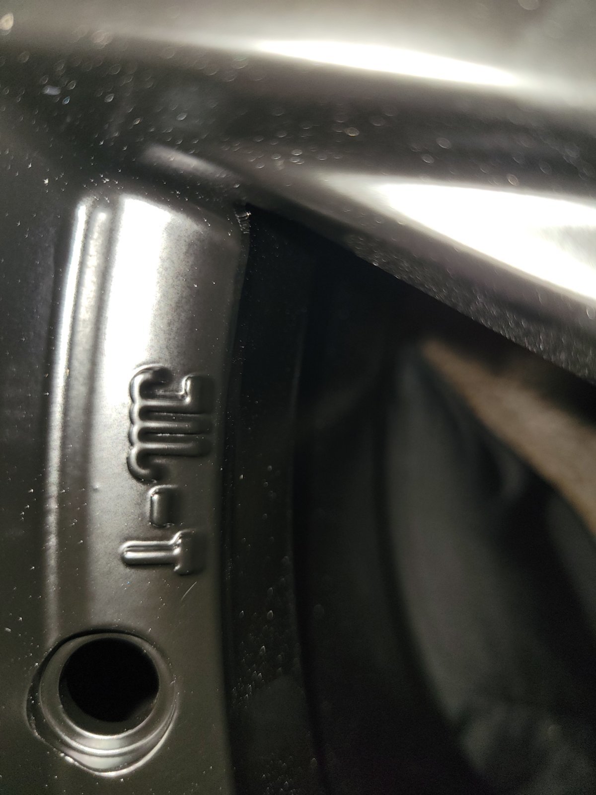

    Can somebody explain what the "m" like stamping means? I've seen it on several Japanese OEM wheels from previous Nissans, Mazdas and now our new Lexus.

    You mean this?
    That is JWL it’s the Japanese wheel testing standard showing that the wheels meet certain safety requirements.

    Thank you! For a while I believed it was Enkie's OEM branding.
