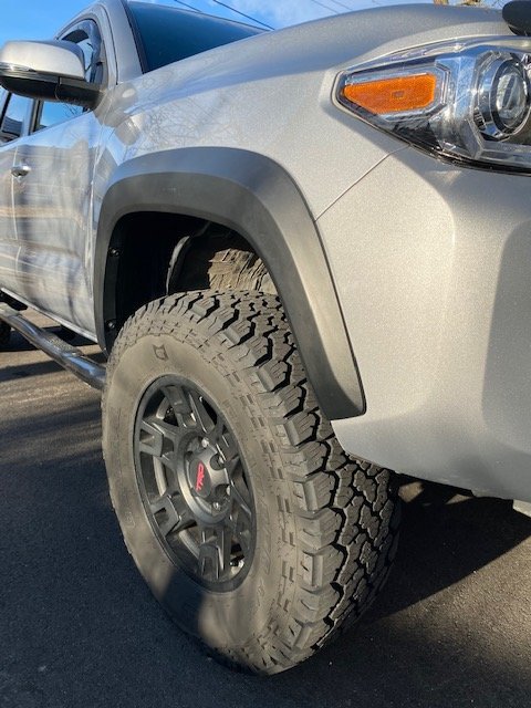

    Ive got this set up (bought the truck that way). Looking to get some negative off set. Has anyone used a 1/2 inch spacer, if so what did you do for lugs? Did you get E/T lugs?

    I believe that those wheels have a +9 offset. I have a +30 offset on my wheels but I run 1.25" Spidertrax wheel spacers and have been for the past 2 years without issue. As long as you use hub centric spacers (bora or Spidertrax) and torque them appropriately, you should be fine. I would not go past a -12 offset with those wheels or you will possibly rub on the cab mount with those wheels. .75" wheel spacers should work perfectly with your setup. https://www.amazon.com/BORA-Bulletp...=.75+bora+wheel+spacers&qid=1612646377&sr=8-3
