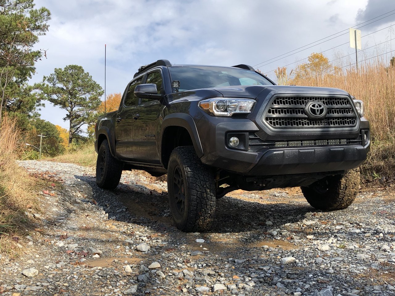

    3” lift 285/70-17 TRD PRO wheels 17x7
    Mine sits on pro wheels 285/70-17
    No rubbing at all
    I am sitting on a 3”
