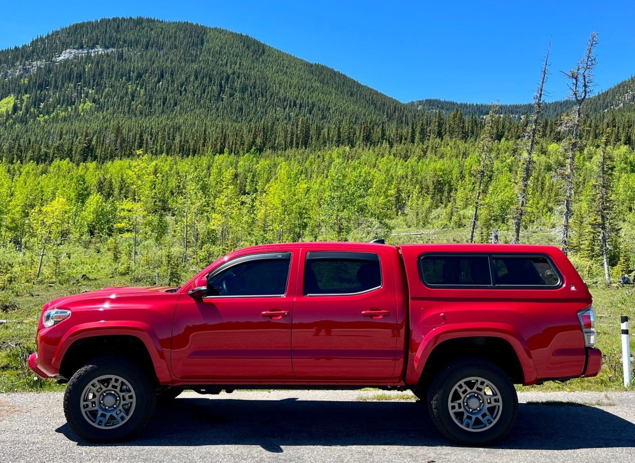

    Not at all, any rubbing issue would be due to larger tires. I have the gloss gunmetal Pro wheels and love them. With the offset they stick out about an inch further than the Sport wheels which looks great and aided in stability due to the increased track width.

    but isn't yours lifted?

    Yes, but it would not rub regardless of being lifted or not. I know guys un-lifted with Pro wheels and no rubbing either. Most rubbing issues come from extremely negative offsets.
