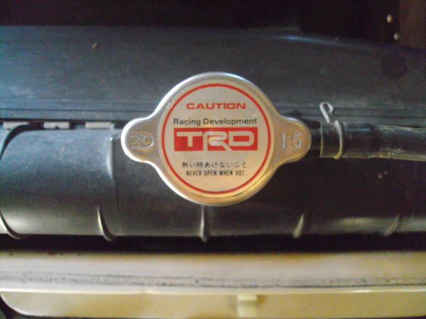

    dont know if it helps but theres a "15" on the right side of cap.. psi ??

    It's actually 1.5 bar which is 21.75 Psi stock is 13 Psi or .9 bar now you know lol

    No its not Bar its kg/cm this equals 18.5 same as stock. You can get a 21.3 TRD one

    I just bought one it's says kg/cm right in the pakage
