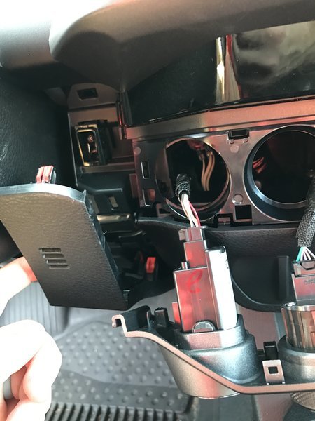

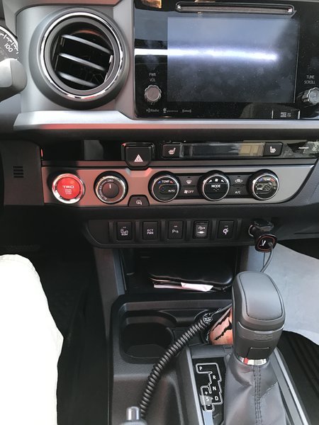

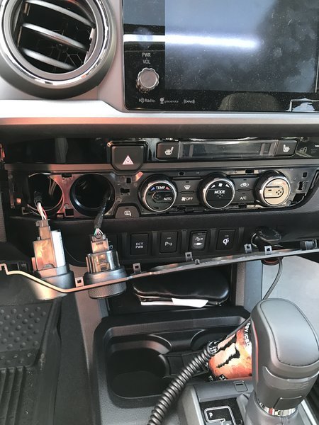

    Was there enough room to work by just pulling back the pieces shown? Or did it require you to remove the upper main dash trim pieces (cluster surround, radio surround)?
  7. Mar 18, 2017 at 9:49 AM
    #87
    Kennedyusmc
    Kennedyusmc [OP] Well-Known Member
    Sep 10, 2016
    #196950
    1,589
    Christopher
    2017 Cement Pro
    Still waiting for it
    I just pulled the lower steering trim loose on the right side, and delicately pulled the trim the button sits in.
    No screws, just a plastic trim tool and 3 mins
    FirstTacoma!! likes this.
  8. Mar 18, 2017 at 5:14 PM
    #88
    gordojames
    gordojames Well-Known Member
    Aug 19, 2016
    #194971
    47
    Jordan
    San Diego
    2017 DCSB OR 4x4 Super White
    As advertised. Popped the lower right side dash trim under the steering column out two clips down. Gently pulled the flimsy HVAC surround from left to right. The electronic HVAC controls stay put. Not sure of manual ones. I used the tool provided with my Clazzio seat covers but would probably recommend an actual angled trim puller to avoid pressure marks and scratches as I made on the inside of the steering column piece. Now I need a red hazard button. IMG_1178.jpg IMG_1179.jpgIMG_1181.jpg
