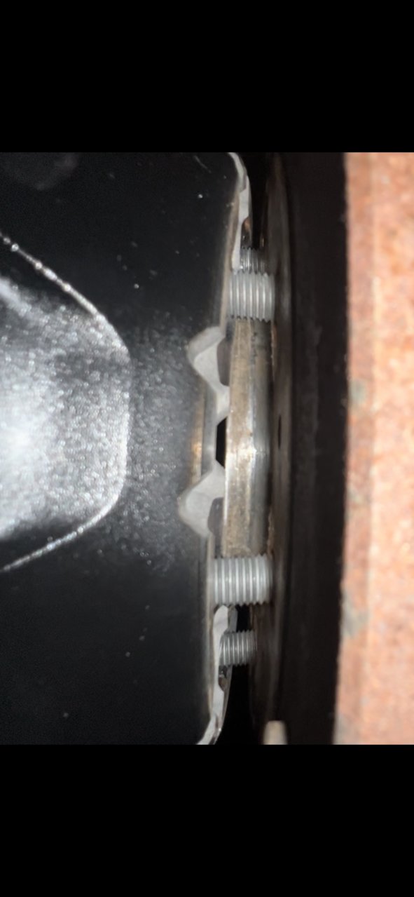

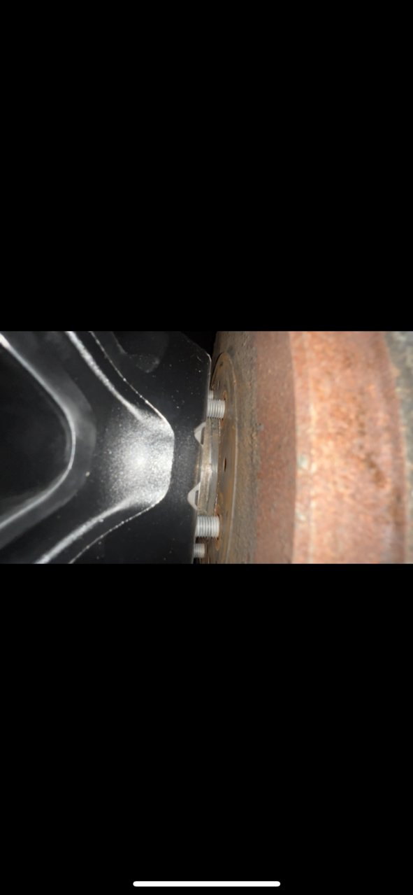

    Hi, I waited over two weeks to get my rims and they finally came in and my center bore did not fit the rim, there’s a few mm gap that doesn’t allow the rim to go on all the way..Can anyone tell me what might be the problem with the center bore and why it didn’t work on these OEM Trd rims when it worked out just fine for everyone else. What would be my options, I’ve seen multiple people with the 4 runner TRD rims on a Tacoma.

    For some reason the new 4runner rims are not fitting tacoma due to bore change. No one knows why it changed.
    You need to return them.

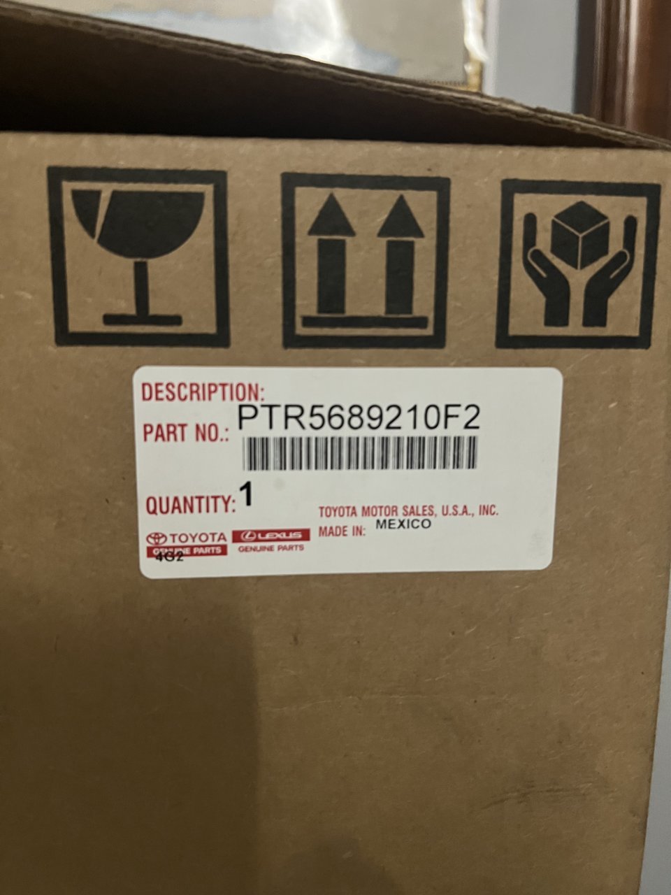

    Part # PTR5689210F2

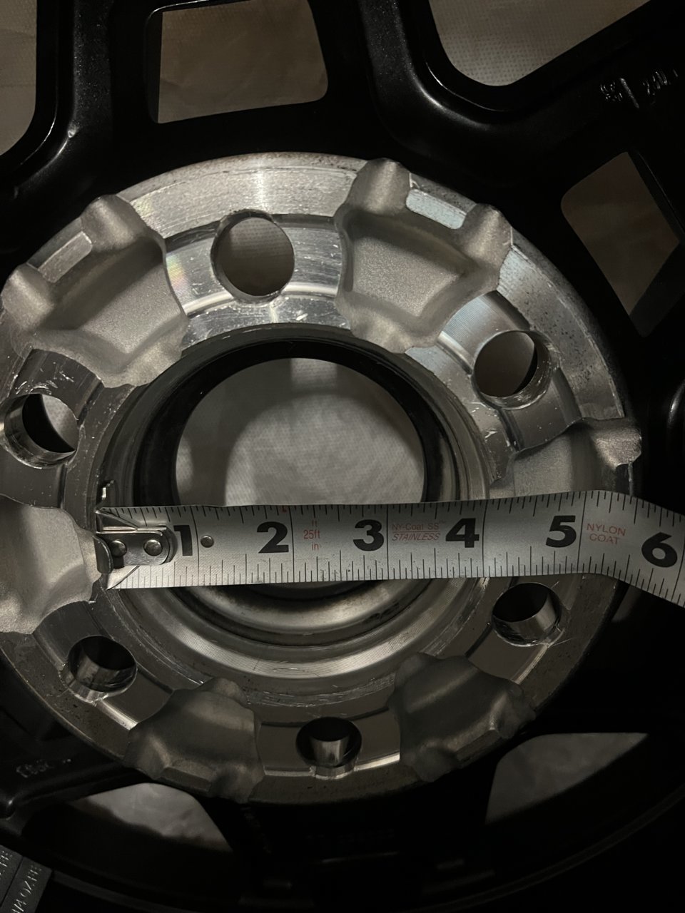

    Center bore measurement

    As per toyota parts these wheels appear to fit 2022 4runners only. No other models.

    If you really wanted to keep them you could always take them to a machine shop and have them make the bore bigger so they fit.

    So, is there a different part number that does fit?

    Thoughts on grind the center of the rim to fit? Seems like it’s less than a 2 mm shy.

    I wouldn't. wobble issues

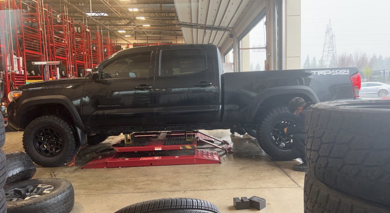

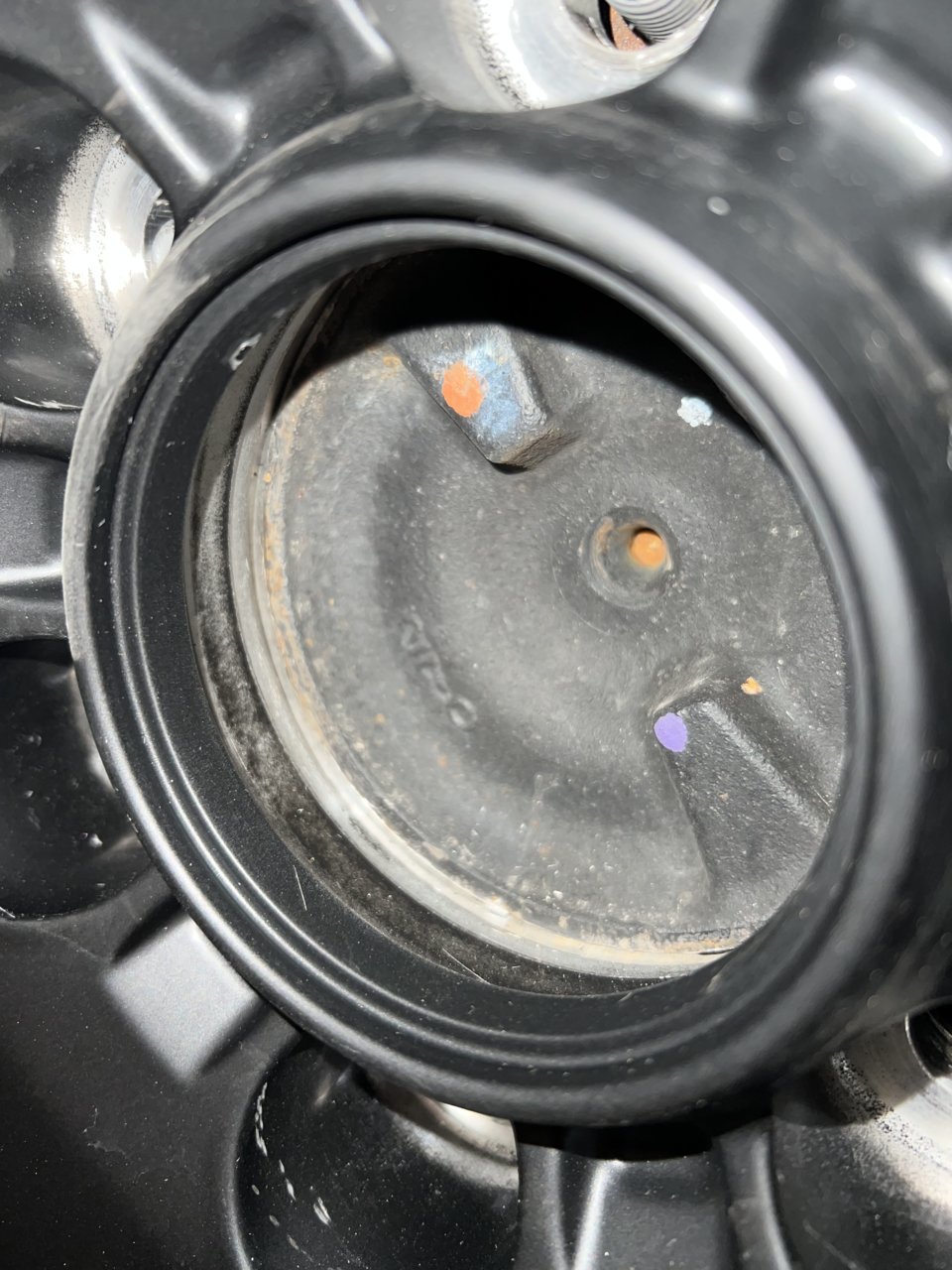

    Yeah I went to get them installed and they didn’t fit. They scratched the inside of my rim because of my certainty that it will fit because it’s OEM.
