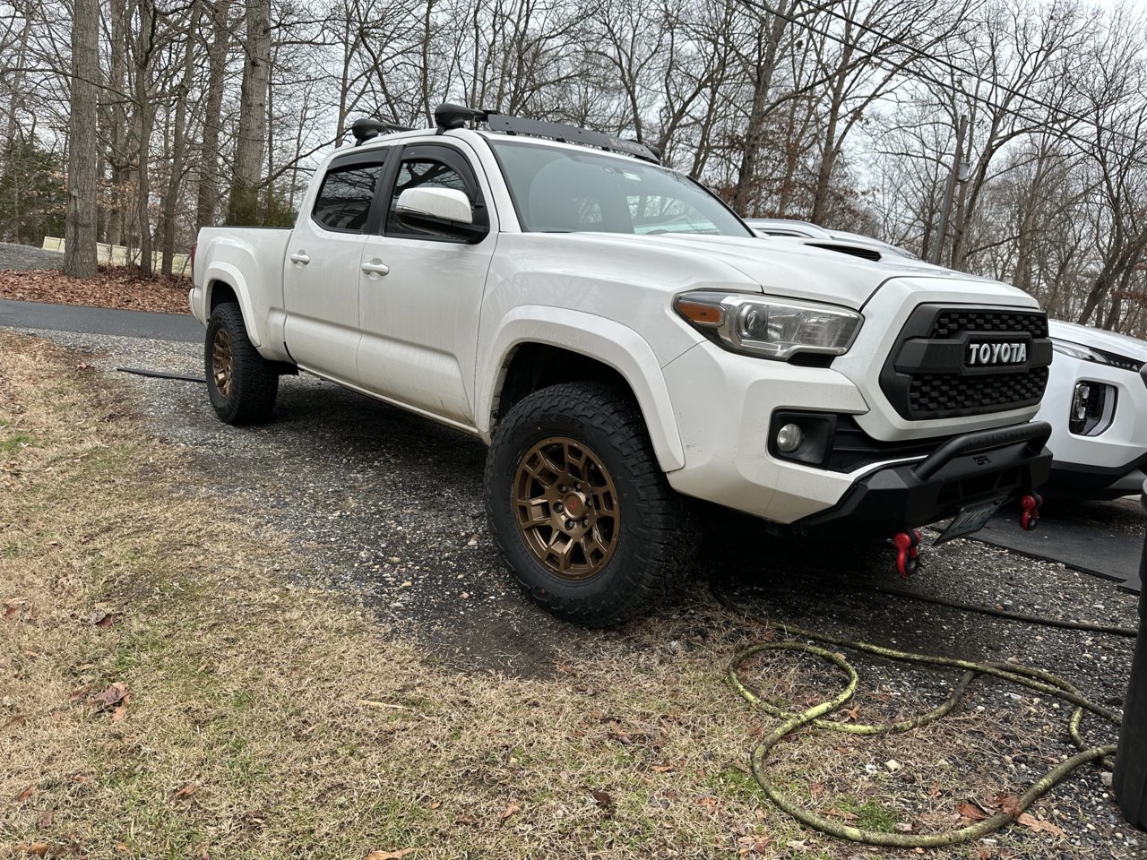

    218
    Southern MD
    17 Super White DCLB Sport
    TRD Pro Grill w/white letters Inno roof rack Body Armor Hiline Bumper TRD Pro Skid plate Full meso interior chrome delete Bronze AGP T4R replica wheels Falken Wildpeak AT3W tires Homelink Mirror Pioneer DMH-WC6600NEX head unit with Maestro integration A shit ton of crumbs and dirt in the back from my 2 little monsters
  16. Jan 18, 2023 at 6:49 PM
    #36
    Swaine
    Swaine Well-Known Member
    Nov 7, 2020
    #346092
    96
    2024 F-150 5.0 Lariat
    Clean! Looks like mine!
