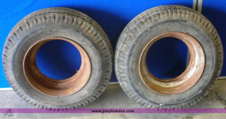

    I am continuously amazed when people don't know the difference between wheels and rims, and wheel covers and hubcaps.
    These are "Rims". They are used on mobile homes and some tractor trailers. lol

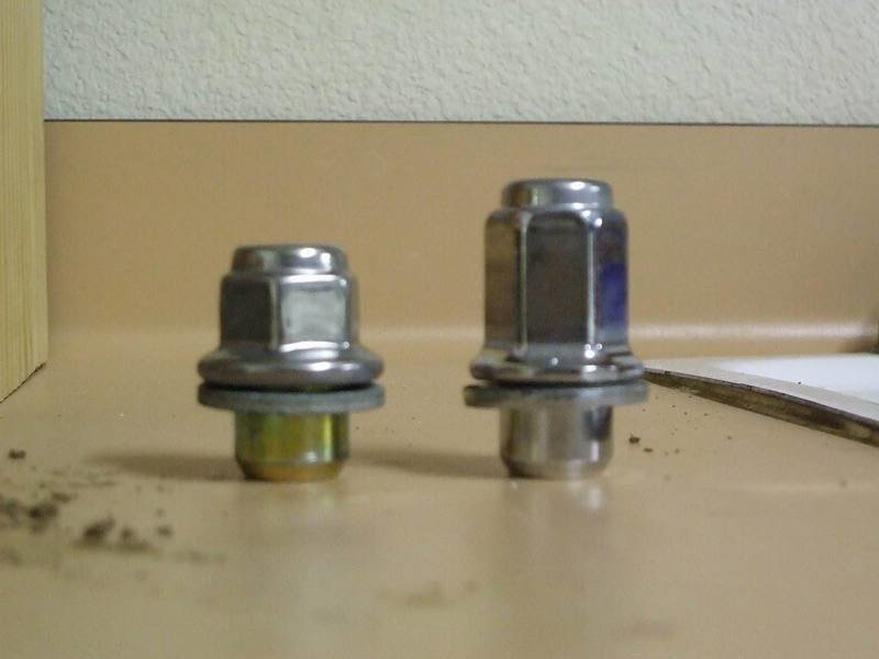

    Yes, he will need the shank type nut. There are 2 different length. That's just for aesthetics....they have the same thread engagement.
    Notice they are tapered at the bottom. That's to accommodate the steel spare wheel.
