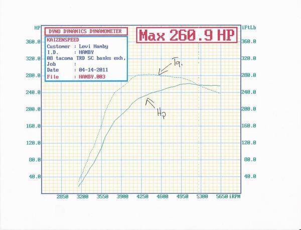

    Recently I installed my TRD supercharger on my 08 DC V6, so I decided to do a baseline Dyno run afterward, before I upgrade it. The Dyno was a Dyno Dynamics Dynamometer. Ambient temp 45 degrees, relative humidity was 30%. I made 3 runs with max HP just below 261 RWHP; all the numbers for boost and AFR were right around what Toyota claims the S/C runs at. My other mods are Doug Thorley shorty headers and Banks monster exhaust, when the S/C went on I kept the stock air box with an AFE Pro dry filter and no secondary filter. Has anyone here made any runs with a similar setup? If so, what were the results?
    I plan to install a custom Y-pipe, URD 2.825 pulley and a URD MAF calibrator later this summer. I’d love to see some Dyno sheets of similar setups if anyone’s got them, I realize this site is predominately for 4X4s so probably not a lot of people making runs. My run sheets are posted below with RWTQ, RWHP, Boost and AFR labeled for easy identification. My plan is to get above 300 RWHP and TQ, any suggestions? I think my current list of upgrades should do it though. I had no idea mods and upgrades were so addictive or I never would have started, by the way Boost rules, if you don’t have it, you should get it. Thanks in advance for your input or comments.

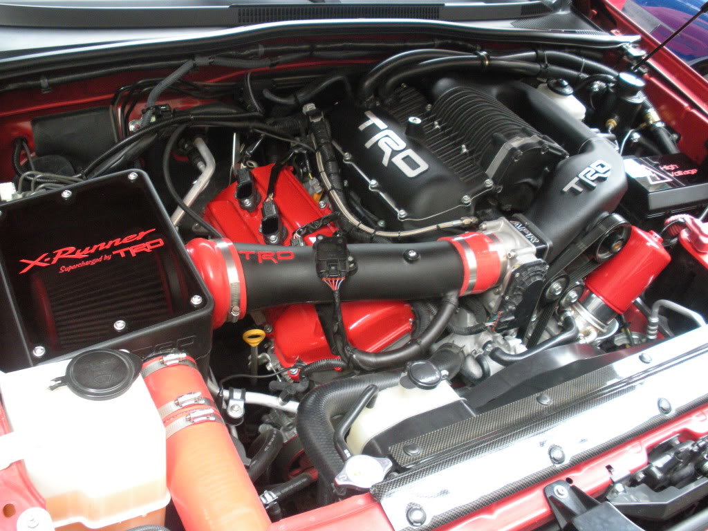

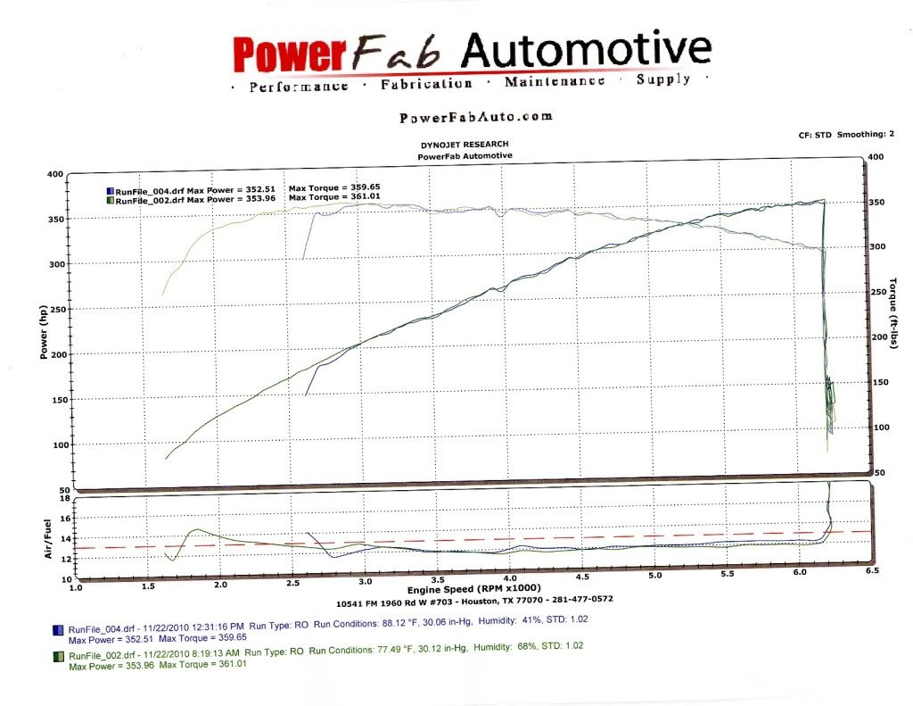

    Lots baby!
    353 HP/360Tq
    TRD S/C
    Full set of NST pulleys
    DTLT, URD Y pipe, URD 3" catback
    TRD CAI
    8 lbs boost
    APR X1
    APR 7th Injector
    Followed by a T56 Magnum 6sp and 4:10 gears.

    Wow that is running way to rich. The engine is drowning in fuel lol. Get the fuel mixture right and you should make a lot more power.

    ^ huh, he looks good to me. Hovering around 11.9/12
