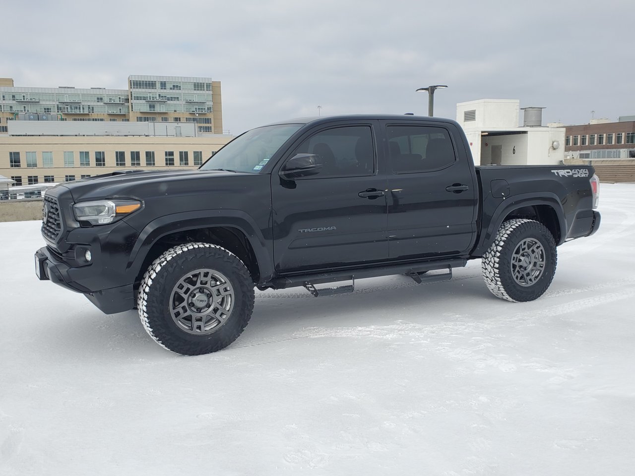

    I am running the Sema wheels and a 255 75r 17 with zero rubbing IMG_20210214_122929_541.jpg

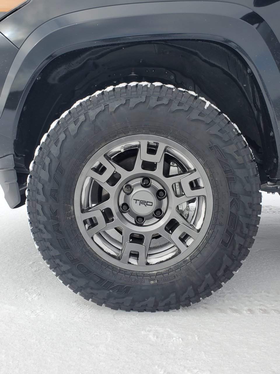

    I've got the Sema wheels with 265/70R17 Falken Wildpeak AT3W tires. No rubbing at all.

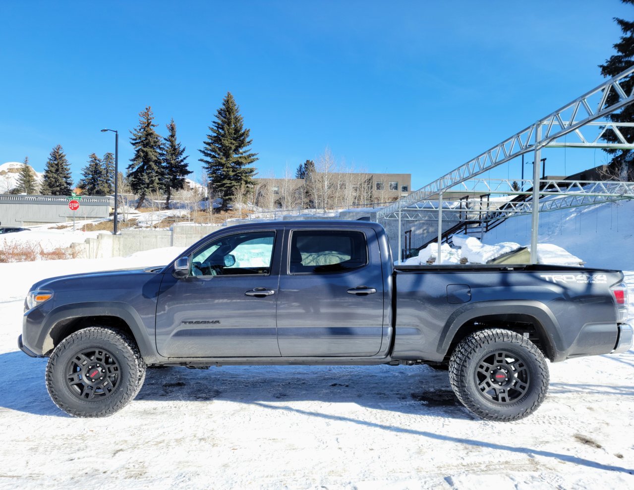

    Mine rubbed my front flaps, but otherwise you're good to go.
    This is at stock height, again, no issues rubbing other than the front flaps.

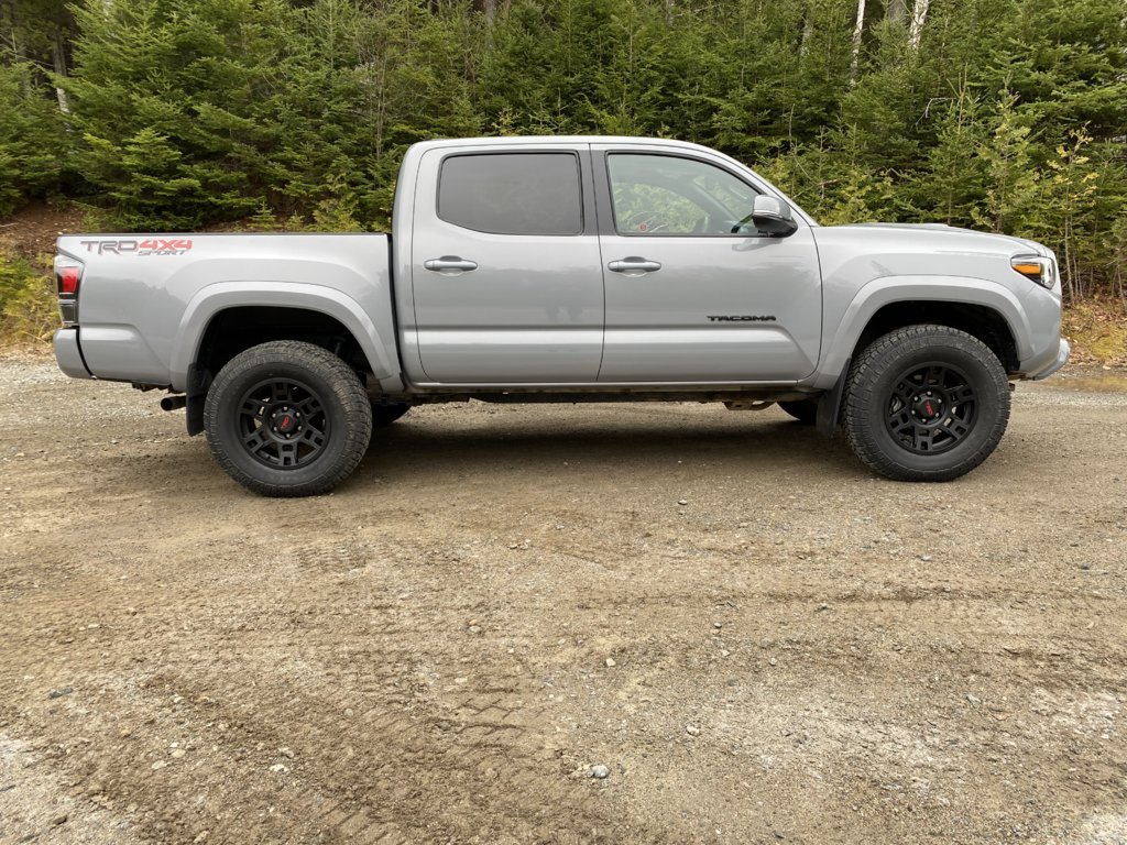

    at stock height, you may get a slight rub on the front, if you run flaps, while turning. you could have an alignment, adding as much caster as the stock parts will allow. this will give you the room you need for no rub. that is what I did. but, I added a 2" front, 1" rear lift, before I had it aligned. Ski

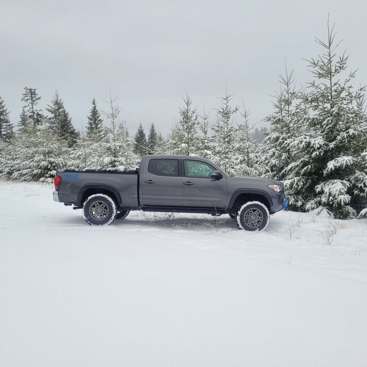

    I took my front flaps off, but didn't see if they rubbed... just assumed lol. But no issues, and they probably would fit - I have 255/80/17s

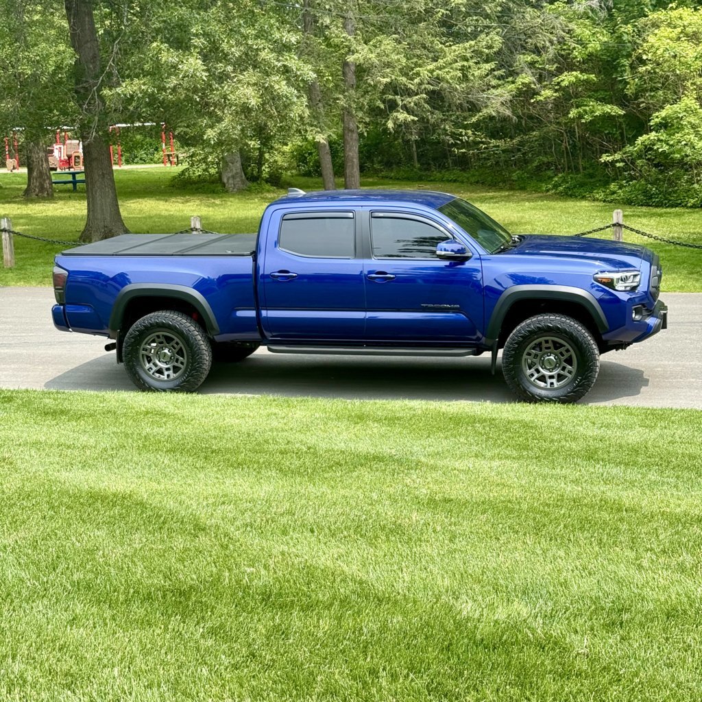

    285/70/17. 2/1 level. Slight rub on front oem mudguards. IMG_7566.jpg
