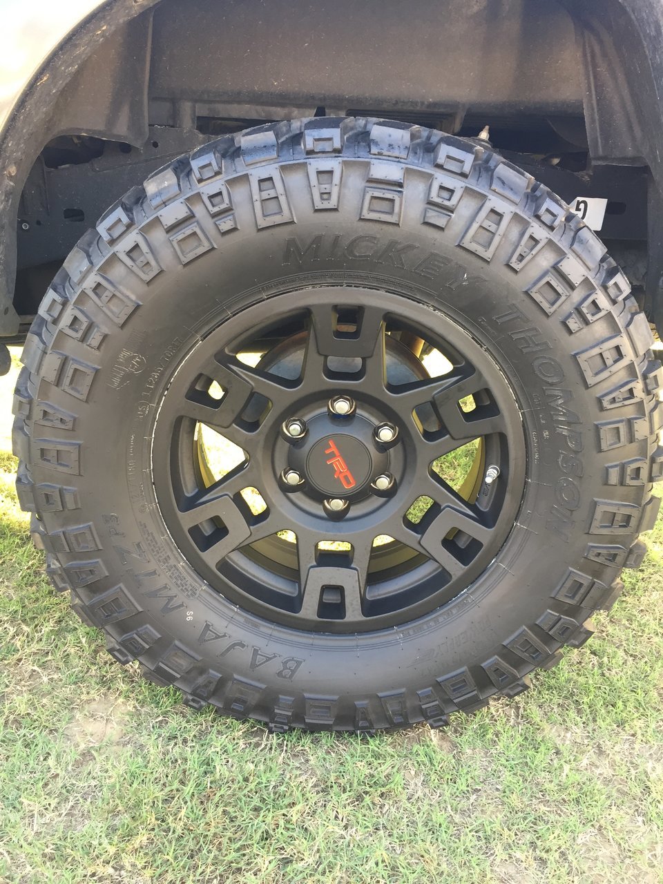

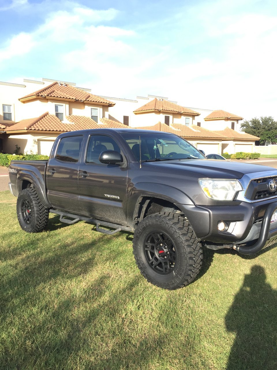

    Hey guys, just wanted to share this wheel & tire combination that I recently made. 285/70/17.
    Used to have BFG AT2 285/75/16 and ride was stiffer, truck feels way more flexible with this new setup, and tires are amazing. Very much worth their price:thumbsup:

    nice,, sidewall looks like my ridge grapplers..

    what your setup on suspension? any rubbing? have you flexed it? Also my cousin has had those tires on his jeep for about 40k miles, still has a good amount of tread left. Should last to 60k or so.

    Front setup includes:
    - Bilstein 5100's at "0" setting, 886 OME coils ( 2.5' lift )
    Rear Setup:
    - Trd Off road stock billies, will be adding in 5100's.
    Rubbing:
    - about 95-98% clearance. I did a trim on the cab mount, but did not chop it out completely. as well as removing mud flaps and trimming interior fender with a dremel.
    Not sure what flexing would be.
    Im in love with the tires! They are just something else, hope to have them for a long time!

    ***UPDATE***
    So after having these tires for about a month, I have felt/seen a significant decrease in MPG. Im getting 200-210 miles
    out of the tank before the low fuel light comes on.. Used to get 220-230 from 285/75/16 BFG AT's..
    Taking into consideration odometer tolerance with the new rims and tires. I did a 5-7% from the 225 miles I got on my last tank. I filled her up with about 18 gallons or so, did the division and got about 12.9 MPG, would get about 13-14 with other set of tires and rims, so not that far off as originally thought.
