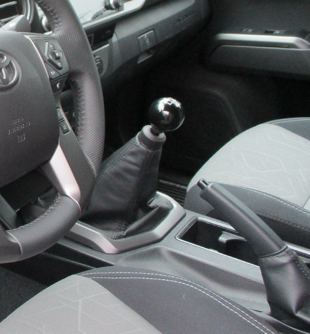

    If you can live without the "TRD" on the side, you can get a ball shifter knob from Core-Shifters (Brentwood, Tennessee). Mine (shown below) cost about $40. The 3D printed black cover for the chrome boot cap came from Etsy seller Trailbreaker Customs ($33).

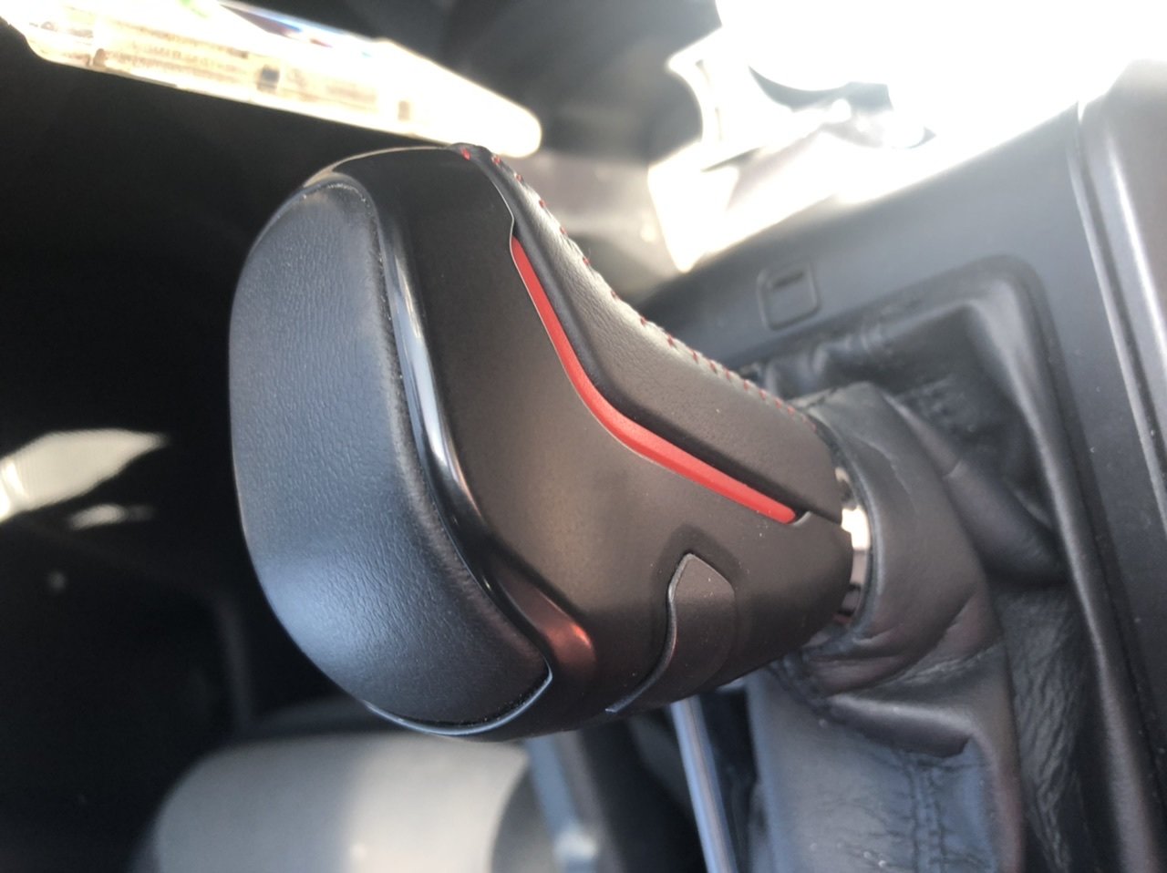

    Mines is for an automatic so there’s that. 23763FEC-CEDB-41C9-928F-6F4CA76DD6C5.jpg

    I would recommend using a thicker O-ring on the inside of the collar (I actually used a flat faucet washer, that happened to fit). The O-ring that he supplied allowed the whole boot to ride down too far on the shaft.

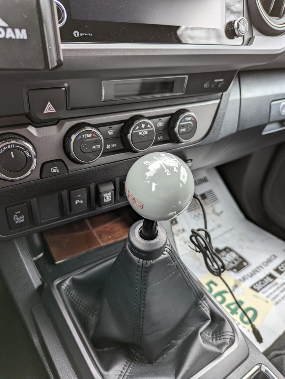

    Finally got it. The bay order was lost in the mail for a week but it arrived!!
    Ok so I tired the trail breaker plastic cap which didn't work well. It doesn't hold the bag down and I am curious how people got it to work. It was garbage.
    I had a rubber grommet, it worked wonderfully. Love the look and feel!!

    What size grommet is that? I need one. Looks great!

    The rubber grommet will work, but the whole purpose of the Trail Breaker cap is to hide the OEM chrome boot top without having to remove it. You have to give it a quarter turn clockwise to lock it into the chrome top.
    The problem in holding the bag (boot) down is that the shifter shaft is tapered, so any type of cap (including a grommet) will let the boot ride up to its natural limit. This can be seen in my picture, earlier in this thread. By adjusting the width of the O-ring, or rubber washer, inside the Trail Breaker cap, you can regulate the minimum height of the boot, but not the maximum. It will eventually slide up as far as it wants to go.

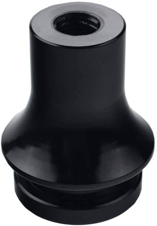

    I just went and bought this spacer piece, together w/the TRD 6-Speed Shift Knob from Amazon. Will post a picture when I get them installed.:
    Amazon.com: Dewhel Shift KNOB Boot Retainer/Adapter for Manual Gear Shifter Lever 12X1.25 (Black) : Automotive
    together w/the

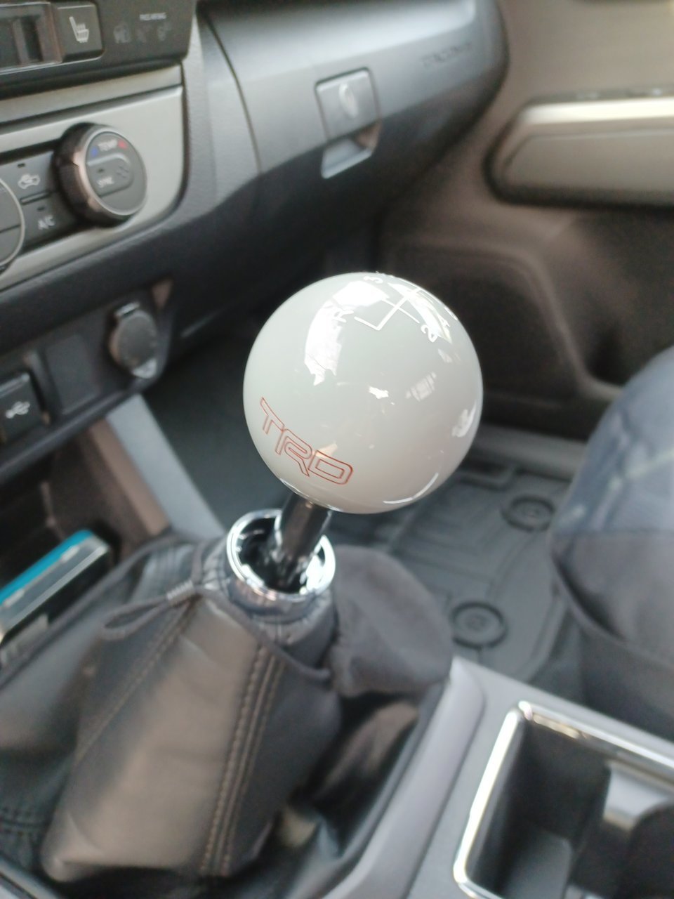

    I don't mind this setup; looks good and no rattle
