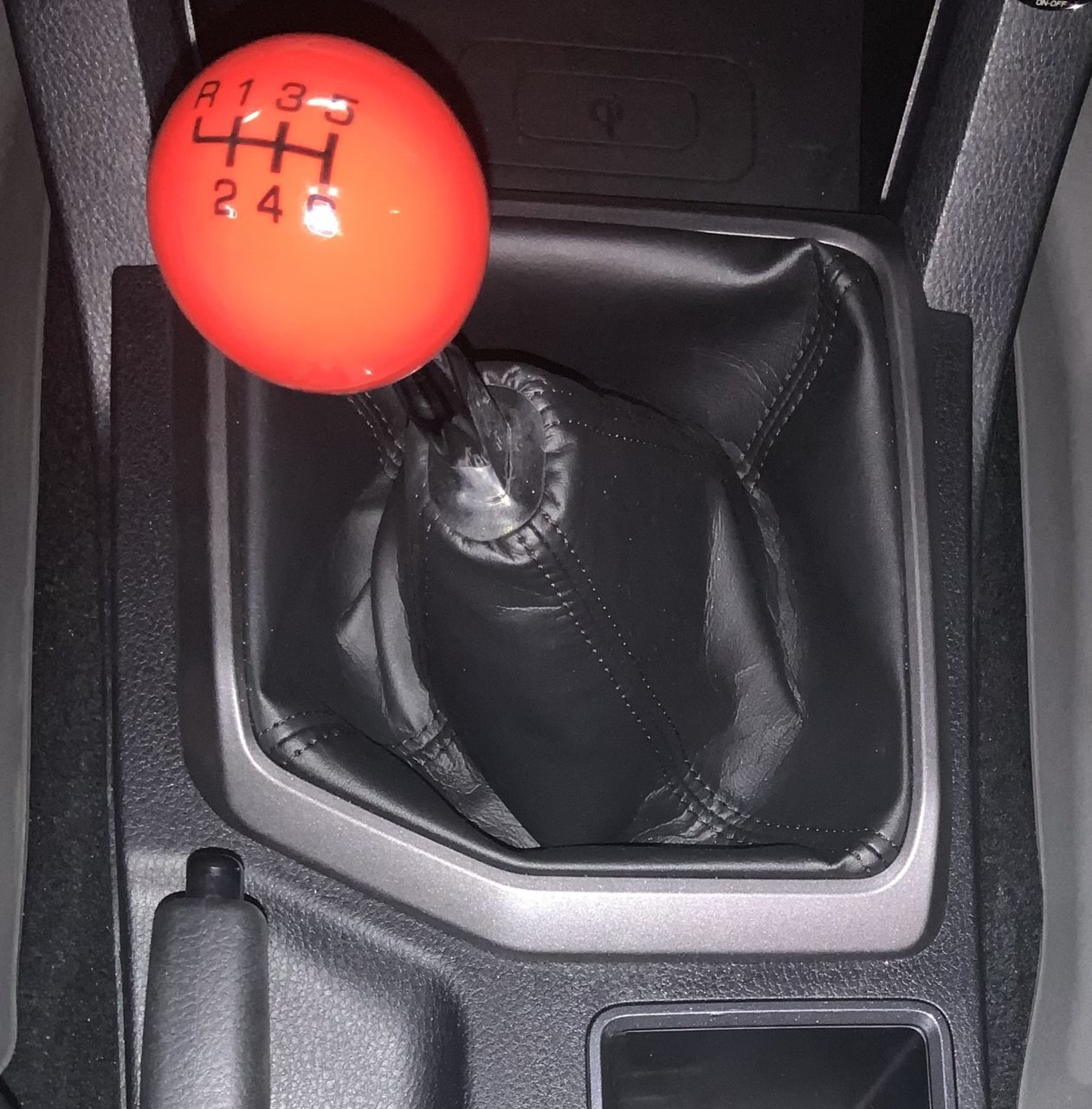

    Second thumbs up for the Core shifter, reverse becomes an intentional move, and the other six are actual gates. Install is straight forward, and very doable. Mine does buzz a little in 5th & 6th, but it’s an easy trade off for a direct link to the gear box.
