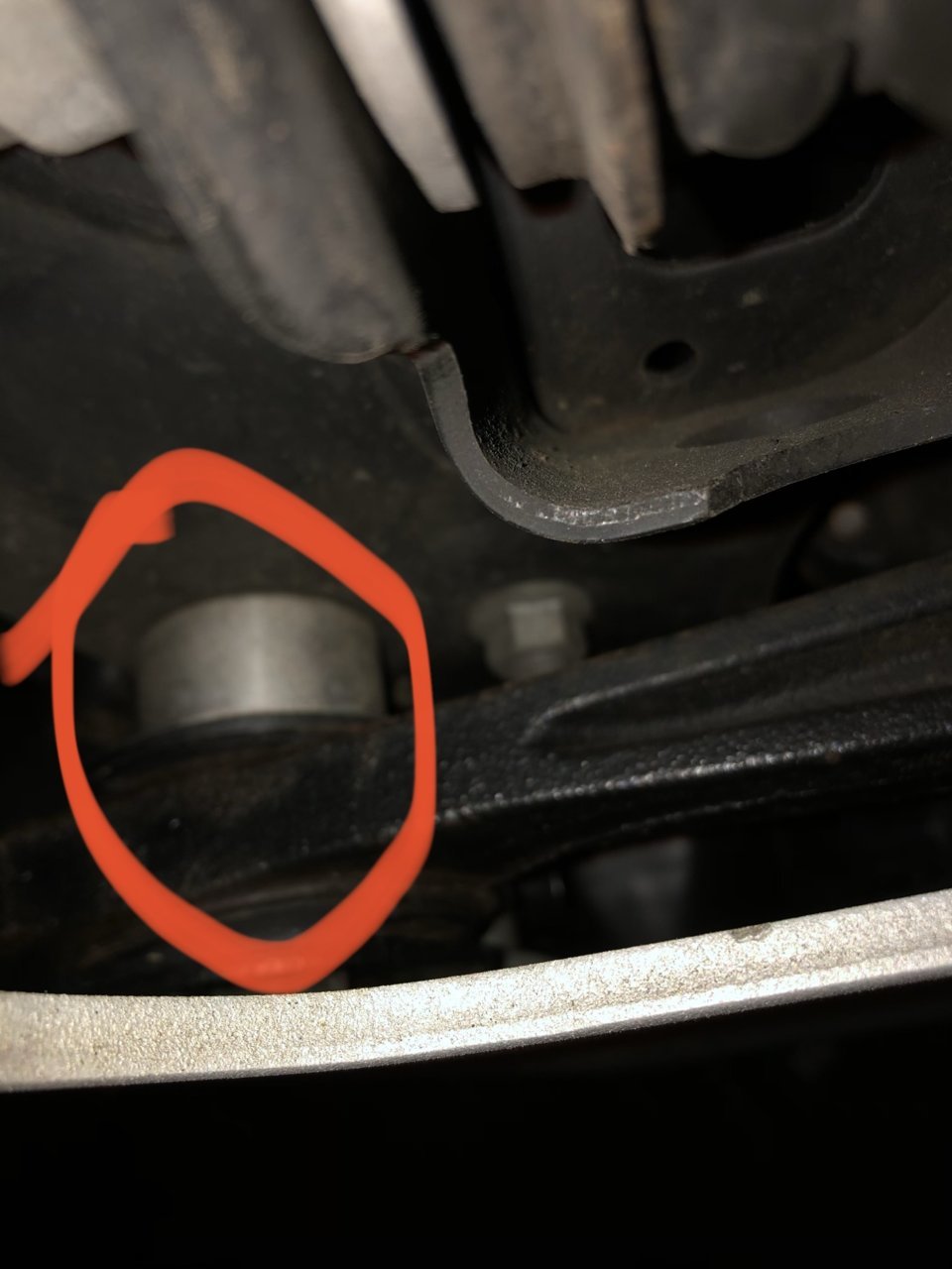

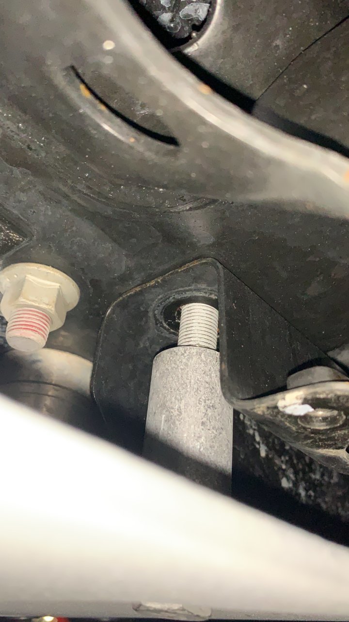

    What’s up guys. recently purchased a TRD skid plate .
    For some odd reason the middle bolts won’t screw in. I got the front and back just fine.
    Should I get new screws ?
    Or is there a trick to put it on?
    Thanks guys

    Pictures of the issue?

    You have a diff drop?

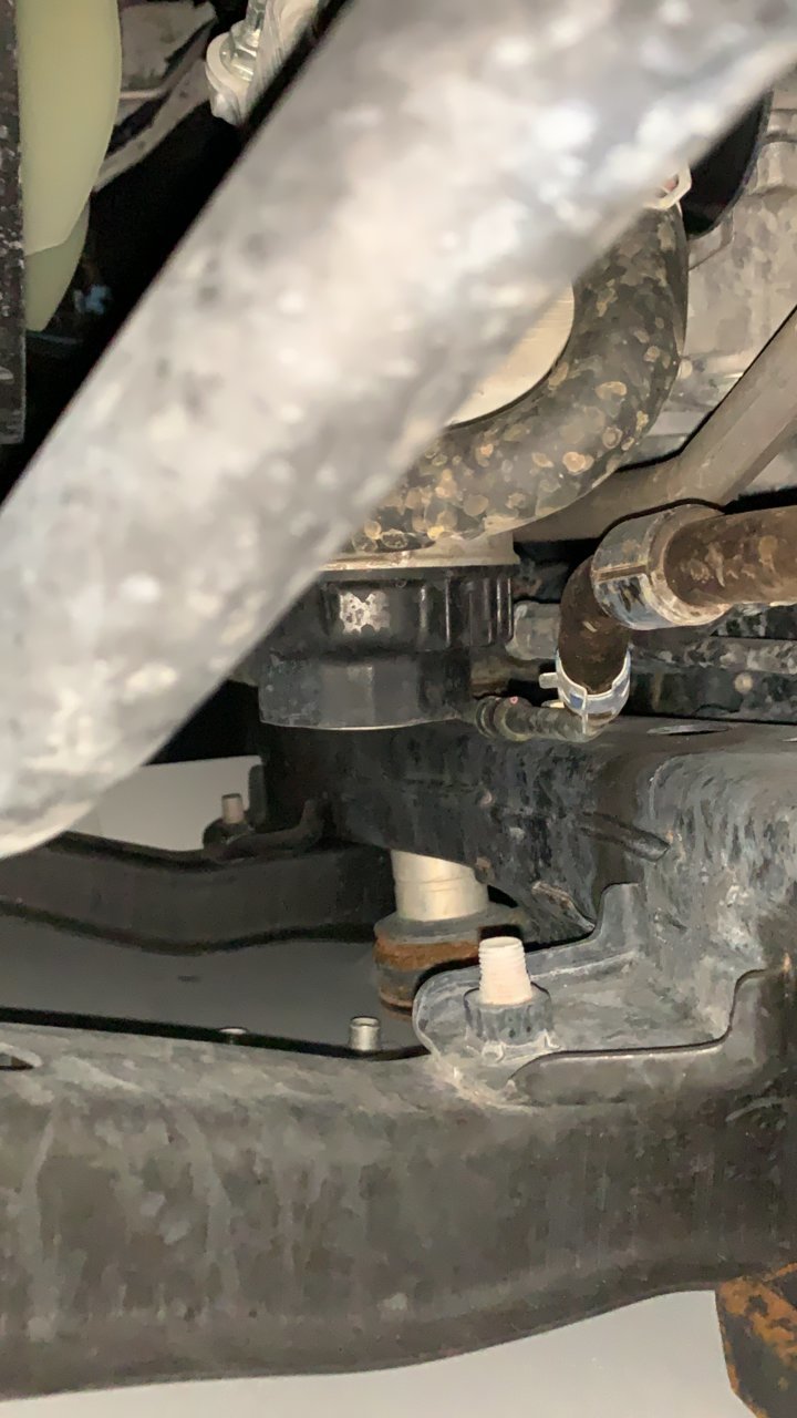

    It’s a spacer added to the mounting brackets that hold the front axle to the frame cross member...I see shiny aluminum in the photo you provided which leads me to believe you may have a diff drop which would explain why the skid plate won’t fit without persuasion as the center section of the axle is in contact with the skid plate see photo for clarity on diff drop spacer

    I think your right

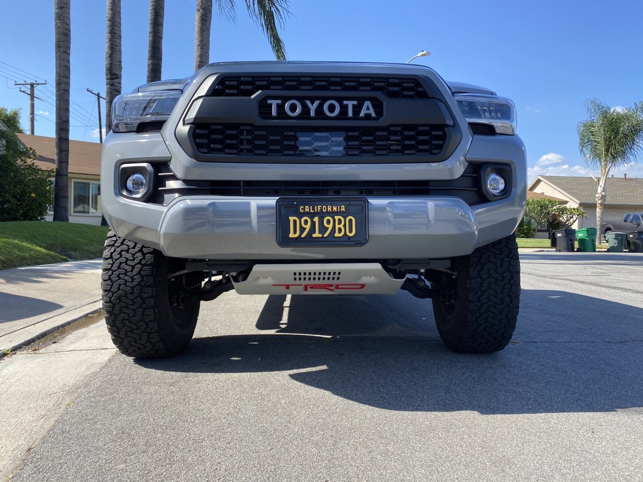

    That’s crazy I just installed mine 3 hours ago- no issue. All 6 bolts (4) 17 mm and (2) 12mm had been pre- screwed. I just used Hydraulic jack to hold on place/ line up . Started with rear Bolts and worked my way up.
    Good luck bro, hope it goes smooth for you with install. I had no issues on my 2020 and I know it’s same skid plate for all 3 generations.
