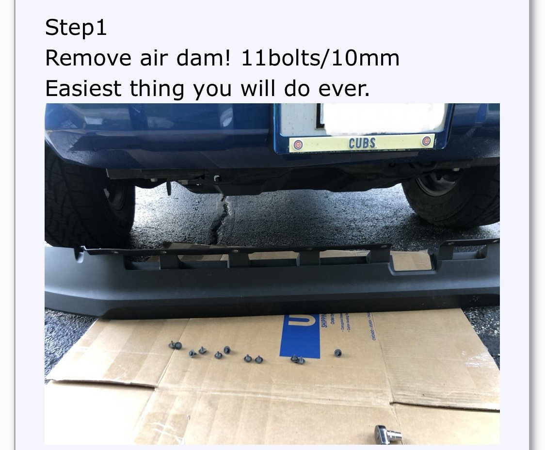

  11. Sep 3, 2021 at 6:34 PM
    Beezo
    Beezo [OP] Member
    Aug 19, 2021
    #374682
    8
    2020 Super White TRD Sport DCLB
    Finished the job, looks great and yes, removed the airdam! Everything fit just fine!
