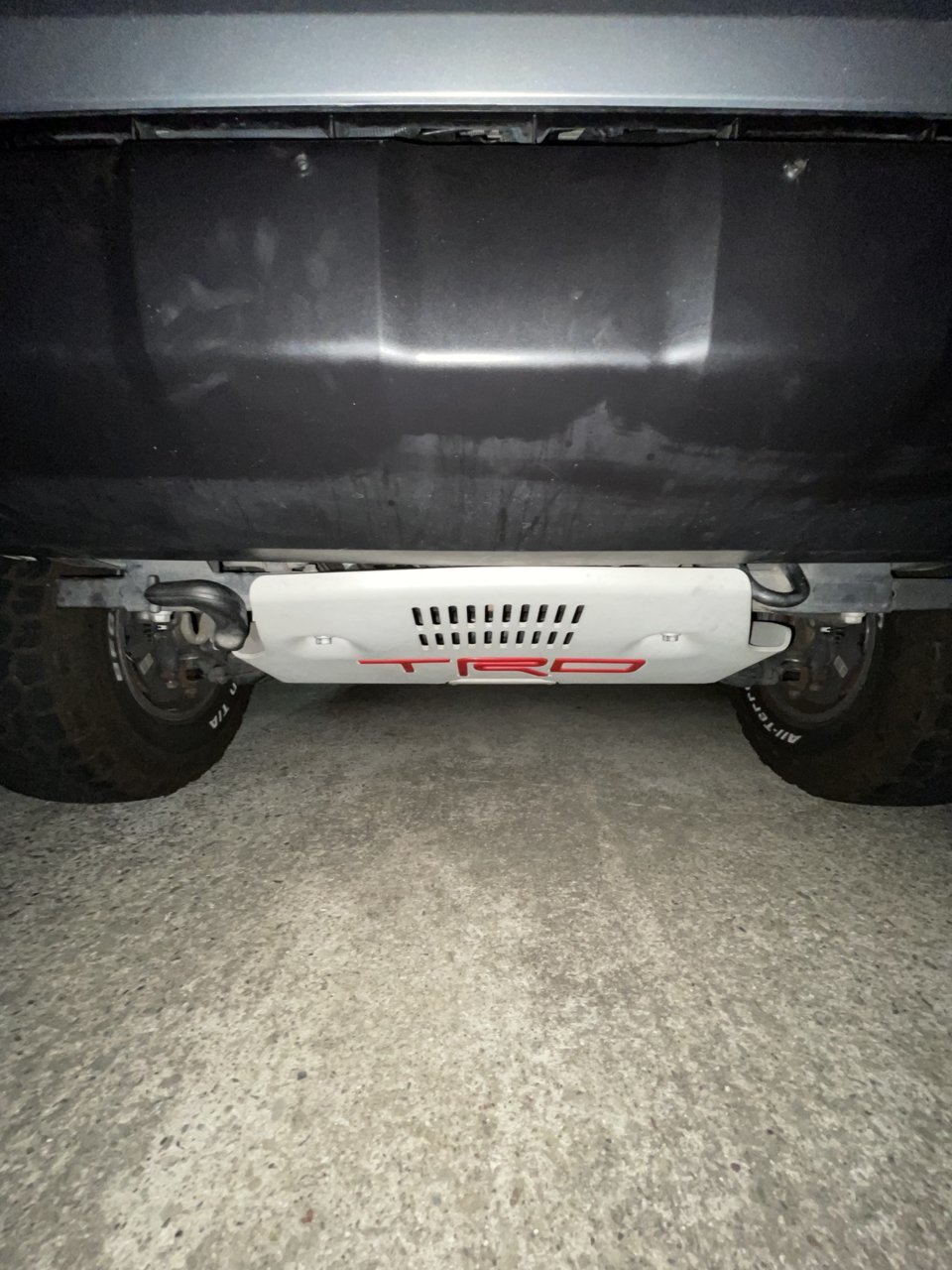

    Just installed a TRD Pro Skid Plate on my TRD OR, and after installation, it looks unaligned/bent.
    I’ve tried removing it completely and reinstalling, but still getting the same bent results. Any ideas why?

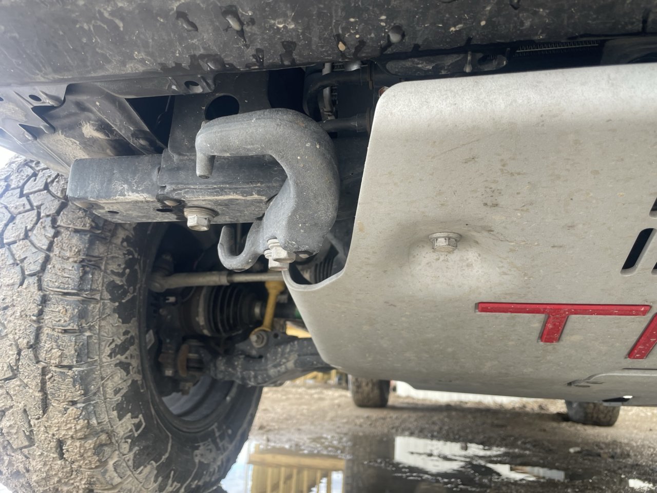

    Is the skid plate catching on the tow hook by chance? I've seen that happen with this skid plate before.
    If not, when you remove the skid plate, is it still bent?

    Looks like that front PS bolt isn’t even in the threaded hole. It appears to be angled slightly.

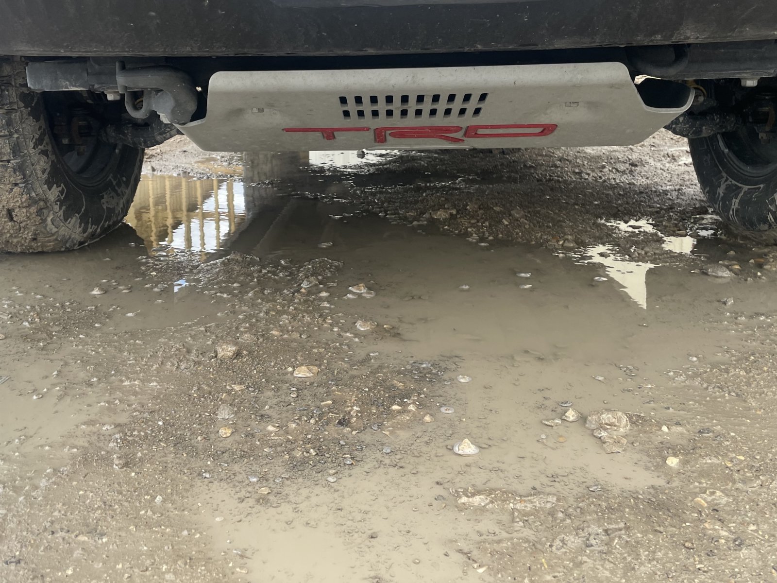

    I don't see how the order of tightening the bolts could possibly affect this. Is the skid plate caught on anything? If the frame possibly bent?
    It can be a bitch to install the skid just because the bolts all need to be threaded in a little bit at a time due to the spacers being clipped on which doesn't allow the bolts to move much vertically. However, I still don't see how order of bolt install could possibly tweak the skid like that. Seems like a physical problem with the truck or skid, or something the skid may be caught on screwing the install.
    Here are some pics of mine if it helps.

    +1 on the hook interference
