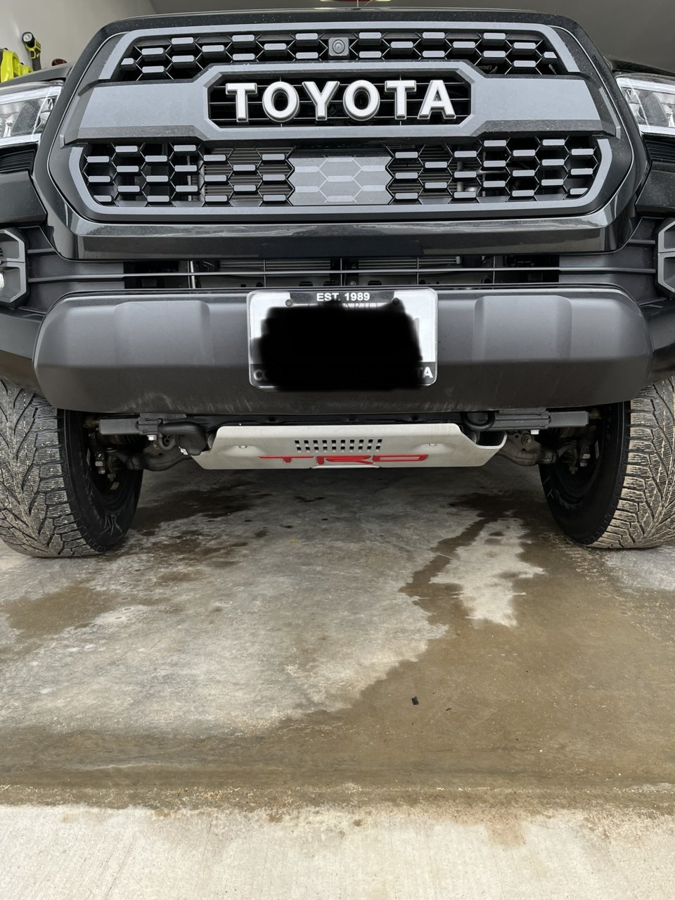

    There is no alignment procedure, it’s more a don’t cross thread the bolts and it will align itself.
    If the plate is not bent, the spacers are in correct locations and you have a ratchet with 17 & 12mm sockets you’re 99% done.
    I had my wife support the rear portion of plate, I started(by hand)the front 2, then the rear(by hand)2(12mm) it will hang loose on its own at this point. Now the center two bolts are up and recessed so I pushed up the plate and started them by hand. Torque them out, front/rear/center(same order as I began with).
    If you have something in the way(I can’t imagine what)then you either have the incorrect plate or have chosen the wrong holes to bolt into.

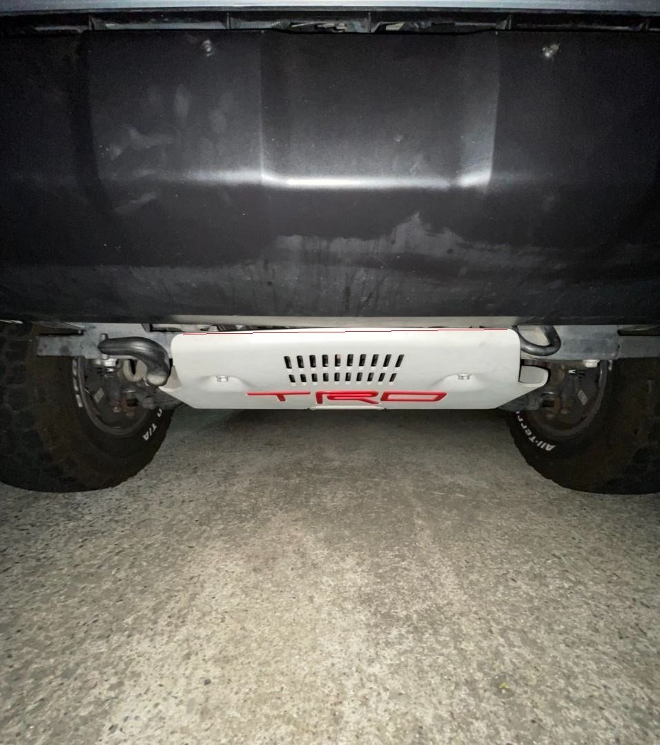

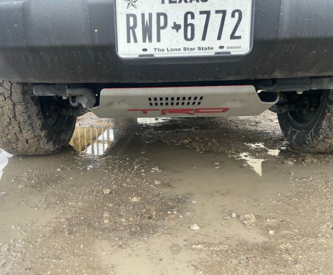

    From these pics it looks like you’re too high on the DS (missing a spacer or wrong spacer). Hopefully you get it sorted out. Here’s another pic for reference.
    shakerhood, ljerr2 and tonered like this.

    I think this may be right. I originally thought the passenger side was cross-threaded/not secured, but looking closer it does look like the driver side is drawn too far up. Not sure how, but I'd see if you're missing a spacer.

    I agree with the others, your driver side looks as though it's too high, which is why I suspected the spacers were swapped front to middle or side to side causing the awkward tilt. The passenger side looks like it's at about the right height, the driver side appears to be wonky.

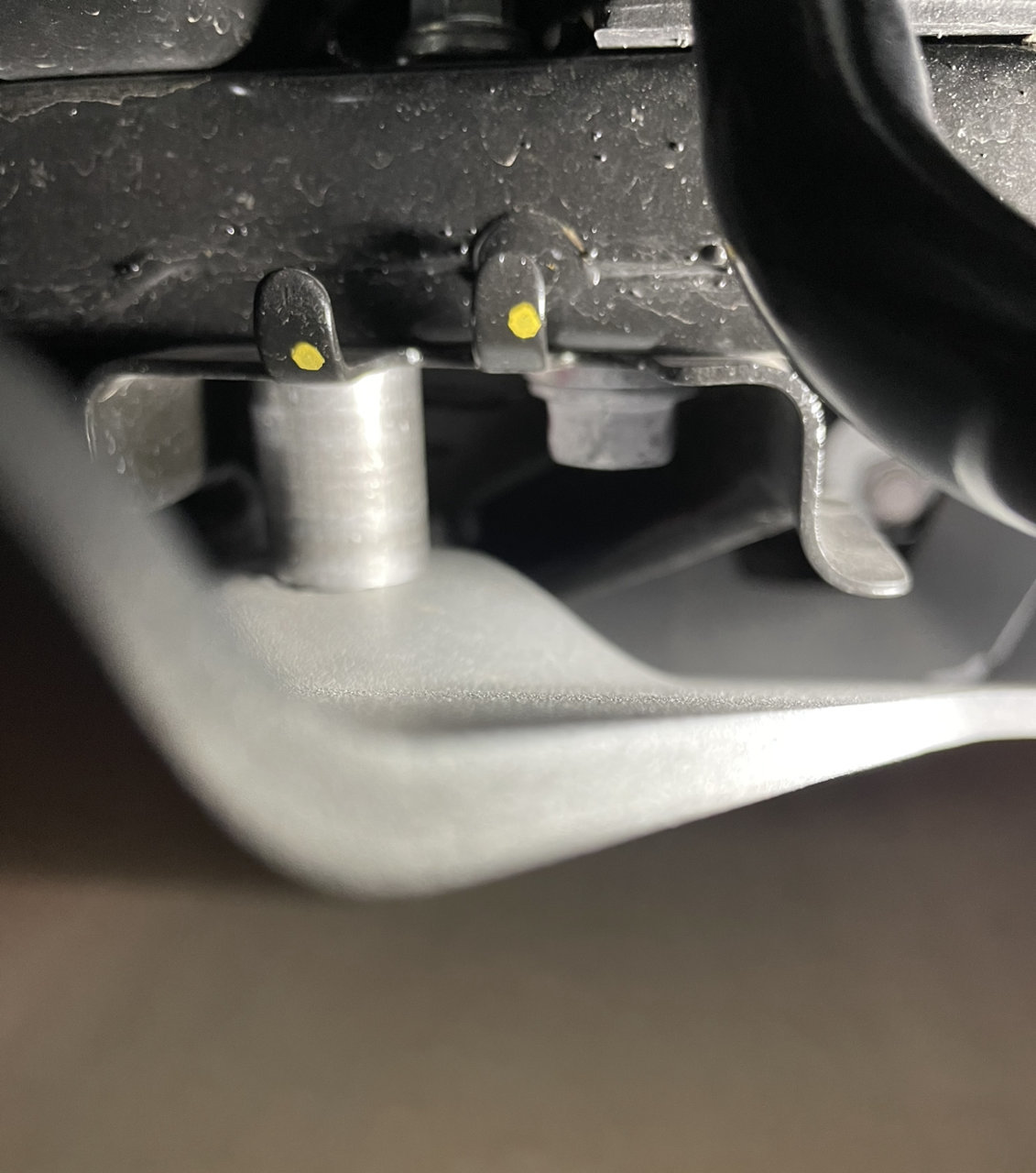

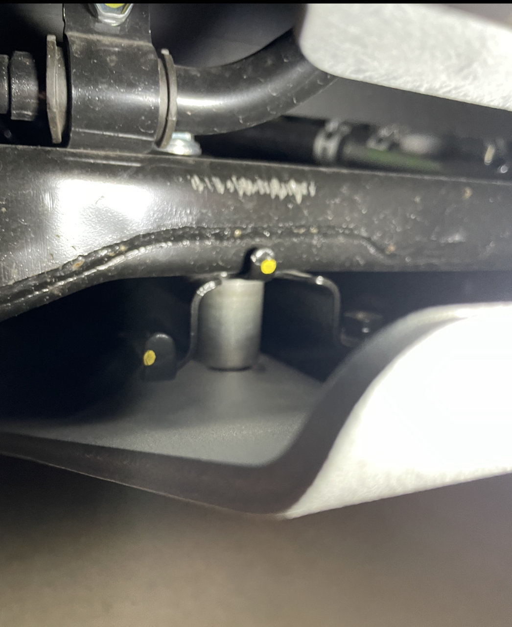

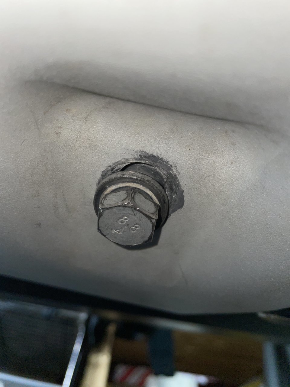

    Just looked under, can this be the problem? That is the bolt for the front passenger side. That’s how the bolt looks, and it’s tightened all the way. I also checked to make sure the spacers were all in the proper spots, and they are.

    That bolt is jammed against something, not in the hole it’s supposed to be in.

    I just unscrewed the bolt and screwed it back in. Same placement, only one whole on that side.

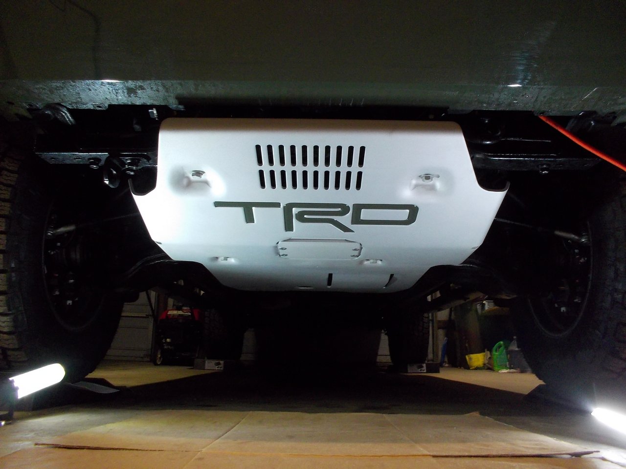

    That skid is bent if you have the correct spacers on the front.
    It should look like this...

    From your first picture in the thread it looks like the front passenger bolt is not in right. It looks to me like it is at an angle, maybe cross threaded.

    That's what I was thinking. If you have the spacers in right then I'd check the bolt length to make sure you have the right bolts in the right places, there are two long and two medium length bolts.
    The large bolts (longer length bolts) go with the large spacers for the middle holes. The medium bolts (medium length) go with the small spacers in the front. Small spacers and a long bolt could leave you with a bolt that bottoms out before it's tightened all the way down. Have you pulled out both front bolts and compared them side by side?

    Most likely cross-threaded and bottoming out.
