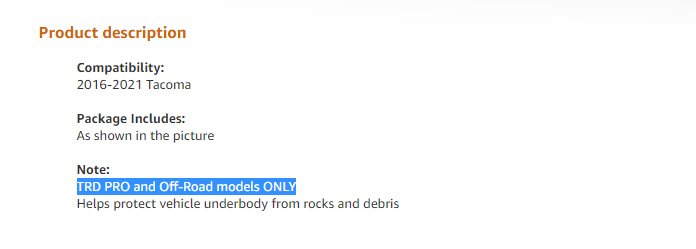

    Yes, it will fit your sport. I have one on mine. You will have to remove your front air dam for it to fit.
    They are telling you it doesn’t fit your tuck because it’s an OEM part for a PRO.

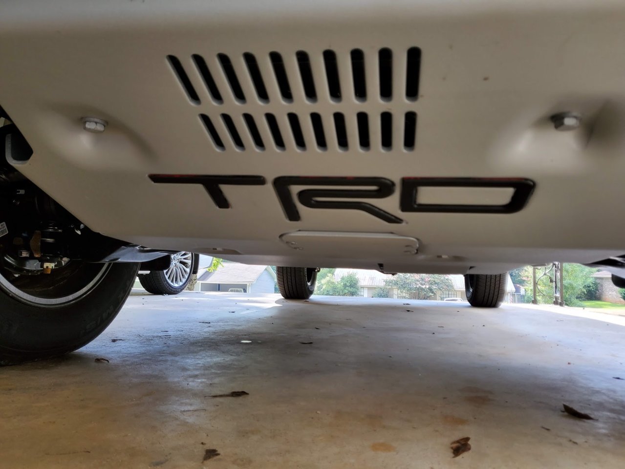

    Check with your Toyota dealer. Mine will price match and if it's not in stock, they can get it by the next day (If it's not back ordered.) List price is $400 before any discounts.
    I was lucky enough to fine a used one but I can attest that it doesn't bang or clang.
    (Painted the letters to match the truck.)
    I'm 72 and put mine on by myself. If I had a friend to help it would have been worth a case of beer. In my opinion, that air dam thingy is just for show anyway.

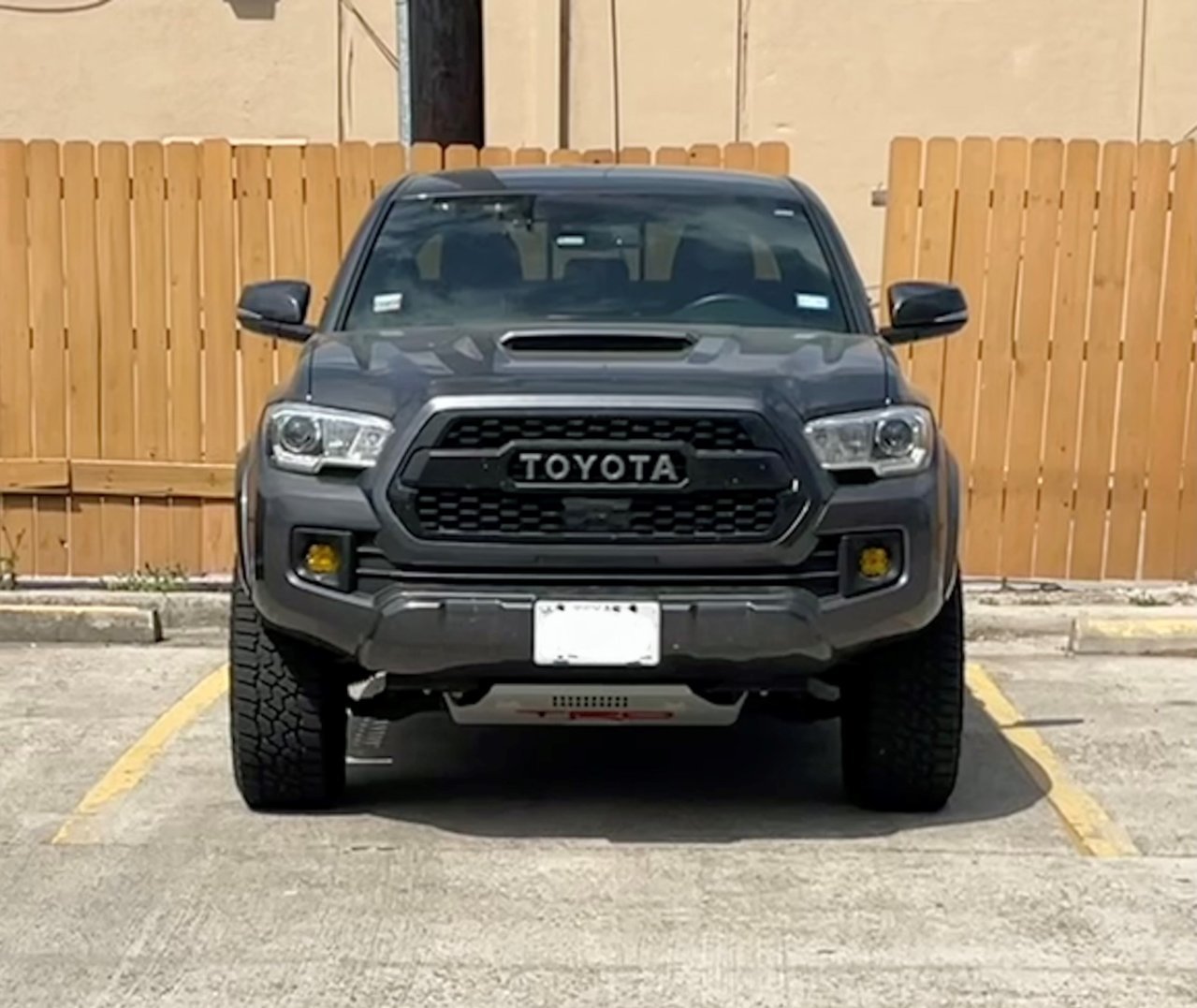

    Here's my 2018 TRD Sport with the skid plate. I bought mine from Glen Mills Toyota for $340 with free shipping.

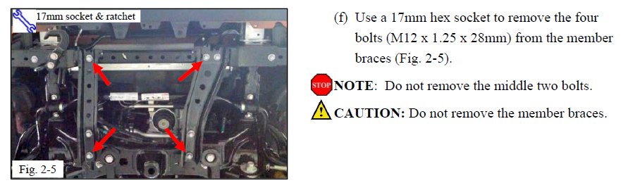

    Props on the black paint. I did the same.
    It looks like the spacer is visible, which would indicate that you removed the Member Braces?
    I did the same when rushing the first installation. Replacing them might quiet it down? Mine is silent even though I find all kinds of stuff loaded in it when I drop it for oil changes.
