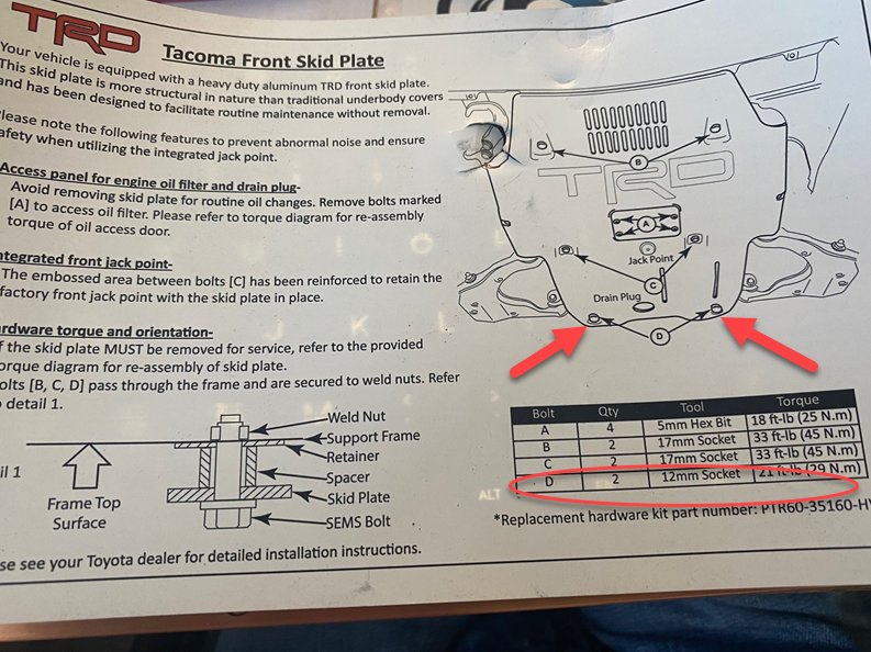

  13. Sep 28, 2021 at 4:40 PM
    #73
    retrofive
    retrofive Well-Known Member
    Jul 31, 2021
    #372739
    307
    Ok upon opening it up, there was no 12mm for the "D" bolts included or missing during shipping. Read the full PDF on install and the simple card that came with it.
    Do you reuse the 12mm that you remove? or are the different and actually missing?
    I see the part # for replacement. Maybe call BAM?
  14. Sep 28, 2021 at 6:02 PM
    #74
    gudujarlson
    gudujarlson Well-Known Member
    Jul 2, 2019
    #298083
    7,417
    Minnesota
    2020 TRD Off-Road DCSB 6MT
    Kings, Dakars, SPCs, 33's, Mobtown Sliders, TRD Skid
    It’s a skid plate, d00d. It’s supposed to get all messed up so that your important parts do not. Do you worry about the powder coating on your nut cup? :)
    Regardless, being aluminum and powdered coated it’s going to resist corrosion better than just about anything. Mine’s all beat to crap, been through 1 Minnesota winter, and corrosion is non-existent; not that I inspect it with a microscope.
    I’ve been living in minesota most of my life and I have never seen significant corrosion on an aluminum wheel. Worry about your steel parts; and your soft parts. Always use protection.

  15. Sep 28, 2021 at 6:09 PM
    #75
    gudujarlson
    Jul 2, 2019
    #298083
    7,417
    Minnesota
    I don’t remember the exactly, but I remember reusing the small hardware in the rear. The front attachment point is different and has beefier hardware.
    retrofive[QUOTED] likes this.
