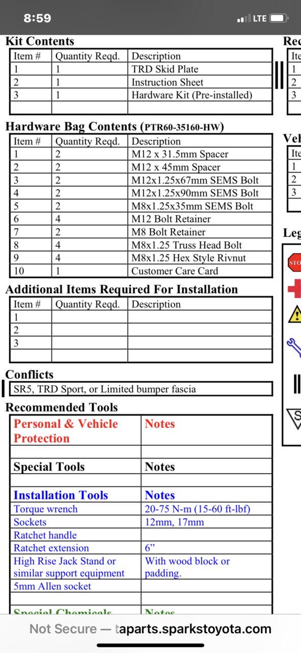

    Does anyone know the length of longer spacers? I lost one…

    If you lost one but not all wouldn’t you just measure one you still have? I dropped mine a couple days ago to do the diff fluid but too lazy to drop it again

    You are not wrong.
    It’s just I don’t wanna take off my skidplate twice. I also stripped a weld nut that the skidplate bolt screws into… So will be a fun weekend:)
    I actually found the bolt/spacers specs here:
