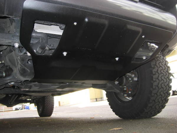

    Sorry to crash the party here, but I didn't realise there was a difference between a TRD skidplate and a non TRD skidplate. Pics maybe?

    heres a pic of mine before i painted it i left the stock and put this one over it.... well actually under it but you get the idea

    2011 Tacoma TRD OFF ROAD 4X4
    Here's mine painted black...but you can see that the factory plate is still up there.
