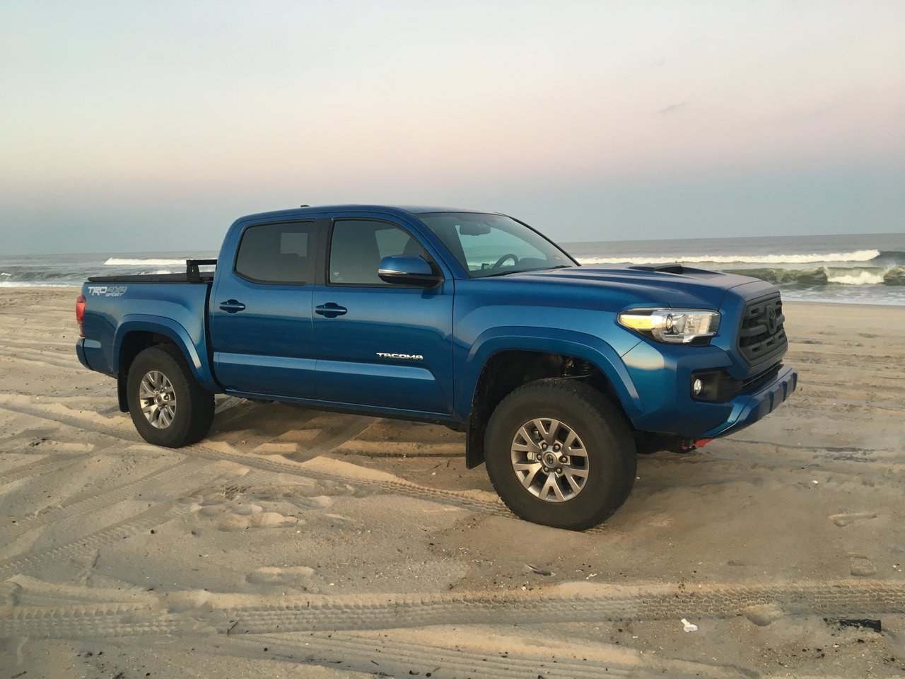

    I went from a 16 access cab SR5 to a 17 Sport.
    I had the 5100s on the 16, set to 2nd notch, and had a nice level sitting truck.
    Went I traded to the 17, I left the height the same, but gained about a 1/2” extra lift over the SR5, which I suspect is due to the beefier coils.
    I honestly preferred the ride of 5100s and the SR5 springs over the harsher Sport springs. It’s not bad at all, and it is definitely more controlled than on the stock shocks. I just prefer a softer spring rate. I’ll be swapping for a set of Doninsons or OME’s eventually.
    I’m 50/50 on lifting the back an inch to match or go down a notch on the shocks to get the leveled appearance I initially wanted on the first truck.
    (Nice color choice)
