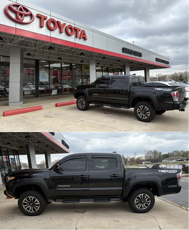

    OMG!
    Jan, the lady who processed the paperwork for the Loaner was impressed with my 3rd Gen.
    She liked the "shiny bolts around the fenders", as she put it.
    When we did the walk through/inspection of the Loaner, I told her about the automatic lift gate...she was impressed and happy that I brought it to her attention.
    I truly like the fact my set-up looks out of proportion...makes it look very unique...up until I get new Wheels/Tires.
    I was thinking 275/70R17s but seriously considering 285/70R17s.
    Not really interested in going any larger than 285s but I get reminded by another truck guy to go with 33s.
    I will enjoy the firmer ride...definitely feel the difference in these Bilstein 5100s!

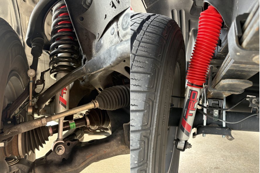

    Lovin' the Drive to Work on a Friday!
    My Sporty is handling those turns much better now...very noticeable.
    I went to Lowe's again for some Top Soil (20lbs) 10 Bags + 2 small bags of Weed/Feed (15lbs) .
    The back end went from 23.25" to 22.5" measured from center of wheel...with roughly 230lbs on tail end.
    Front pretty much stayed around 22.5".
    The drive with weight was definitely much better with the new suspension.

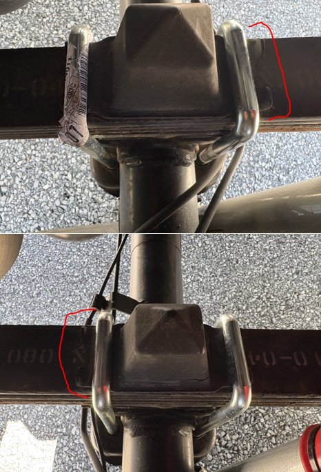

    Welp,
    Not sure how much this picture proves why my braking felt different...
    In any case, I am having this corrected tomorrow.
    The U-bolts aren't seated properly in the bracket thus creating a wear point instead of sitting flat and carrying an even load point.
    You can see where there is a curved winglet to seat the U-bolt. 1EA per side was not seated properly.

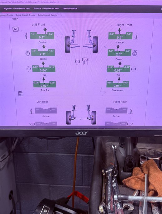

    Arrived at dealership about 10:15am.
    Service Rep said roughly 90 mins or less for Fix.
    I also asked for print out of my alignment results.

    I was outta there within an hour.
    All Fixed!
    I didn't get a print-out for some reason...I got a snapshot instead? lol

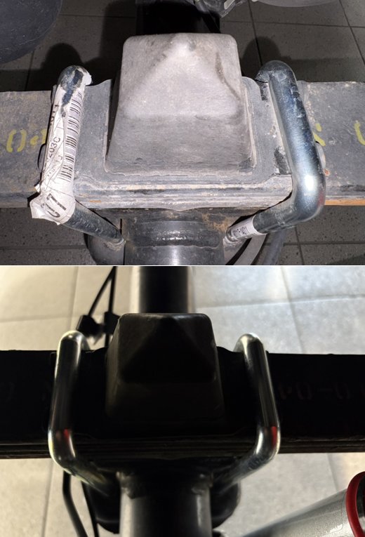

    Took these while at the Dealership while inspecting the U-Bolts.
    My "Undercarriage" looks very clean on my "Street Princess Sporty Spice!" :rofl: :rofl: :rofl:
