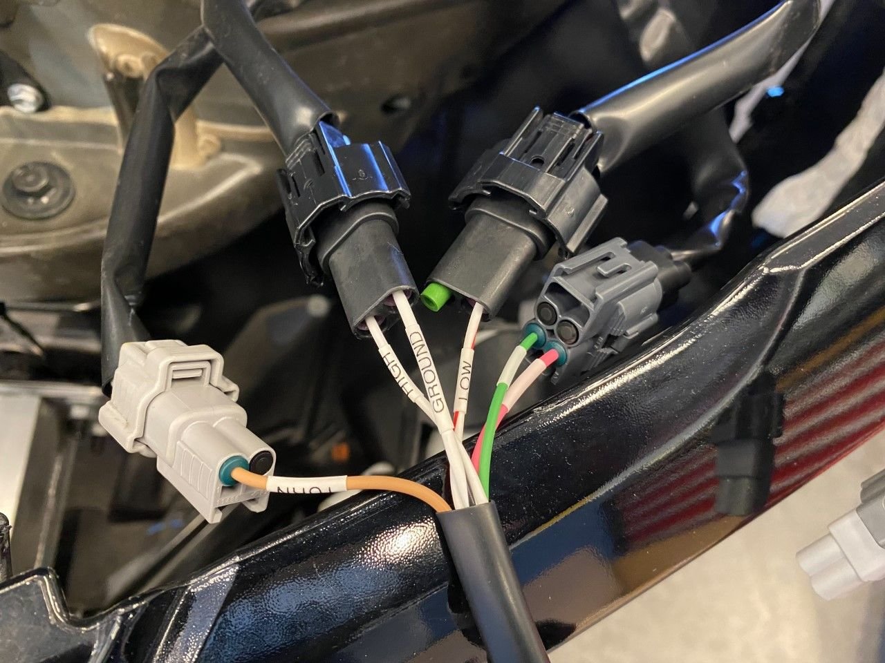

    Harness connection.
    Dave does a wonderful job on his Harness Build.
    Ed

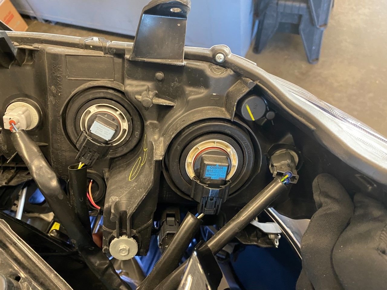

    You don't want to mix up the High & Low beam...this is how I was able to match it up correctly.
    Green to Green. (Low Beam)
    This was driver's side so I looked at the passenger's side halogen to see low beam placement vs high beam.
    Ed
  3. Feb 12, 2022 at 6:17 PM
    #43
    TacoTime55
    TacoTime55 [OP] TT59
    Sep 28, 2021
    #378314
    10,187
    Ed
    Delaware
    2021 Midnight Black TRD Sport AT/DCSB
    TRD Lift,OTT Tune, LED HLs,TRDSkid, TalonCAT
    Here's the reference halogen I'm talking about...

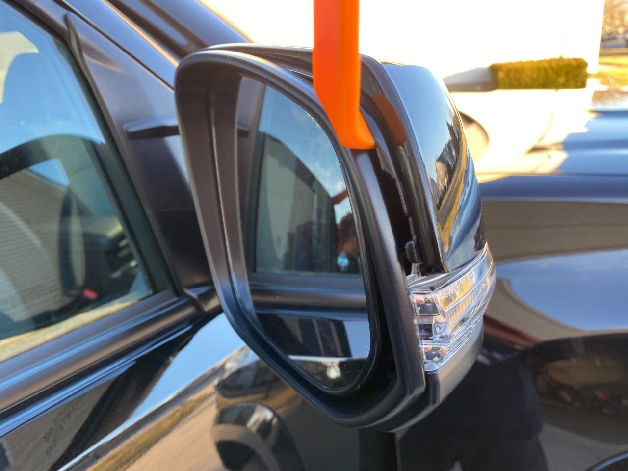

    I installed sequential turn signals to go with my OEM LED headlights...what a PITA messing with plastic!
    You have to be very patient and brave to avoid breaking off tabs. Take your time.
    Ed
  11. Feb 22, 2022 at 7:05 PM
    #51
    TacoTime55
    Sep 28, 2021
    #378314
    10,187
    Ed
    Delaware

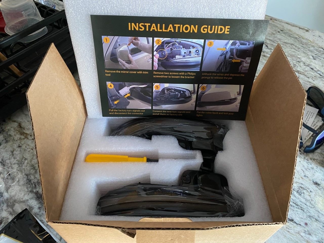

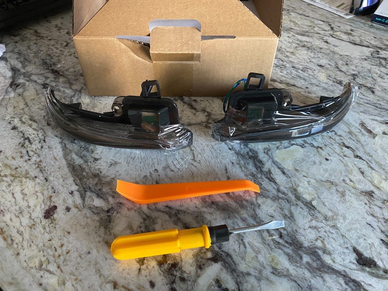

    Photos of sequential turn signals installed. I purchased the High Flying Dynamic Sequentials off Amazon for $45.99. They are currently on sale for $37.71. Feb 22,2022.
    https://www.amazon.com/gp/product/B08C7LT7P9?ie=UTF8
    Based on Chloe's video, it's best to use your fingers and pry around the top to get the cover off. It took some patience for me to be gentle with removing the cover.
    Here are my photos.
    Nicely packaged product.
    I chose the smoked color. They provide a flat head screwdriver but it's a Phillips screw that must come off.
    I tried the plastic pry tool but stopped using it once I saw Chloe's video.
    The tabs on the back stayed in-place without breaking off. Thank God!

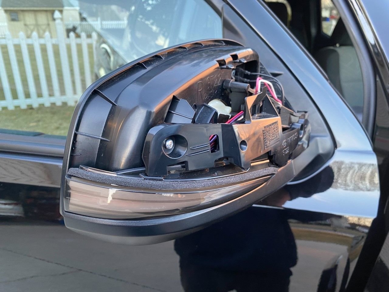

    Here's the original turn signal as found when I took the cover off.

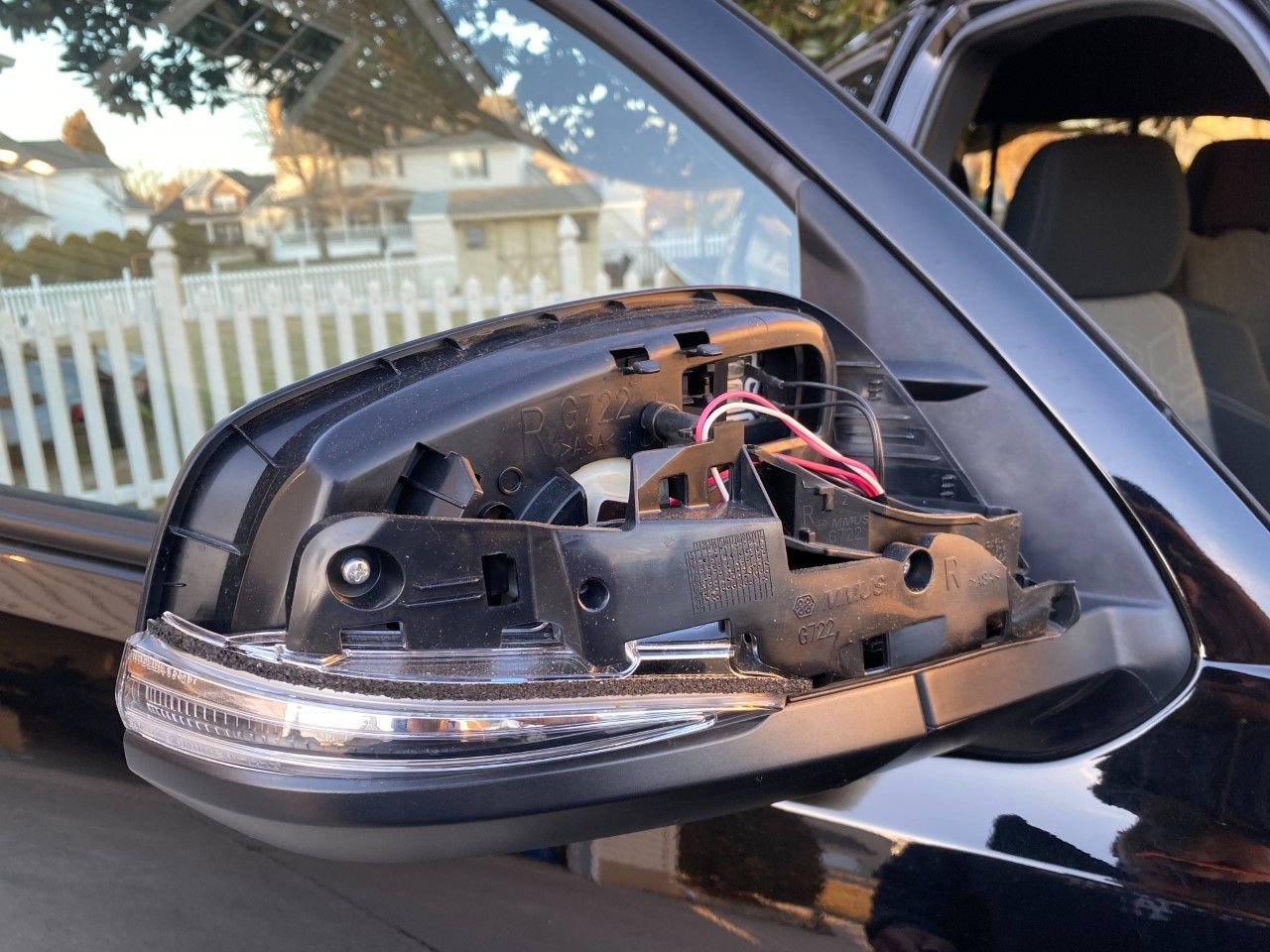

    Then after removing the two screws and taking out the original turn signal, here is the finished install prior to putting cover back on.

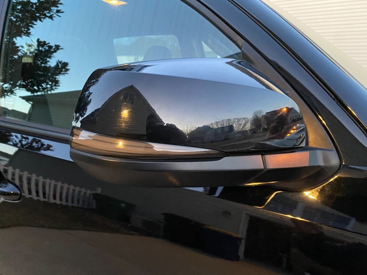

    Completed left side...now onto the other side. I do like these smoked color and they work great!!!
