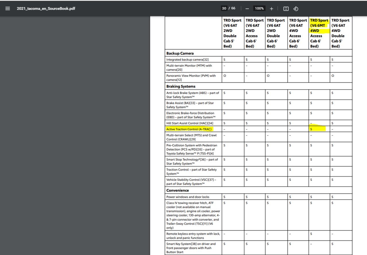

  6. Feb 13, 2021 at 12:28 PM
    RRapidd
    RRapidd New Member
    Feb 13, 2021
    #355994
    3
    1992 Land Cruiser
    OME 2.5" Sport Suspension
    Contrary to the info found in the sticky, it appears that in at least the 2021 model year, TRD Sport 6MT has A-Trac. Build one on the website and it will be listed. I also received this info below from a dealer.
    BigWhiteTRD and disk_55FL like this.
  7. Feb 14, 2021 at 6:13 AM
    BigWhiteTRD
    BigWhiteTRD Official thread killer (only crickets remain)
    May 24, 2017
    #219848
    1,673
    Ted
    Treasure/Space Coast Florida
    2017 AC TRD OR Auto 4wd, 2012 AC SR5 4.0 MT 4wd
    That is what the Toyota site says currently, however I would bet almost any amount of money that it is wrong. (I have seen it wrong before and if we pay attention I am sure it will be wrong again.)
    We have seen over and over in the last 2 years that Toyota is removing actual real functional items (probably to make the truck cheaper), while they are adding the safety sense, etc... (for example the automatic transmission to air cooler is removed, the front diff temp sensor appears to be removed...)
    It is just VERY unlikely that they would put the OR/PRO electric hydraulic brake booster in the Sport, it costs ~$1k more than the normal vacuum booster....
    (there is no guarantee I am right or wrong, just an educated guess)

  8. Feb 14, 2021 at 6:36 AM
    NoVa TRD Sport
    NoVa TRD Sport Well-Known Member
    Nov 10, 2020
    #346369
    988
    Alexander
    Northern Virginia
    2021 Army Green TRD Sport
    Leer cap
    My 2021 Sport Access Cab MT 4x4 does not have the A-TRAC. The chart is wrong. Furthermore, a similar chart I got with my truck shows that it's not supposed to have the A-TRAC. That's reserved for the OR versions.
