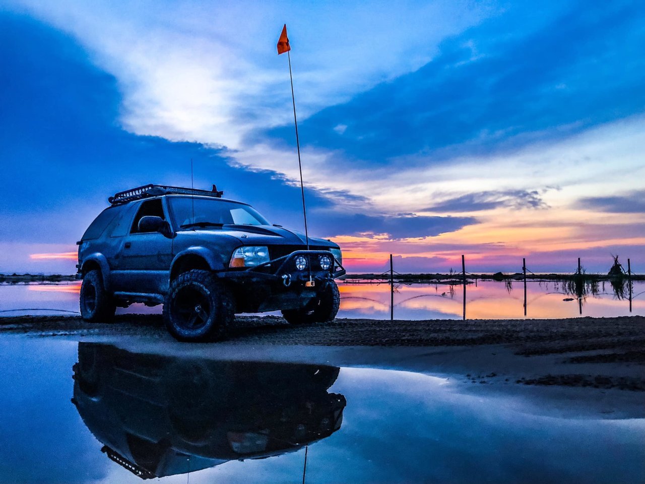

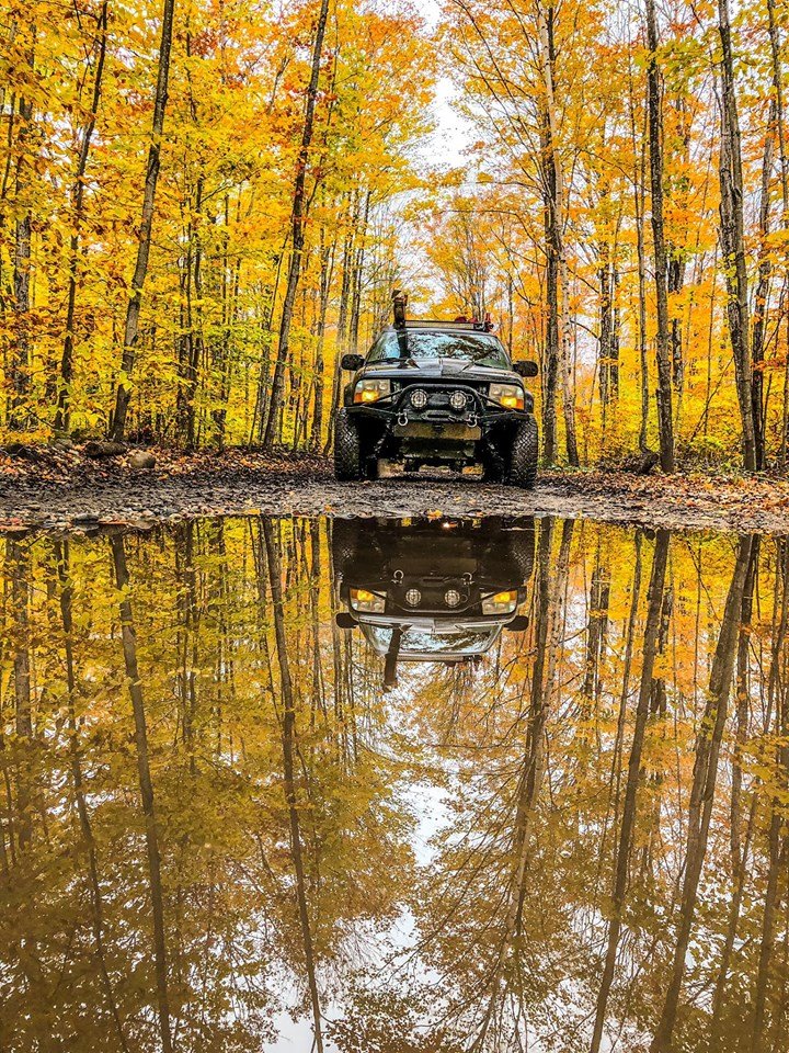

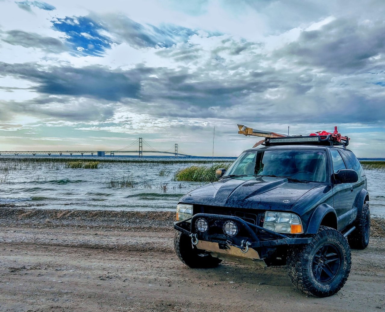

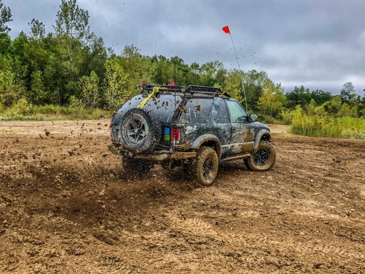

    And some pics of what I'll be upgrading from because pics are always fun to have
    72699530_10112179847130533_3200259666453_50329794a10652c3c92b707b46d27571ddf907b0.jpg
    74471414_10101218243282557_2199014377854_619ddd095fd3c37765762fd5a9a34c11a02b72aa.jpg
    70245265_10101203698440537_4457400708571_c656a7d5fcdb3dbacf71b75585b69300eaf62743.jpg
    67688462_10101172098846377_4439237914647_f36dd33ebe55f7727aec0a9e55bd6b4cf1eecbfa.jpg

    Tacoma SR5 Cavalry Blue
    is that the bridge down in Georgia near Savannah GA I think? Near Tybee?

    Nope, this is the Mackinac bridge between the upper and lower peninsulas of Michigan

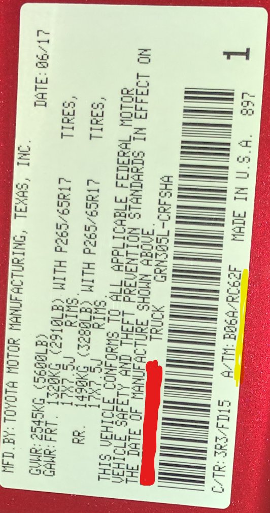

    The Hill Assist is just a line lock on the rear brakes controlled by the ABS module. It only actives over certain angles and only for a couple seconds. It will also hold the Taco if pointing down hill and starting in reverse. Definitely not a must have, but I feel that it saves some wear, so that works for me.
    Again, all 3rd Gen MTs, even the 2016 and 2017 SRs, got the 8.75 rear. Here's my door sticker:
    Here's the axle codes:
  18. Oct 23, 2019 at 11:21 AM
    #18
    Thatbassguy
    Thatbassguy Sweet or sour?
    Mar 17, 2018
    #247525
    10,886
    James
    '19 T4R, TRDORP, KDSS
    RSG sliders, SOS skids, SOS bumper, wheels, tires, etc
    I don't have anything useful to add. But, that second picture with the reflection in the water is awesome!
