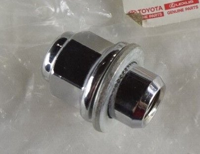

    21mm too small on my 2018. 22mm too big. I bought 2 lug nuts to replace 2 that were bulging from Toyota. Those are 13/16". I don't get it. Thought they be the exact same size.

    Confused, you're saying 21mm is too small and 22mm is too big, but 13/16" fits? 13/16" = 20.637mm

    21mm is the correct size, your lugnuts are just screwed up since toyota did something stupid and started using the stainless caps instead of just solid lug nuts.
    Find some aftermarket solid lug nuts or earlier OEM solid lug nuts (not even sure if they're still available from Toyota).

    Generally speaking, Toyotas made in Japan have single-piece lug nuts while Toyotas made in North America have caps. I don't know why the difference in design.
    90942-01033 - Nut, Lug; Qty: 24
