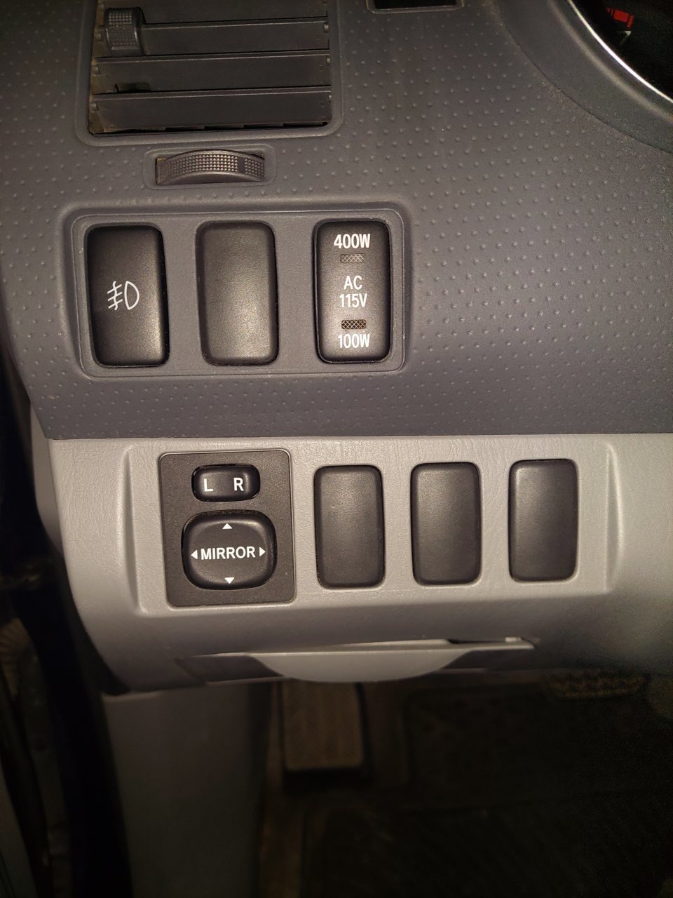

    So on my 06 trd sport, there doesn't seem to be any button where you would normally hav stuff like trc and all, it's empty
    So does it actually hav no sort of thing like that or it does but it's not like you could turn it off?

    Stability/Traction Control didn't become standard until 09, it was only available with select packages prior to that. It's pretty uncommon to see pre-09 trucks with it, if you don't have the Trac off button then your truck doesn't have Traction/Stability Control.

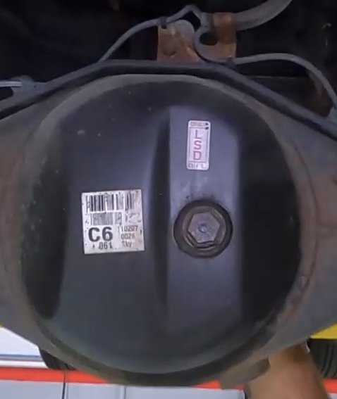

    TRD sport had an LSD, look at the rear end and it'll say use LSD oil only if you have one.

    I believe and correct me if I’m wrong
    Diff Lock is for “TRD Off Road” models
    Auto LSD (breaks LSD) is for a certain model year after 2009(?).
    Mechanical LSD is available for TRD Sport for a certain model range, you have to look at the rear end if it has this sticker.
    Denoting “LSD Oil”
    If you pop the blanks, it has the plugs for it but it doesn’t terminate anywhere on the other end.

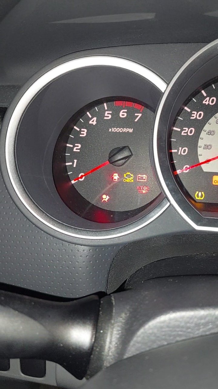

    Ah k, would it come up in my Guage cluster when I start it up, cuz when I put it in "on" position I don't ever see any LSD or TRC type thing, the closest thing ic is the ABS light
    Too what I've noticed as experienced icy Canadian winters, this truck in 2wd skids like crazy all around, it's almost like driving a drift car, no traction what's so ever but with 4wd on it handles like there is no ice or snow at all, as if it is just pavement there. So does this mechanical lsd only work wt 4x4 on?

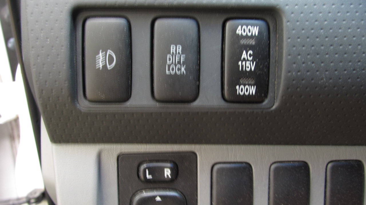

    I'm pretty sure none of that is available on your 06, it isn't on my 07. I do have a locking rear diff. But it can only be locked when in 4lo. If you had a locking diff, you would have the switch on your dash in my pic.

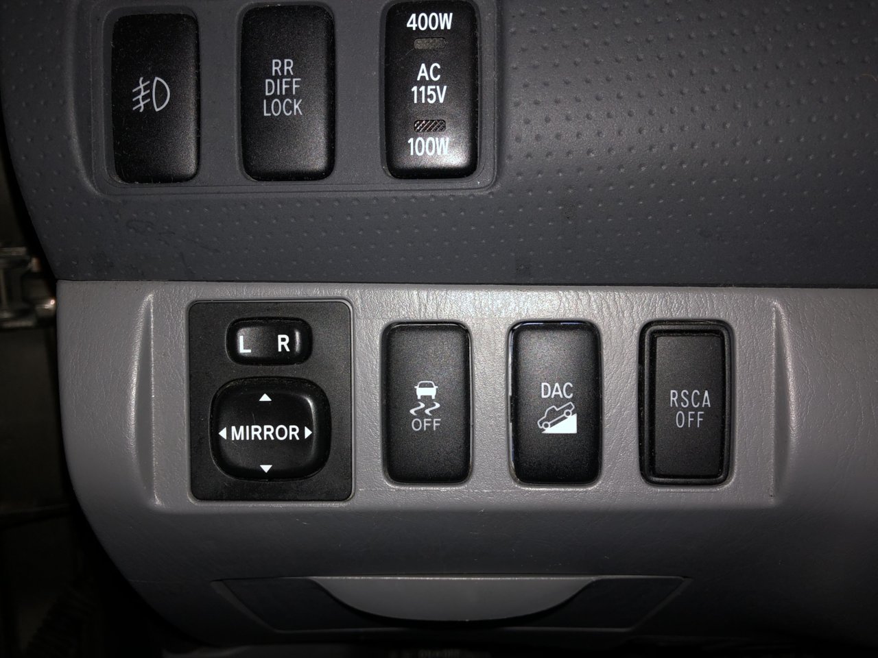

    Mechanical LSD does not have any electrical input to the dash its all in the rear diff. Post #6 shows you an LSD diff tag.
    Traction Control switch is shown in post #2 pic and is normally On - dash light shows when Off - if your Tacoma has it.
    Post #10 shows the TRD Offroad (Not Sports) electrical switch that when in 4Lo only you can activate a motor on the rear diff that locks the 2 axles together and at the same time triggers Trac Control Off (no ABS help) and no engine management (throttle control) all of which light up on the dash. Located on the rear diff - drivers side top front of housing see pic below.
    Owners manual/book explains and the drivers visor should have info on 4wd options.
    Other switches can be the DAC (downhill assist control) and RSCA (side airbags off) so on extreme side tilts they don't fire when offroad but will be in full rollovers still.

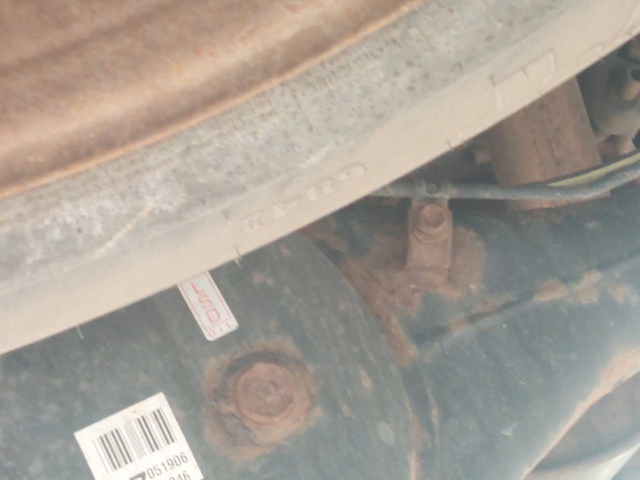

    Yes, had a look at the diff it does
    It's kinda hard to see but you can see the sticker
