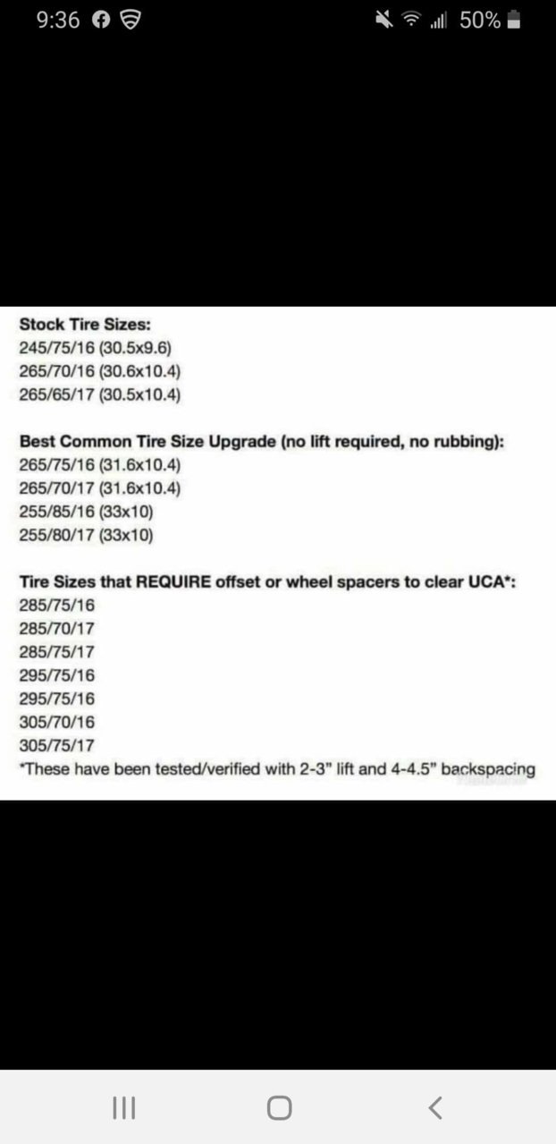

    Ok for tires im thinking 265 70r17 or a 255 80 17 im not lifting my truck
  12. Aug 25, 2020 at 10:38 PM
    Joey778
    Joey778 [OP] Member
    Aug 24, 2020
    #338740
    6
    White trd sport 4x4
    received_275728693488794.jpg It says here you can fit 255 80 17s without a lift and no rub is that true ?
